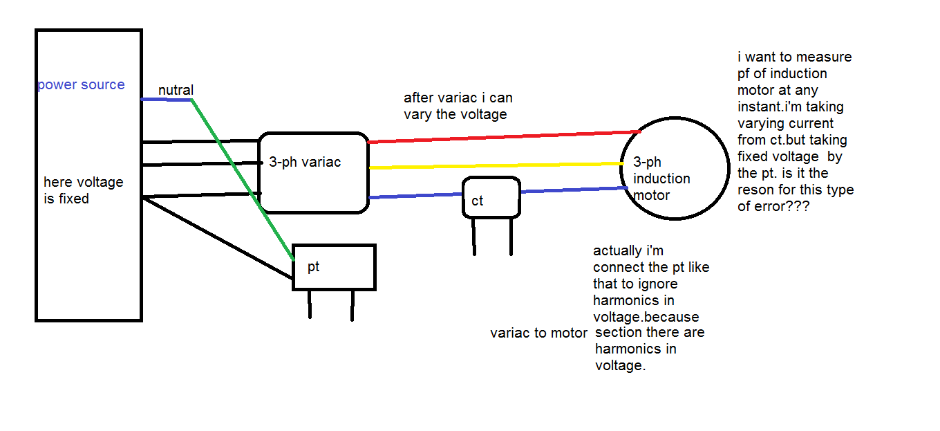

**Author:** ![nabin\_bera](https://community.openenergymonitor.org/letter_avatar_proxy/v4/letter/n/3ec8ea/32.png) [@nabin\_bera](https://community.openenergymonitor.org/u/nabin_bera)\
**Post date:** [3 June 2016 19:37 UTC](https://community.openenergymonitor.org/t/open-energy-monitor/441/30 "2016-06-03T19:37:48Z")
![](https://community.openenergymonitor.org/uploads/default/original/1X/5e7218a18addf7d27f575c4090eac9a6c5a20b61.png)
**and after calibrating arduino gives different different power factor.many times right pf many time wrong pf.is my circuit connection cause of this type of error???**
**Post date:** [3 June 2016 21:15 UTC](https://community.openenergymonitor.org/t/open-energy-monitor/441/31 "2016-06-03T21:15:42Z")
What you have done there is to introduce another phase error into the calculations - the phase error of the variac. What do you think the effect of that will be? Do you know what the phase error is, and is it always the same or does it change, and if so what causes it to change? These are the questions that you should be asking.
More questions that you need to ask yourself: What are you trying to measure there? The power and power factor of the motor with the variac, or the power and power factor of the motor on its own? What you have is neither of these.
I have never measured the phase error of a variac, but I’m quite happy to believe it will not be zero.
If you have a twin-beam oscilloscope available, you can use that to check how much voltage distortion and phase displacement the variac introduces.
