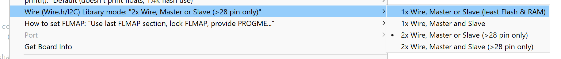

I figured out - I’m fairly certain - the Wire1 issue. Once you’ve picked a board in the tools menu, there’s a “Wire (Wire.h/I2C) Library mode” setting that shows up. The screenshots in the docs ([Firmware — OpenEnergyMonitor 0.0.1 documentation](https://docs.openenergymonitor.org/emonpi2/firmware.html#compile-and-upload-using-arduino-ide)) show it set to 1x Wire, but when it’s set to “2x Wire, Master or Slave (\>28 pin only)” then the compile errors go away. I haven’t traced the code through to see where exactly that happens, but it makes sense, and it works, so I’m calling that one solved.
 ![image](https://community.openenergymonitor.org/uploads/default/original/3X/5/a/5aded7c63bad1bf49fc7595f609c8a0f3890f835.png)
Looks like I’m allowed to post images, so there should be a screenshot above.
While noodling around trying to figure that out, I stumbled across the pre-compiled binaries I’d somehow managed to miss the first few times around, which gave me confidence I could get back where I started even if my binaries wouldn’t work…but they seem to work fine, and I’ve incorporated Trystan’s recent commits too.
This time there’s no holiday - just a weekend with some free time - to blame for me working on this some more. So, absent a holiday, happy eve-of Tom Bawcock’s Eve, which Wikipedia tells me is a more regionally appropriate holiday for your side of the pond:)
I’ve successfully switched around the inputs and confirmed they’re doing what I expect; thanks again for your help!

**Post date:** [22 December 2025 13:03 UTC](https://community.openenergymonitor.org/t/only-emonpi2-ct-inputs-1-and-4-work/27770/12 "2025-12-22T13:03:38Z")
> [@haversian](#):
> it set to 1x Wire
Hmm… That compiles for me, and always has. Maybe something has been corrupted in your source or a library?
But surely, temperatures are handled directly by the RPi, so I can’t see why the Wire library is needed in the front end - or maybe I’ve lost track of where you’re at.

I still have more investigation to do. From a purely software perspective it sort of makes sense that you’d have Wire for a single I2C controller, and Wire1 for a second one. So when you configure the project for a second port you’d get Wire1 too (and the project compiles fine with ‘1x Wire’ if I change the Wire1. invocations to Wire. which further supports that idea).
But the schematics are clear that only one I2C interface is used; there are four sets of potential I2C pins in the AVR: two sets are no-connects, and the third is configured for CT1 and ANALOG\_INPUT (to the analog expander header, which I can’t readily use since I have the PI2 model that doesn’t have room for it in the case). And the code’s clear that it intends for “Wire1” to refer to that one and only I2C interface: it’s the one connected to the OLED:) And also, after it’s used for that, it gets switched into a generic pin input mode:
```arduino
pinMode(PIN_PB2, INPUT);
pinMode(PIN_PB3, INPUT);
with a comment saying it’s releasing the bus for the RPI to use it:
```arduino
// Very simple starting message and then
// control is passed to the Raspberry Pi
and I can see that in the schematics too: the I2C bus that goes to the OLED is shared with the AVR and the RPI connector.
My working hypothesis was that this one I2C bus is the ‘second’ one - thus Wire1, and the apparent need to configure the project for 2x I2C controller mode - but you’re saying it works as-is for you (with #define EMONPI2, right?), so it’s not just an omission in the emon docs. And so apparently I have more work to do to understand what’s up.
