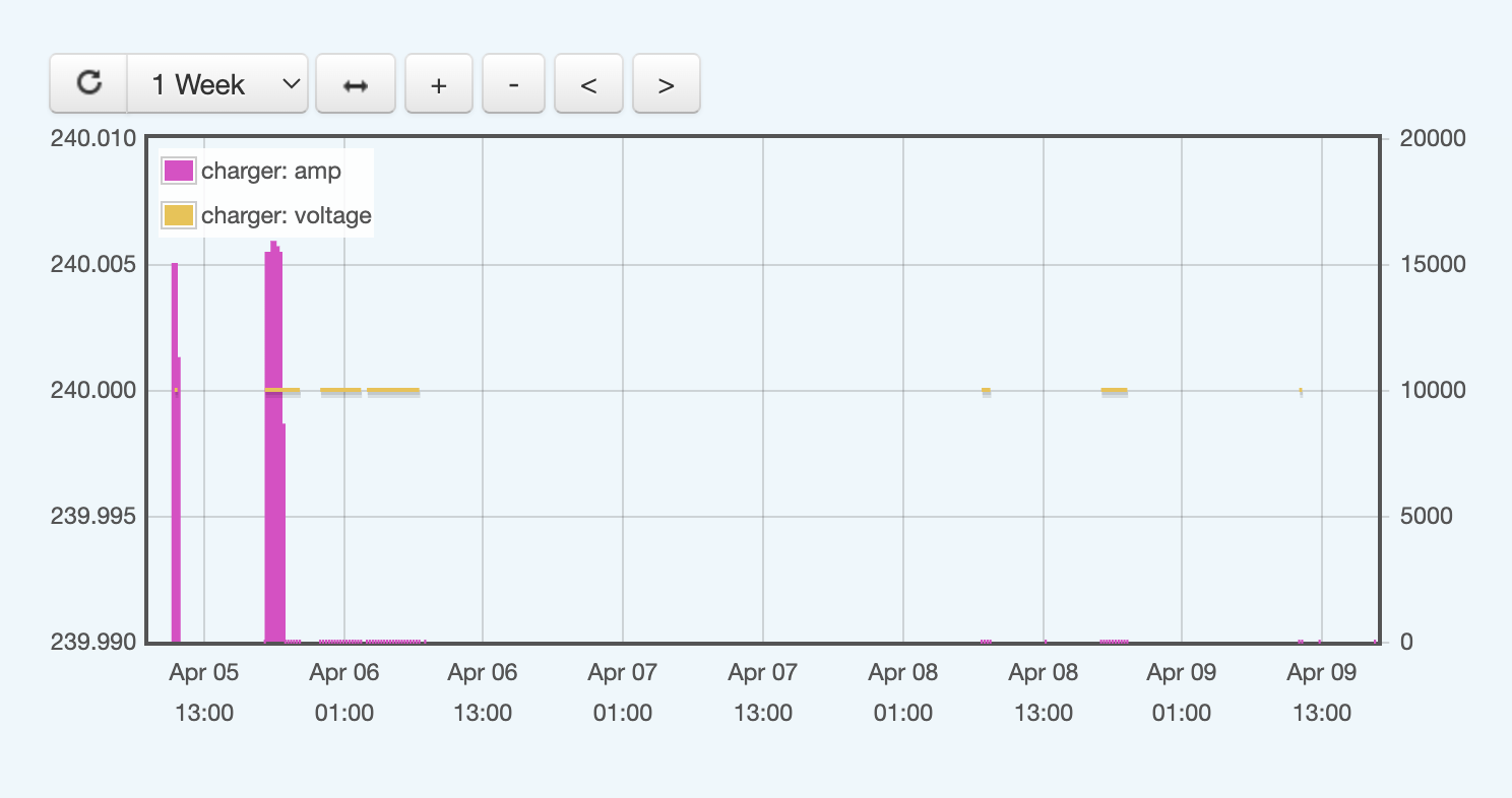

**Author:** ![JayDeeMan](https://community.openenergymonitor.org/user_avatar/community.openenergymonitor.org/jaydeeman/32/21530_2.png) [@JayDeeMan](https://community.openenergymonitor.org/u/JayDeeMan)\
**Post date:** [9 April 2025 14:15 UTC](https://community.openenergymonitor.org/t/no-ground-fault-when-coming-out-of-sleep/24881/3 "2025-04-09T14:15:30Z")
@Cadair do you mind sharing what the exact fault with the circuitry was? Our charger is seeing lots of “no ground” faults too, but the electrician just checked the [Matt:E](https://matt-e.co.uk/) device and said there were no issues. As a result, he advised turning off the ground monitoring, but the charger still powers down for hours at a time. I’ve yet to find a pattern, in terms of time on/off our network.
[edit] amps and volts since monitoring last week looks like [this](https://emoncms.org/dashboard/view/charger-dash&apikey=f6d6ce462138e9eee29e4ec2c5410863)
 ![image](https://community.openenergymonitor.org/uploads/default/original/3X/8/3/8368267aa3adc7be174f49c7f28573bff89e2d02.png)

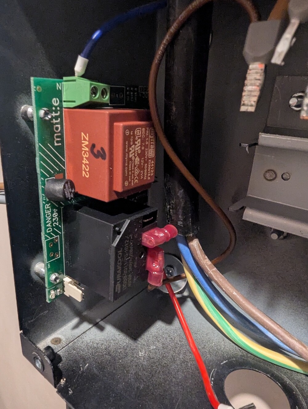

**Author:** ![Cadair](https://community.openenergymonitor.org/user_avatar/community.openenergymonitor.org/cadair/32/4564_2.png) [@Cadair](https://community.openenergymonitor.org/u/Cadair)\
**Post date:** [15 April 2025 08:21 UTC](https://community.openenergymonitor.org/t/no-ground-fault-when-coming-out-of-sleep/24881/4 "2025-04-15T08:21:02Z")
Hi, ours was the Matt:E box (or equivalent) I could hear it clicking when the ground faults happened, replacing it fixed the issues.
**Post date:** [2 May 2025 13:49 UTC](https://community.openenergymonitor.org/t/no-ground-fault-when-coming-out-of-sleep/24881/5 "2025-05-02T13:49:36Z")
So, for info.. this turned out to be the PCB controller in the Matt:e. The original unit (an SP-EVCP-B) is 2-4 years old, and that came with a PCB covering the older standard voltage range.
Apparently the British standard has since changed and the voltage range covered went from 207-253V (230-+ 10%) to have an upper limit of 262V.
Matt:e tech support, who were great, said that some EV chargers have had issues when loads fluctate on local networks, due to the increased numbers of heat pumps and solar panels, hence the BS standard changing.
It was swapped earlier (see image), and the car charged around midday with our solar panels exporting at about 4kW, which would normally mean the charger went off until the loads dropped to below 253V. A £100 fix rather than much more for a new Matt:e or even charger (as the earthing functionality is built in to most chargers now, apparently)
