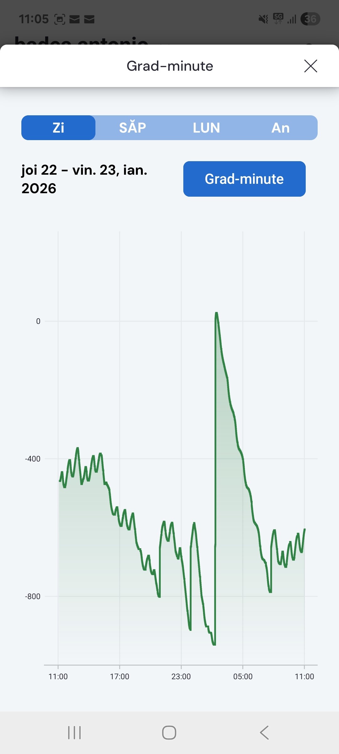

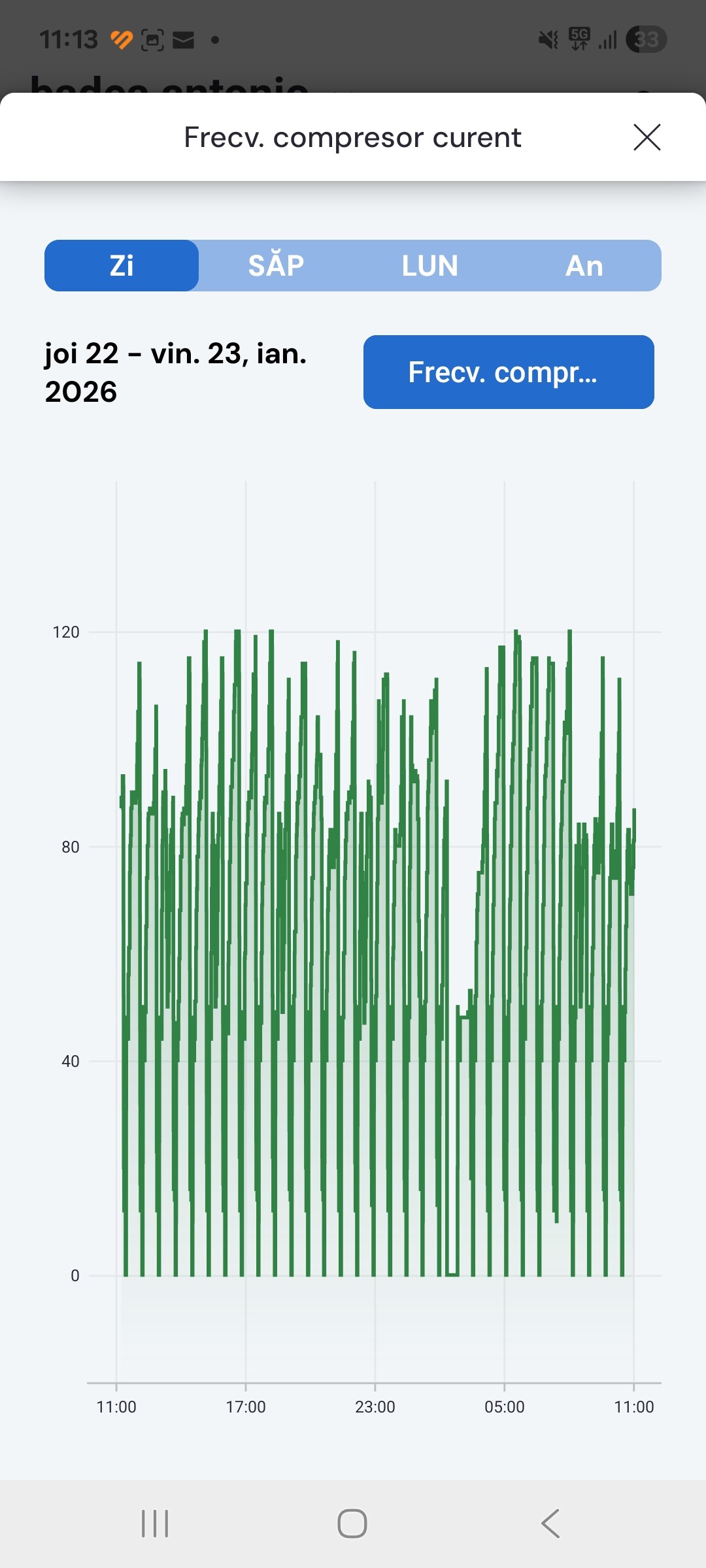

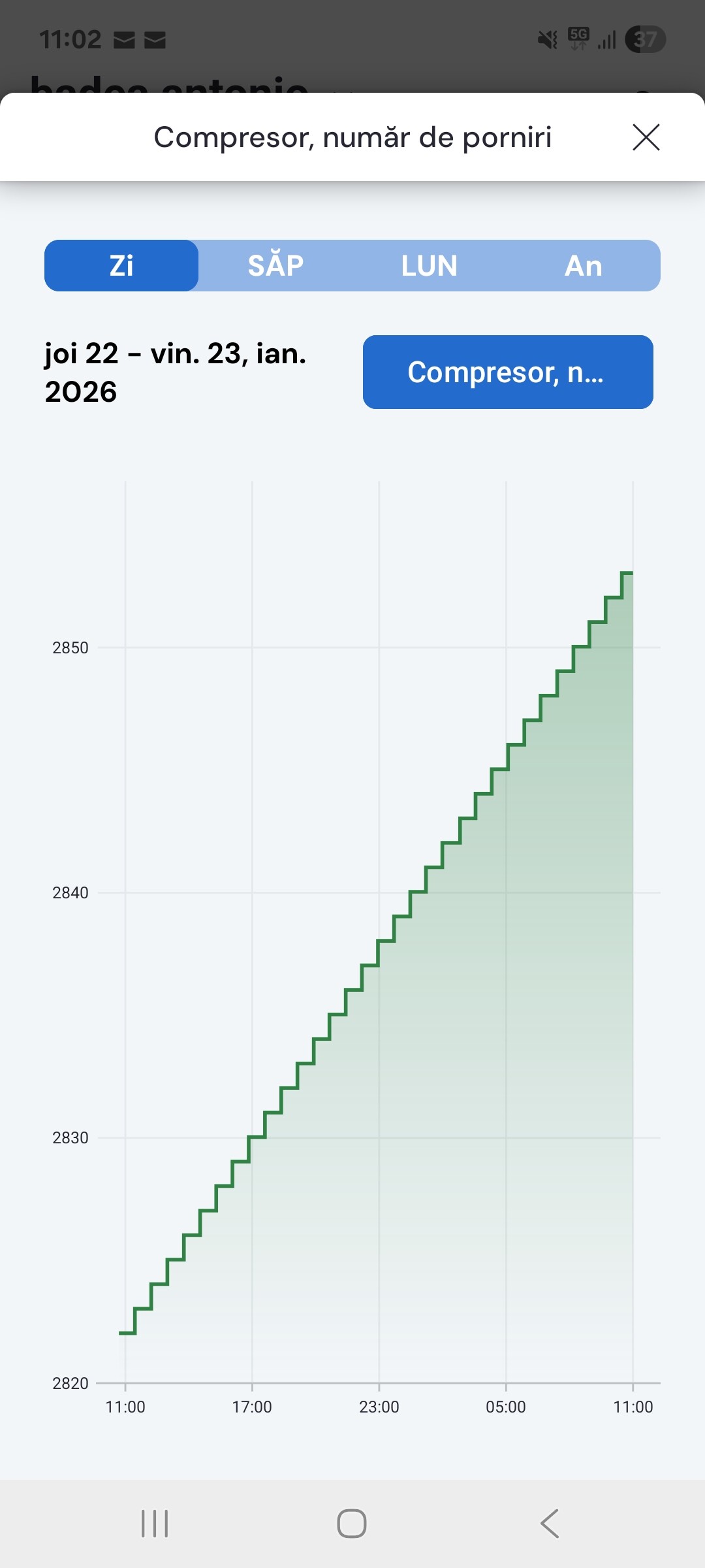

I own a NIBE AMS 20-10 heat pump and an internal module VVM S320. The heat pump serves a house consisting of a basement, ground floor, and first floor. The ground floor and the first floor are equipped only with underfloor heating.
The indoor unit is located in the technical room. The indoor temperatures are not constant, and all graphs show large fluctuations. The compressor starts approximately 33 times per day. The house is well insulated, so that should not be the problem.
I am attaching a few graphs from the last 24 hours. What do you think about these graphs and what could I improve?
