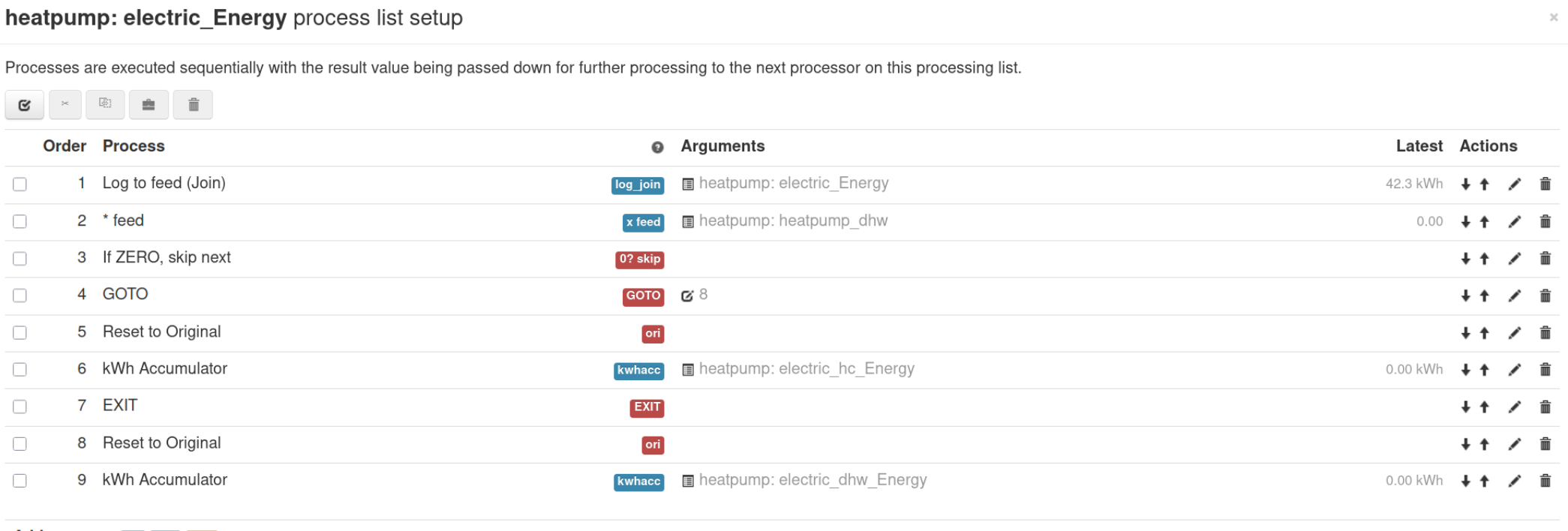

I am new to EmonCMS, fantastic kit, and fantastic software, big thank you for this.
I tried to find an answer but without success.
I have inputs from my heat pump electric\_Power, electric\_Energy and pin15 as hot water diverter status. So the feeds are heatpump\_elec, heatpump\_elec\_kwh and heatpump\_dhw. I’d like to configure a few extra feeds: heatpump\_elec\_dhw, heatpump\_elec\_hc for power on hot water and heating circuit, and also heatpump\_elec\_dhw\_kwh, heatpump\_elec\_hc\_kwh as energy. Power is simple with virtual feed with just multiplication to heatpump\_dhw. But it is not clear for me how to deal with energy (kwh feeds). Anyone can point me into right direction?
Thanks!

For now done it as following, does this look correct?

Hello @ksim
I dont think the above will work Im afraid.
I would use the heat meter heat output power data and then use the DHW flag and power\_to\_kwh to convert to energy. That should give you better results.
Lets say:
- Log to feed heatpump\_heat
- x feed: heatpump\_dhw
- Log to feed: heatpump\_heat\_dhw
- Power to kwh: heatpump\_heat\_dhw\_kwh
- Reset to Original
- x feed: heatpump\_space (? perhaps create an inverse feed)
- Log to feed: heatpump\_heat\_space
- Power to kwh: heatpump\_heat\_space\_kwh

thank you will try
**Author:** ![ksim](https://community.openenergymonitor.org/user_avatar/community.openenergymonitor.org/ksim/32/37602_2.png) [@ksim](https://community.openenergymonitor.org/u/ksim)\
**Post date:** [5 March 2026 08:52 UTC](https://community.openenergymonitor.org/t/new-to-emoncms-how-to-create-feeds-to-count-hot-water-and-heating-kwh-usage/29793/5 "2026-03-05T08:52:43Z")
Worked perfectly, thank you!
