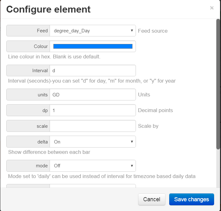

New error on dashboard.
When trying to use a bargraph I get this error
 ![image](https://community.openenergymonitor.org/uploads/default/original/2X/a/afaa7b8dfcd15ccef008089e44e90edc3f8dbb64.png)
If I clik ok I get this:
 ![image](https://community.openenergymonitor.org/uploads/default/original/2X/7/70a0f91d6df473e383ff0e19d900495e8d059d1c.png)
The bargraph in the lower right corner is missing data and the frame…
Any idea??
Henrik
**Author:** ![Boye](https://community.openenergymonitor.org/user_avatar/community.openenergymonitor.org/boye/32/3490_2.png) [@Boye](https://community.openenergymonitor.org/u/Boye)\
**Post date:** [15 October 2019 06:18 UTC](https://community.openenergymonitor.org/t/new-error-on-dashboard-graphs/12175/2 "2019-10-15T06:18:18Z")
I investigated at little bit more.
the feed stareted yesterday at 4:45PM (UNIX timestamp: 1571064300)
My account settings:
 ![image](https://community.openenergymonitor.org/uploads/default/original/2X/3/3566160f9a4fe7d36634fe9ff838ad04b6f0de8b.png)
If have the interval set to “d”
 ![image](https://community.openenergymonitor.org/uploads/default/original/2X/d/dcfc334238e9b40be40d4fe90a5cc9295315ca24.png)
I get the error.
If I change d to:
86400 (24 h =error)
43200 (12 h=error)
39600 (11 h=error)
36000 (10 h= NO error)
32400 (9 h= NO error)
28800 (8 h= NO error)
25200 (7 h= NO error)
21600 (6 h= NO error)

In Graph view
 ![image](https://community.openenergymonitor.org/uploads/default/original/2X/0/0db4d9b0c72ed9a30dbeec2309b1139f98402983.png)
It’s a normal power to kWh feed
 ![image](https://community.openenergymonitor.org/uploads/default/original/2X/b/ba3368aa93a933a8f6e0456326225343a4396d93.png)
**Post date:** [15 October 2019 10:09 UTC](https://community.openenergymonitor.org/t/new-error-on-dashboard-graphs/12175/5 "2019-10-15T10:09:16Z")
Looks like it must be an issue resulting from not having enough data in the feed, e.g smaller time periods are ok as there are at least 10h between the present and the start of the feed. Looks like better error catching is required for this case.
**Post date:** [15 October 2019 10:11 UTC](https://community.openenergymonitor.org/t/new-error-on-dashboard-graphs/12175/6 "2019-10-15T10:11:43Z")
you are saying when I have a full 24 Hour data set the error goes away… That is also my conclusion just thought you wold be interested in error feedback…😀
