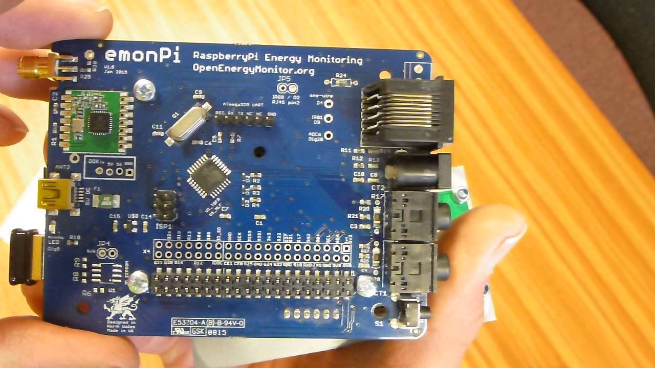

Glyn
Thanks for the info. I may have missed it but how do I get the new card into the pi?
If you are referring to the emonPi, you will need to open up the enclosure and insert the SD card into the RaspberryPi. See this overview video showing the inside of the emonPi:
