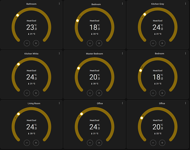

Hi,
So if my understanding of the MMI is correct then at 10c the set point for the flow is 33c.
 ![](https://community.openenergymonitor.org/uploads/default/original/3X/b/3/b35b6c32f2bc7db5064846c4645161e0ecf86431.png)
I have all the TRV’s in the bedrooms set to 20c(18c at night) otherwise they get too hot all the common rooms bathroom, kitchen, dinning room, living room are set 24c and all sit at 21c quite happily.
The reason I set the TRV’s a couple of degrees above where I want the temp is the TRV’s seem to be optimised for GAS CH so start shutting off the valve as they approach the set temp but I have found this does not play well the lower flow from the heat pump.

> [@Rob-G](#):
Indeed, to avoid starving the heat pump of water flow (which also drives up the flow temp if you hit minimum output) you really want to try and set the downstairs TRV’s to the maximum setting (or remove the head entirely) - similar to what you’ve done.
Any differences in heat output/room temperature can be dialled in through balancing (assuming the radiators are generally able to meet the peak heat demand for the room)
> [@Rob-G](#):
It looks that way - assuming you have a heat curve defined? I’ve found going lower than sat 32C or so doesn’t really work that well from an efficiency perspective on my system. YMMV.
Switching to LWT mode and the 4C overshoot may result in some overheating, but you want to then reduce the weather curve (but not too far) - and it should allow balancing to be done if you can get to a steady state.
If rooms are not getting to temperature, ensure the valves (not the TRV as that should already be at max) are fully open.
Any rooms that get hot too quickly or overheat, start closing the valve little by little.
Unfortunately, most valves only start restricting flow rate at a certain point, and then they are very agressive, so you can turn and turn with nothing happening, and then all of a sudden the flow stops…its at that point you’ve found the “authority”, and then its’ trial and error:
room too cold, open slightly.
room too hot, close slightly.

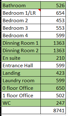

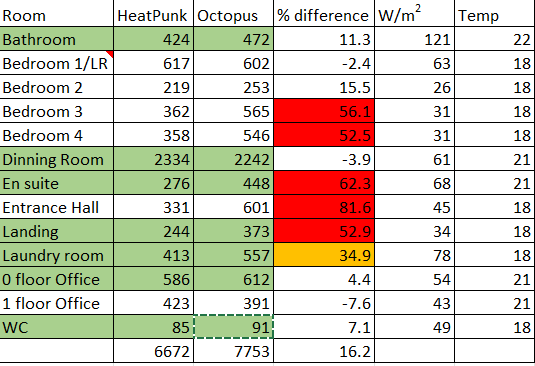

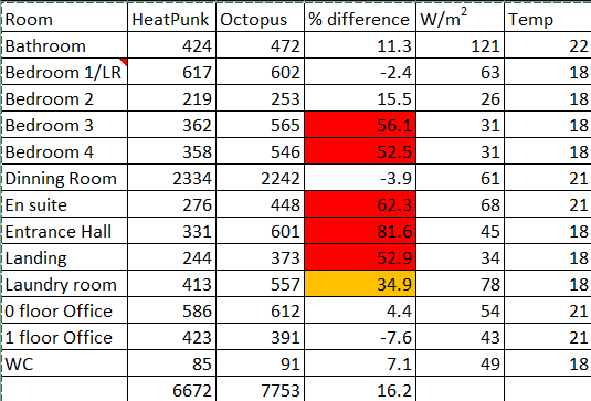

Hi all, thx again for all the info no matter how long I have had this heat pump there seems to be more to learn.
I found a suggestion either in this thread or another to try a website called Heatpunk.
It seems very detailed you can enter the U values for your floors, walls, ceilings, roof etc.
Create a 2d map of your house with windows, doors and radiators.
Having a somewhat complex house with an extension and loft conversion I had to do a lot of digging around on various websites like Celotex for U values and cross-referencing that with my extension plans.
After lots of measuring and data entry, the site came back with a heat loss of 6672W as opposed to Octopus’s 7753W(I’m still not sure why they insisted on installing the 9kW heat pump).
The total area of the building is 129.30 m2, giving an average heat loss of 51 W/m2 at -3°C.
I’m still not 100% happy that these values are accurate as it states the radiators I have installed will not be powerful enough to keep the house at 21deg at a flow of 40 at -3deg but I have run the heat pump at that temp so it’s either overestimating the heat loss or underestimating the output from the rads.
It’s difficult to be sure though as I have the overshoot set to 4 degrees to try and reduce the cycling so my flow is oscillating by 8 degrees which is not great for thermal comfort at times.
I found once the temps increased outside my hallway would warm to 23 degrees and shut the heat pump off for hours and some rooms would drop 4-5 degrees before the heat pump would switch back on. So I have switched the control method to LWT with WD curve set to 40 at -3 and 20 at +18 all of the rooms are sat at a steady comfortable temperature despite the large overshoot setting.
I have put the two sets of heat loss calculations next to each other in the chart below and you start to see the problem.
![image](https://community.openenergymonitor.org/uploads/default/original/3X/a/6/a613ce683219ed7688af1d5e4b26446abeea210b.png)
Due to them overestimating the heat loss in many of these rooms, I paid to replace radiators that were perfectly adequate. The largest difference is a whopping 81.6% in the hallway(where the thermostat is).
Some of these I queried at the time I wish I had stuck to my guns now.
Anyway, with the temperature now back above 6 degrees we are back to constant cycling of the heat pump every 20-30 minutes I have no idea how long it is going to last like that.
I did try getting in touch with Daikin tech support to ask about the minimum power for the 4,6 and 8kW but all they seemed to be able to do was send me the tech specs in the brochure.
I will go back to Octopus with this data and see what they propose.

Hi Robert,
When was your heat pump installed?
Although the percentages on some rooms look big they are not actually large amounts.
Maybe the Madoka location is causing an issue as that area of the house heats up faster than the rest of the house and does not cool down so quickly. Maybe you need to move it or limit the heat delivered to the hallway.
The overshoot is not +/-4c, it is only +4c so you cannot have a flow temperature that fluctuates by 8c because of the overshoot setting.
Even at a heat loss of 6.7kW you are not that far away from the 9kW range.
My heat loss at design is more like 4kW and @KnightPhoenix is similar. The heat loss of my house is actually less than 3kW at design, it is just our conservatory that loses a little over 1kW that they now insist must be heated that caused all the trouble.
I have a heat loss that is much less than yours and I have no cycling at all. Apart from defrosting my 9kW Daikin will run for six hours at a time (the maximum) quite happily.
The minimum input for the smaller Daikin models is around 285w

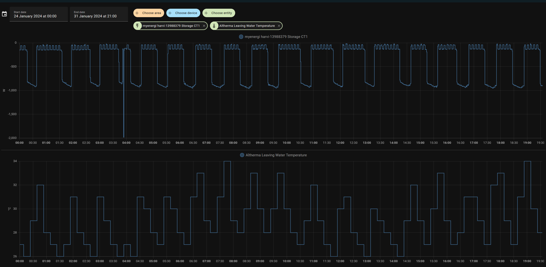

Hi,
Yes, the thermostat location was part of the problem but I have removed that variable by setting the control method to leaving water temp. The heat pump just tries to deliver a constant water temp based on the WD curve.
It’s 9C outside so the LWT is currently set to 28C.
It’s constantly cycling as you can see from the power draw below measured with a CT.

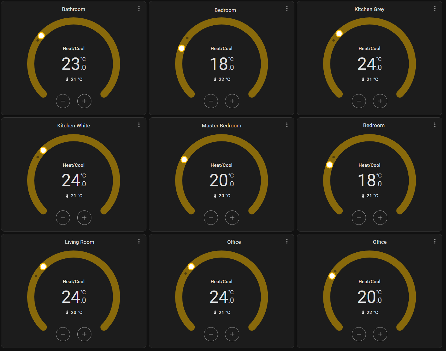

I have smart TRV’s on most the radiators so I can show you the house temps as well. Most of the bedroom TRV’s shut off to stop the rooms from overheating but all the common rooms are set to 24 and are wide open.
 ![image](https://community.openenergymonitor.org/uploads/default/original/3X/9/2/92450a89bab8e988a2998bbc6c3ea752975a260b.png)
Those rooms seem to sit at a constant 20-21 degrees without the TRV’s needing to interfere.

Hi Robert,
If your heat loss is really 6.7kW at -3c and you have to run at 40c flow then you will need the 9kW
Defrosting in those conditions mean your heat pump will barely put out enough to maintain the house temperature.
Do you know how much heat was required in those temperatures we have recently encountered?

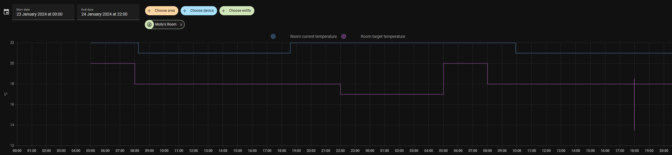

**Author:** ![Rob-G](https://community.openenergymonitor.org/letter_avatar_proxy/v4/letter/r/46a35a/32.png) [@Rob-G](https://community.openenergymonitor.org/u/Rob-G)\
**Post date:** [24 January 2024 20:53 UTC](https://community.openenergymonitor.org/t/my-heat-pump-is-too-big-what-should-i-do/24706/218 "2024-01-24T20:53:50Z")
I have to use the TRV’s on the bedrooms otherwise they overheat.
Here is the data from the radiator in my daughters room.
 ![image](https://community.openenergymonitor.org/uploads/default/original/3X/d/7/d726e86e5b47c36b96a98580d7f11942ac8f0377.png)
The TRV is programmed to 18 during the day, 17 overnight, 20 in the morning(Purple line).
The blue line above is the temperature that never drops below 21.
Her bedroom door is always closed yet stays at a comfortable temperature.
The TRV’s only impact the bedrooms the rest of the TRV’s are set to 24 and never shut off I could completely remove them and it would make no difference.
I have about 5kW of radiators permanently open to allow flow around the system.
I have been monitoring the flow and return with a heat meter with K clamps and the dT is currently 5deg.
Flow rate is normally about 10l a minute when it’s running.
**Post date:** [24 January 2024 21:34 UTC](https://community.openenergymonitor.org/t/my-heat-pump-is-too-big-what-should-i-do/24706/220 "2024-01-24T21:34:44Z")
Hi, so in the spreadsheet below are all the radiators.
The ones in green have either a standard TRV set to 5 or a smart TRV set to 24(The rooms only get to about 21 so the smart TRV’s stay 100% open.
In theory, I could remove them all to make sure they are not interfering in any way.
![image](https://community.openenergymonitor.org/uploads/default/original/3X/a/f/af5650c4d9e74087a8829370481afcac08116d9c.png)
EDIT: The wrong table above here is the correct one.
![image](https://community.openenergymonitor.org/uploads/default/original/3X/b/2/b2b1745b7d1aa3ba14d9d63a063e4582da986204.png)
EDIT: The second table has the value from the Octopus radiator schedule all the green ones have TRV’s set to max to only close to prevent over-temp.

**Author:** ![matt-drummer](https://community.openenergymonitor.org/letter_avatar_proxy/v4/letter/m/e0b2c6/32.png) [@matt-drummer](https://community.openenergymonitor.org/u/matt-drummer)\
**Post date:** [24 January 2024 21:53 UTC](https://community.openenergymonitor.org/t/my-heat-pump-is-too-big-what-should-i-do/24706/221 "2024-01-24T21:53:10Z")
I am sorry Robert, I can’t see radiator outputs, that is the same table with room heat losses.
If the radiator outputs are similar to the room heat losses then that is only 4,795w of radiators.
And if that is from an Octopus design at 50c flow then at 40c lwt they can only put out about 2.1kW of heat if your rooms are 21c and the mean flow temperature is about 37c.
It is about 50% of the heat output from the heat pump.
It is why it will short cycle when it is warmer outside and the heat loss of your house is much lower. If some or all of the other radiators shut off then there is nowhere for the heat to go and the returning water temperature will increase until the heat pump stops.
I think there are some other brands do this too, but having the smallest Daikin in the 9 to 16kW range comes with the narrowest operating window in terms of heat output, around 4kW to 9kW.
It has the same compressor and circulation pump as the `larger’ models and is basically software limited at the upper end.
All four in the range operate at the same lowest level.
In a smaller house this is more of an issue, in fact it is a massive pain.
I know this only too well, opening windows is more efficient than letting the heat pump short cycle.
Or, just get used to being warmer.
Or replace the bedroom radiators with smaller ones, not really advisable.
Or replace the other radiators with bigger ones so that the heat in the house is more balanced and you can run lower flow temperatures, what I did.
Maybe it is possible to limit the heat output of some radiators using the lock shield valve.
But persisting with trvs will just reduce your radiator output and cause the heat pump to cycle more often.
I hate to be the bearer of doom and gloom but that is how it is, it is my experience and many others go through the same.
Maybe somebody else has other ideas to make it work better with small radiators and trvs but I don’t and have yet to encounter anybody that does.
