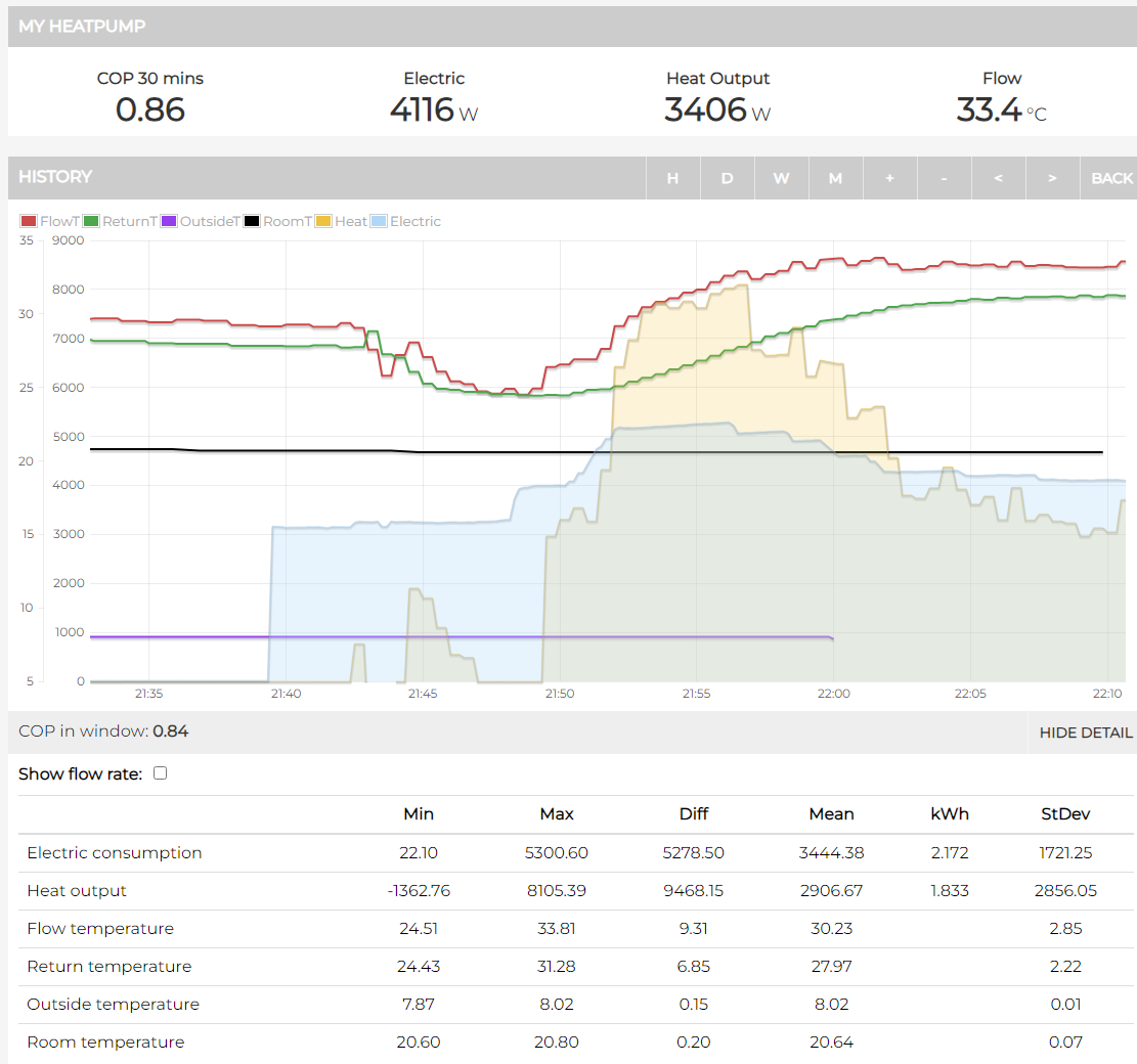

What’s wrong with it?
Here are my non-expert observations / guesses:
21:39 - 3 kW of electricity being drawn, yet there’s no flow and temperatures don’t budge. My guess is that this is the immersion heater in the cylinder.
21:42 - primary pump starts, and temperatures change. The flow falters a bit, but carries on. Residual heat in the pipes gets measured as “produced heat” yet heat pump is not running yet.
21:48 - electricity rises to 4 kW; this is when heat pump actually starts the compressor. Renewable heat appears shortly after.
22:14 - electricity drops back down to normal as immersion turns off again after 35 minutes. That’s 1.75 kW of electricity that can be subtracted from stats, resulting in actual COP of 3.25.
23.31 - heat pump reaches 38 C and stops.

It’s a problem I think and it’s done it again this morning
I just checked as back up heater and immersion have their own meters (all shown on myheatpump app), there has been no use of either.
That electricity use is all heat pump!
And the use is real as I can see it on my solar/battery inverter data.
We can see that there is something connected to that circuit drawing 3kW constantly for 35 minutes. Subtract that, and the profile of the heat pump is normal.
There should be 3kW of heat appearing somewhere, but it’s not going into space heating.
Can you chart your tank temperatures?

My tank is at 47c and is on reheat to 50c with a hysteresis of 20c
You can look at it on heatpumpmonitor.org, it the Ipswich heat pump.
All that I changed yesterday was the DHW from schedule to reheat only and I dropped my offset from my WD curve from +10c to zero.

I have found out what it is.
I am sorry everybody, I selected the wrong feed for my graph, I chose electric energy rather than electric power.
It is the immersion heater.
It is using that to reheat the tank rather than the heat pump.
All I did was change from schedule DHW to reheat only.
The tank is now 50c so I’ll turn it off and sort it when I get home.
