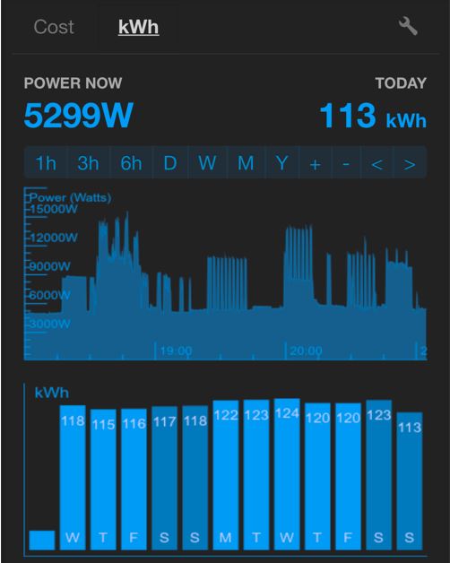

My Electricity 2 App showing three dashes on today’s total at top right of screen
My Electricity App shows 113 kWh but My Electricity 2 App shows three bars at the top right corner from about 7PM to 12AM and then starts working with the new days totals.
If any more information is needed please see my last post or let me know what you might need.
You’re in North America, I believe? Are you 5 hours adrift of UTC?
Have you got the right timezone setting EVERYWHERE (e.g. both in your server/Raspberry Pi and in emonCMS)?

EmonCMS works on UTC, but it requires to know your offset so that it knows when “Today” started for you, which is a few hours after it did for me, and so that it can make the necessary conversions.
If that isn’t the problem, you need somebody who knows emonCMS better than I do.
Thanks for your reply. EmonCMS.org and my IoTaWatt are both set at -05:00.

Hello @terrye could you try it again now?
It was still acting the same last night. I will try it tonight.

Also here in Rome Italy the counter is - - -

For me it’s always - - -
time zone set correct on emonpi and emoncms to Rome.
Emonpi 11.0.7 master and image 07/2020
Hello @lord_valex you may need to update the app module specifically via the admin components tab
Thx solved :wink:

I have updated the app module and still have 3 dashes after 8PM CDT and right at 98kWh total for the day. I hope you can tell me how to fix this.
I still have the same problem. Can anyone tell me how to fix it.
Hello @terrye is this working fine for you on emoncms.org but not locally?
They both quit at the same time
