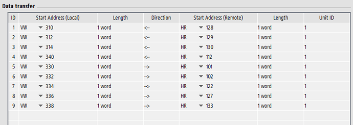

Not sure if this is the correct forum but I am trying to get a Samsung MIM-B19N (Nasa to Modbus bridge) running. The bridge is connected to a Modbus RTU-to-TCP Gateway and the PLC is approaching the Modbus TCP gateway.
I have communication and as well in a separate Modbus RTU program, as well as with my PLC.
Problem with the PLC is that it somehow only seems to be able to either only read holding registers or only write holding registers. If writing works, all read-only holding registers show up as 0 on the PLC. If reading works, the heat pump does not respond to writing registers.
All the time it is possible to read correct values using a separate modbus TCP app even when the PLC shows 0 values. Other way around; if the PLC is reading correct but not writing I am able to write using that same app.
Shutting down the app to eliminate the possibility of the app interfering with the PLC showed no change in behavior.
Refreshing interval is at 1s on the PLC. Siemens has their PLC programmed in such a way that at each refresh interval all holding registers are re-read and all to-be-written holding registers are written. Regardless if their values have changed or not, every second the whole set is written.
Does anyone have any experience how to troubleshoot this?

On the MIM-B19N I even experimented with all the read-only registers in 1 connection and all write registers in the other…without satisfactory result.
What is the gap between modbus reads from the PLC? I had trouble when the inter-request gap was 10ms, upping the gap to 50ms seems to have been stable. The write requests have to wait for bus quiet times on the NASA side before they can be sent, they only occur every few seconds, so chances are you have filled up the Tx Q in the B19M and it has thrown a wobbly.
Personally, I would reduce it to reading one holding register, then writing one holding register. If that works up it to 2 until you find where it is breaking.

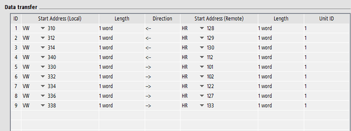

I remembered that the current Intesis Modbus gateway I want to replace with the MIM-B19N has a log function for the Modbus data. Below is a snapshot of that data. Not sure if it accurately resembles timing of each read request in a “burst of reads” but at least it’s better than nothing.
Config on the PLC side for this connection:
Log on the Intesis side for 1 single burst:

‘scope job, so no way without relatively (300GBP) expensive equipment. So all I can suggest is you reduce it to a single read and write, if that works and the bursts don’t then it probably is a timing issue. You could try reducing the baud rate to the lowest possible as that will artificially throttle the throughput.
It looks like all that comms is happening in the same millisecond, so the PLC is really hammering the Modbus, the Intesis can take it, the B19 can’t. Does the PLC have a setting to control the minimum inter message gap? I would be surprised if it didn’t.

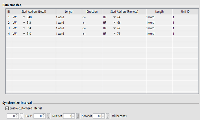

It was quite a day of trying (and not-so-fast-thinking due to recovery from the flue) but I think I solved the issue. The trick is:
I made 3 separate Modbus connections:
Connection 1: Read a whole bunch of holding registers (about 60 even though I only need 4 or so at the moment) every 1.00 second
Connection 2: Write 1 set of 2 holding registers every 1.01 seconds
Connection 3: Write 1 set of 1 holding register every 1.02 seconds
This way I barely ever have an overlap and if I do it only happens for 1s. So far it seems that the system is slow enough to not cause an undesired stop of the heat pump.
