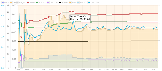

**Post date:** [15 January 2026 13:29 UTC](https://community.openenergymonitor.org/t/mitsu-zubadan-flow-temperature-issue/29576/89 "2026-01-15T13:29:31Z")

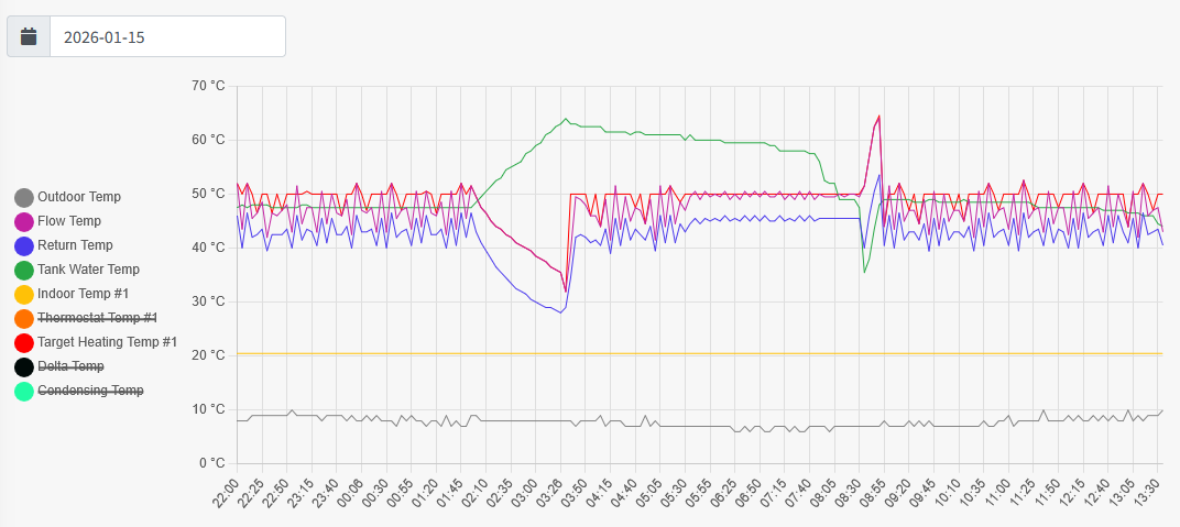

I had a play with the speed of the secondary pump on my system, increasing it from ‘I’ to ‘II’ at 10am when the system was close to stable running. Can see how the return temperature jumped up by 1°, pushing up the flow temp. Average COP dropped from 3.6 to 3.3.
 ![Screenshot from 2026-01-15 10-53-17](https://community.openenergymonitor.org/uploads/default/original/3X/1/9/193318f69152101e49fa50fed82bb86a8d9ea386.png)
Seems like I was better off at the slower speed, so I dropped it back down again at 10:20 (a defrost happened shortly after). Can just about see that return did drop back down to 34° at the end.
At 12pm, I increased the primary pump from 9 l/min to 11 l/min, and the dT narrowed by about 1° as one would expect. COP dropped by maybe 0.1.
 ![image](https://community.openenergymonitor.org/uploads/default/original/3X/0/7/07a5e926c6c4565c2ac556f915be688f8387a91b.png)
Then reset the pump speed back to what it was at about 12:45, dT widened by 1°.
**Caveat:** not necessarily a good experiment and conclusions may be wrong.

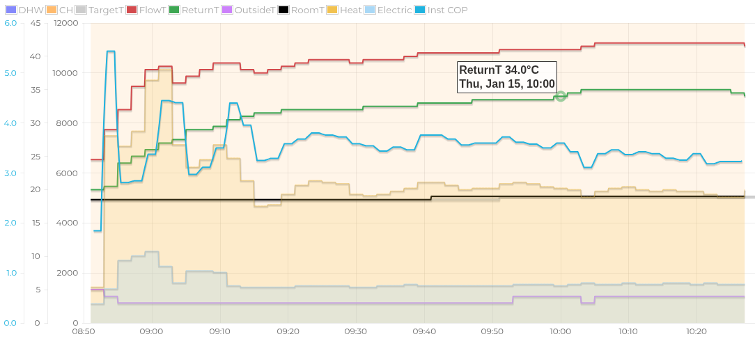

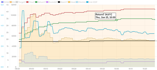

**Author:** ![bontwoody](https://community.openenergymonitor.org/user_avatar/community.openenergymonitor.org/bontwoody/32/23897_2.png) [@bontwoody](https://community.openenergymonitor.org/u/bontwoody)\
**Post date:** [15 January 2026 13:41 UTC](https://community.openenergymonitor.org/t/mitsu-zubadan-flow-temperature-issue/29576/90 "2026-01-15T13:41:57Z")

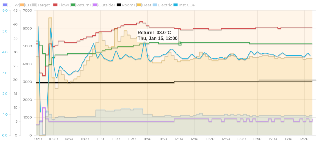

So small changes then and not in the right direction. Temperature probes arrived and all are within 0.2C of each other so should be useful.
The secondary pump on site was changed from 1 to 2 at about 12 noon. Flow temperatures still not stabillising
 ![image](https://community.openenergymonitor.org/uploads/default/original/3X/a/e/ae7d462a403f935324f8fd1bc7c6742e577d04c2.png)

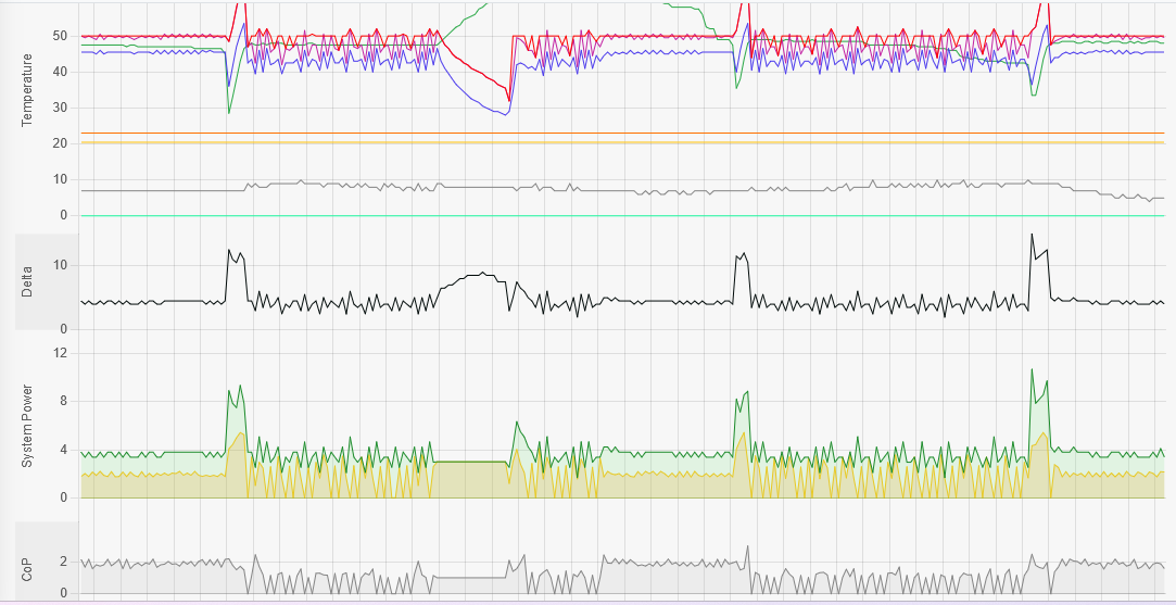

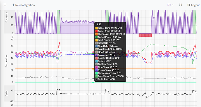

This afternoon I was able to get someone to change the secondary pump speed from I to !! at about 12noon. It didnt seem to make any difference and the system remained unstable.
Later in the afternoon it was changed again to speed III. The unit did settle then after a DHW run.
 ![{037649E2-5E00-4646-9F1F-CCA6B7CE05A2}](https://community.openenergymonitor.org/uploads/default/original/3X/3/7/375593d55e3edf6a882c1cb13a213c89ee539d02.png)
Hard to say if anything improved though. Or am I imagining that the OAT has dropped but the COP is about the same as earlier when it was warmer outside???

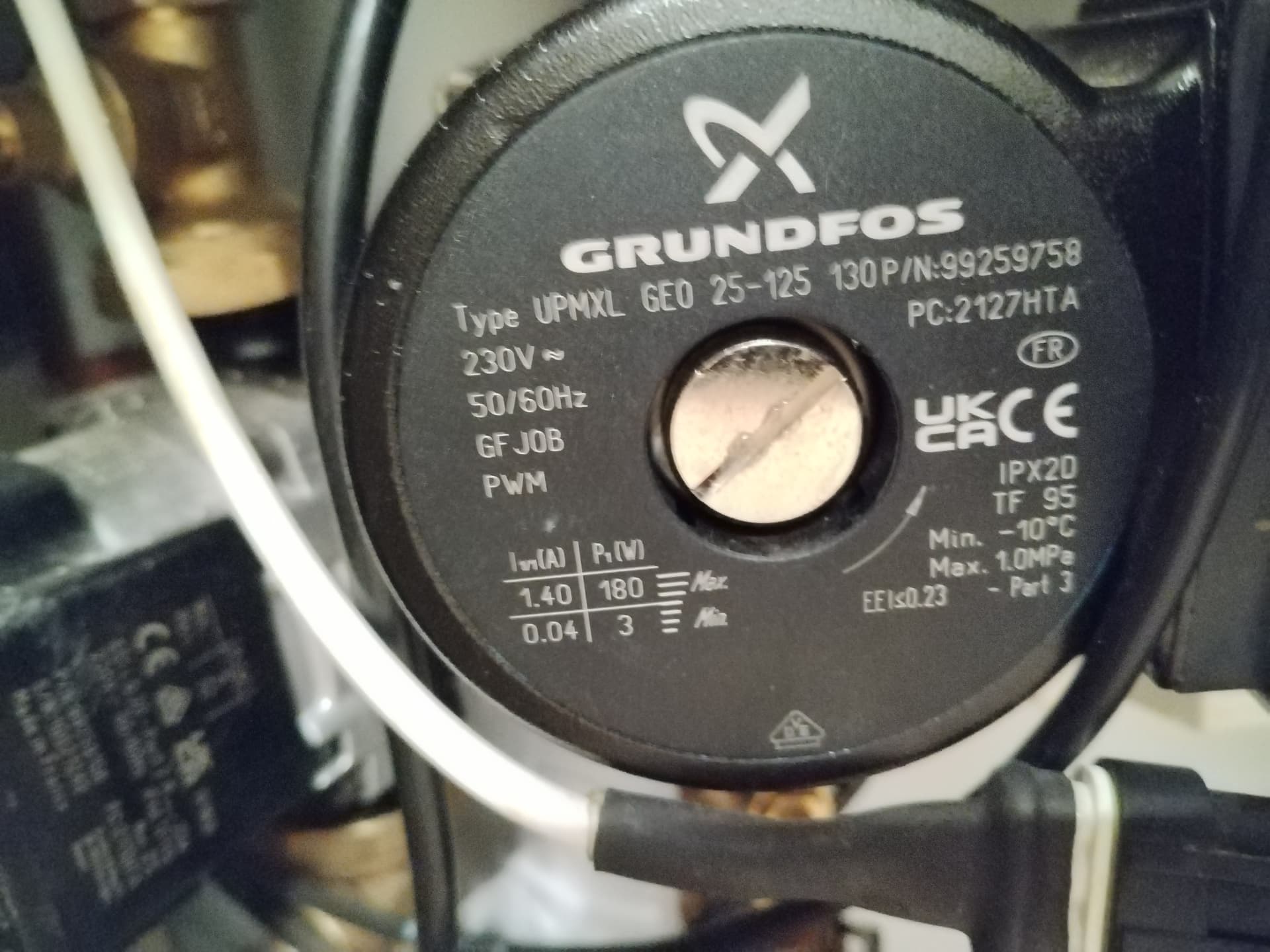

**Primary:** UPMXL GEO 25-125 130 - PWM speed set to 3 out of 5
**Secondary:** UPM3 AUTO 25-70 130 ZZZ - constant pressure, curve ‘I’
 ![IMG_20260113_180056](https://community.openenergymonitor.org/uploads/default/original/3X/b/a/bae07761487a524a5d26f382acf522bb9a724d35.jpeg) ![IMG_20260113_180047](https://community.openenergymonitor.org/uploads/default/original/3X/9/0/9027f420a36a1e6fc674cbd8233686b1b29fe37f.jpeg)

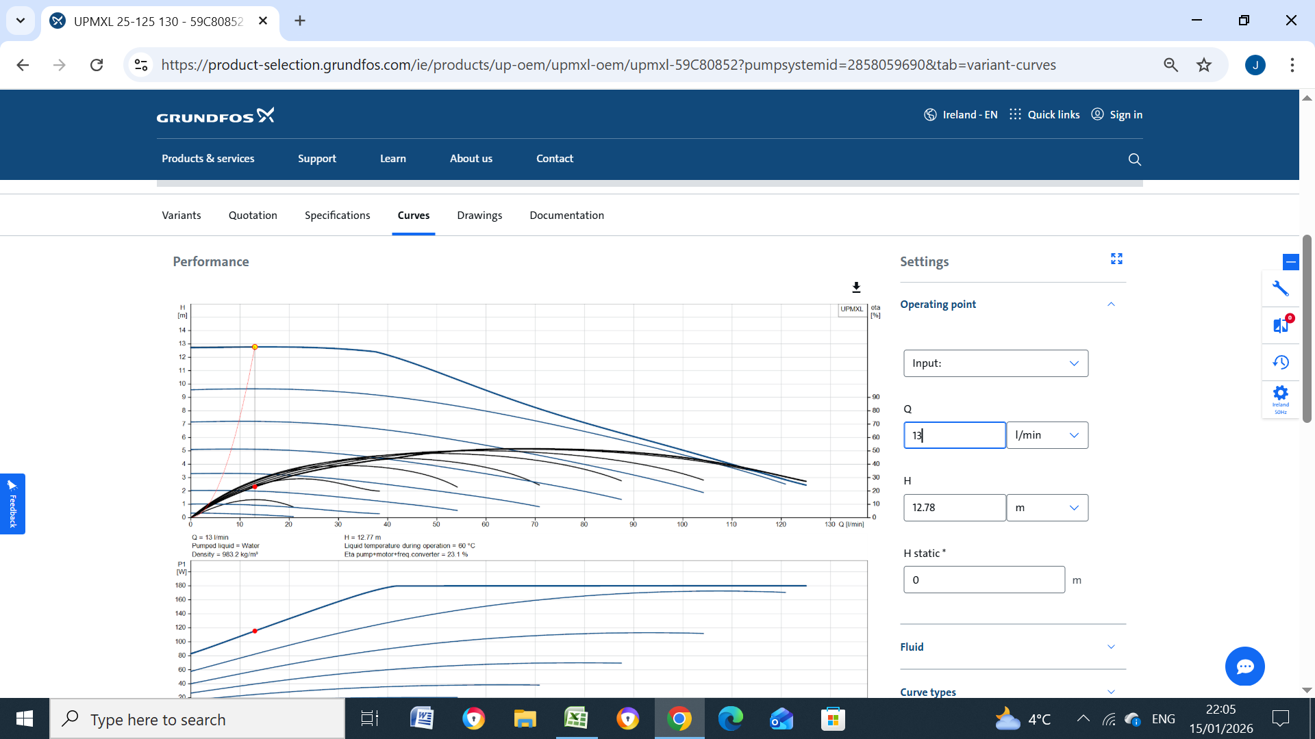

13LPM at 11.5kW output gives a dT of 12.68C, don’t know what effect this would have on the COP. The primary pump is truly massive, with a 12.5M head and a power output of 180W, yet the secondary is “only” a 7M pump, wonder why, must look up the pump curves.
Looks like, (if running at full speed) that a head of 12.78M is required to circulate 13LPM through the primary system, seems extraordinary.

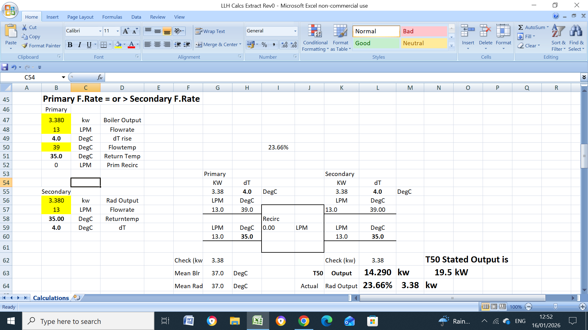

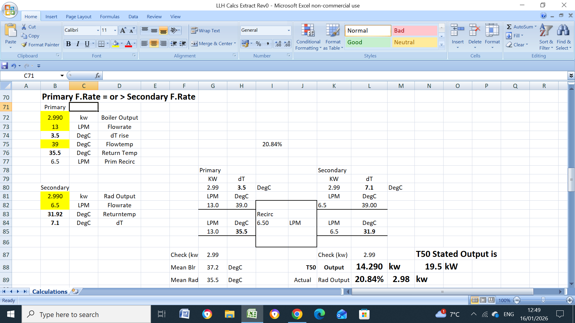

Hopefully I will be on site today and fit the 4 probes to outlets of the LLH. Here is the data from yesterday.
 ![{6AC22412-F2C0-47E2-B0CC-F7B0ADB26AE4}](https://community.openenergymonitor.org/uploads/default/original/3X/b/b/bb6358451bb06d3658002a496a4f5866d294bebe.png)

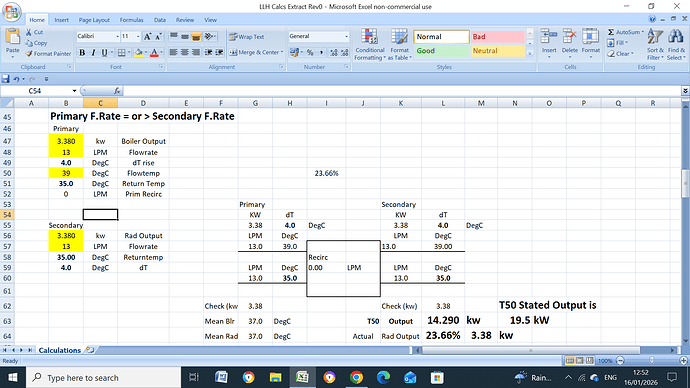

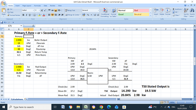

**Author:** ![Johntheo](https://community.openenergymonitor.org/letter_avatar_proxy/v4/letter/j/34f0e0/32.png) [@Johntheo](https://community.openenergymonitor.org/u/Johntheo)\
**Post date:** [16 January 2026 11:20 UTC](https://community.openenergymonitor.org/t/mitsu-zubadan-flow-temperature-issue/29576/100 "2026-01-16T11:20:48Z")
Will be interesting to see.
Here’s the calcs based on your data above (and corrected for glycol)
First one below shows results if both primary&secondary flowrates are the same
Bottom one shows results if the secondary flowrate was only 1/2 the primary flowrate.
 ![image](https://community.openenergymonitor.org/uploads/default/original/3X/e/1/e10e3f80ab02bdb8d6d57a3d992a4526b9e32513.png)
 ![image](https://community.openenergymonitor.org/uploads/default/original/3X/7/3/73b81b8c6d3d504652299758965a04f513b02c6a.png)
