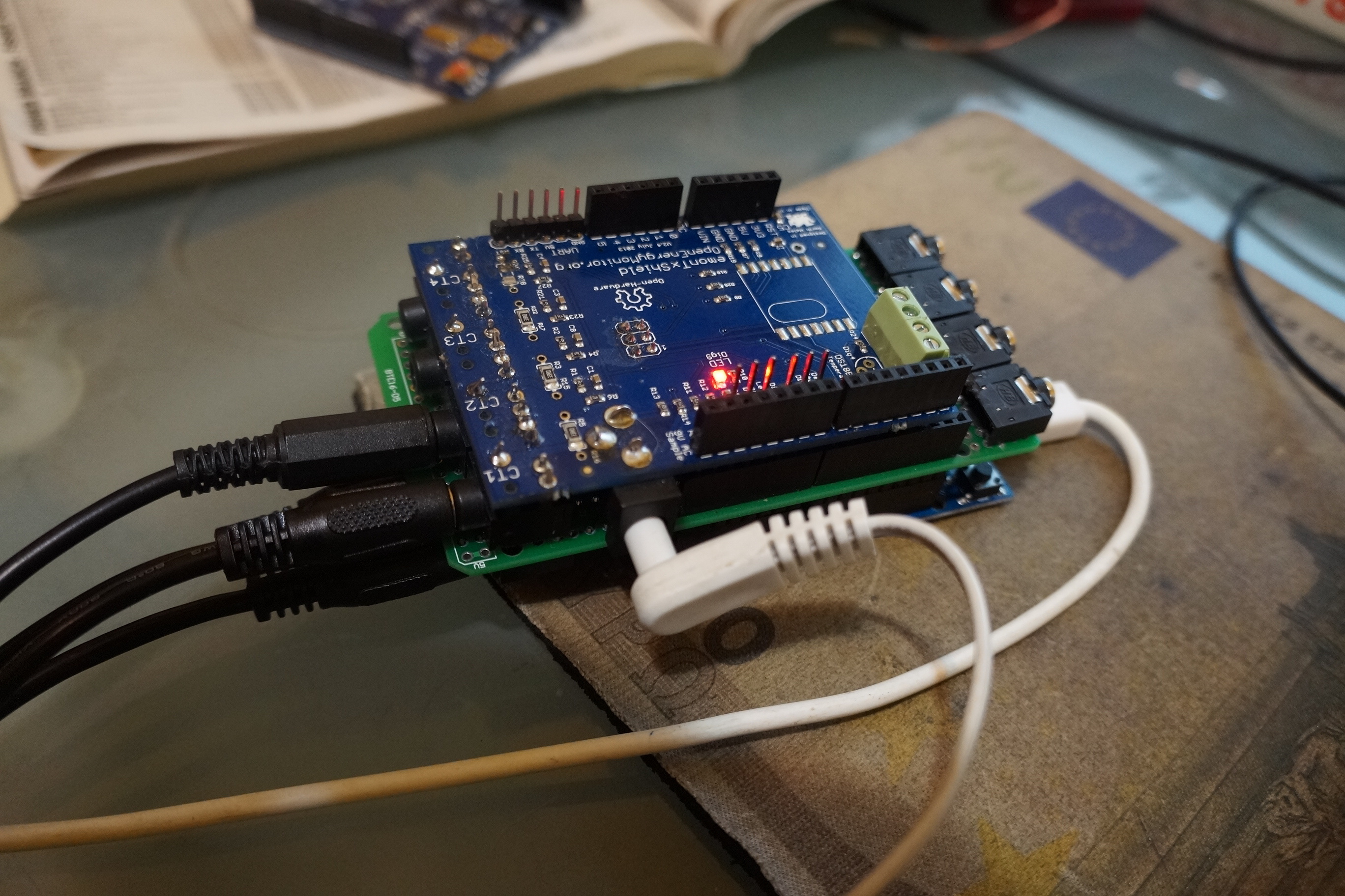

For those who might be interested, here is a custom emonlib using mcp3008 (or other mcp30XX chips 10-16bit)
It works well though if only doing current, you have to sample ~30000 times to get accurate results with a wemos D1. If using voltage and current then it works very well as is.
I did mine as an adaptor board for emontx shield and wemos D1. I also used the esp 8266 built in analog pin to calculate the voltage. So it gives me 8 CT ports.
You can use a wemos D1 and have 8 CT ports but it should also be stackable on top of an emonTx shield and an Arduino base to give you 12 ports (though i have not updated the firmware to support it. (I will do so in a few days)
[EmonLibMCP.zip](https://community.openenergymonitor.org/uploads/default/original/2X/1/1d5eefc3894be8c6997f6a8c3a0d0d39b29122d0.zip) (13.3 KB)
you will also need the mcp3008 library .
[MCP3008-master.zip](https://community.openenergymonitor.org/uploads/default/original/2X/1/1250619aa510cfdb420953d0cfa2e5a728ffc29d.zip) (3.2 KB)
example board image
 ![](https://community.openenergymonitor.org/uploads/default/original/2X/1/1c36a66f72cd8f9932caae5668f4c1e5388da9f0.JPG)-

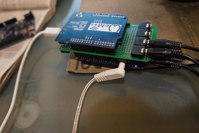

With 8 CT stackable with emontx shield, and a wemos D1 or Arduino - the four on the same side work in conjunction with enmontx and the Wemos D1. If no emontx, then it can be use as 8 CTs and current only. If stacked on an arduino and emontx shield it will give you 12 CTs.
 ![](https://community.openenergymonitor.org/uploads/default/original/2X/0/0bb71513d079d4fa4c7f72f7442130fb90d033d7.JPG)
At some point I might include multiple stacking of the adaptor board. It should not be too hard to do. Each stack will add 8 more CTs, possibly 40 more CTs on a Wemos or 72 more on an Arduino or whatever the functional support might be.

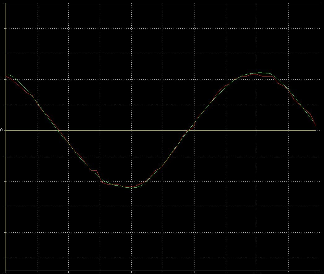

**Post date:** [27 March 2017 01:08 UTC](https://community.openenergymonitor.org/t/mcp30xx-chip-for-esp8266-wemos-d1-adaptor-board-for-emontx-shield/3538/15 "2017-03-27T01:08:04Z")
okay got the LXARDOSCOPE - had 0.95 did not want to work so I downloaded the oldest version and then updated the sketch . and it works fine with the newest version LXARDOSCOPE.
the green line is the build in analog on doing the voltage the esp8266 and the read line is mcp3008 and the CTs
the good CT
 ![](https://community.openenergymonitor.org/uploads/default/original/2X/8/88187cd33e5c78dfcb14930db0c0fb062fee9887.jpg)
the cracked CT - seams to peak slightly later from the image
 ![](https://community.openenergymonitor.org/uploads/default/original/2X/5/555a6a09f04f34668684127dc83e7e97eb56c946.jpg)
dBC not sure what you mean here
“You could wrap your CT around a feed to a purely resistive load and then see if your monitor reports a PF of 1.”

**Post date:** [27 March 2017 01:27 UTC](https://community.openenergymonitor.org/t/mcp30xx-chip-for-esp8266-wemos-d1-adaptor-board-for-emontx-shield/3538/16 "2017-03-27T01:27:52Z")
## okay figure out how to overlay the two waves- good ct on top of voltage sinwave ![](https://community.openenergymonitor.org/uploads/default/original/2X/e/ed1e5f539a5319bcce108b88c6180a075667ec58.jpg) crack ct on top voltage sin wave ![](https://community.openenergymonitor.org/uploads/default/original/2X/c/c134f87dd5d0475d8b39d000f4d92f527aef7b04.jpg) slightly out of sync with the voltage sine wave
lxardoscope ( to make it easier for others at some point)
download [lxardoscope download | SourceForge.net](https://sourceforge.net/projects/lxardoscope/?source=typ_redirect)
and use this sketch for simple scope [lxardoscope.zip](https://community.openenergymonitor.org/uploads/default/original/2X/f/f83cdde7eba3439980570165c3f700cea925e792.zip) (1.4 KB)
**Post date:** [27 March 2017 12:20 UTC](https://community.openenergymonitor.org/t/mcp30xx-chip-for-esp8266-wemos-d1-adaptor-board-for-emontx-shield/3538/17 "2017-03-27T12:20:16Z")
Yep, that looks to be about 24° of phase error. So your purely resistive load will appear to have a power factor of 0.91.
