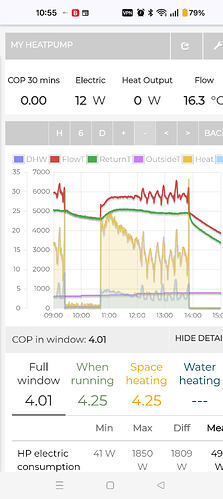

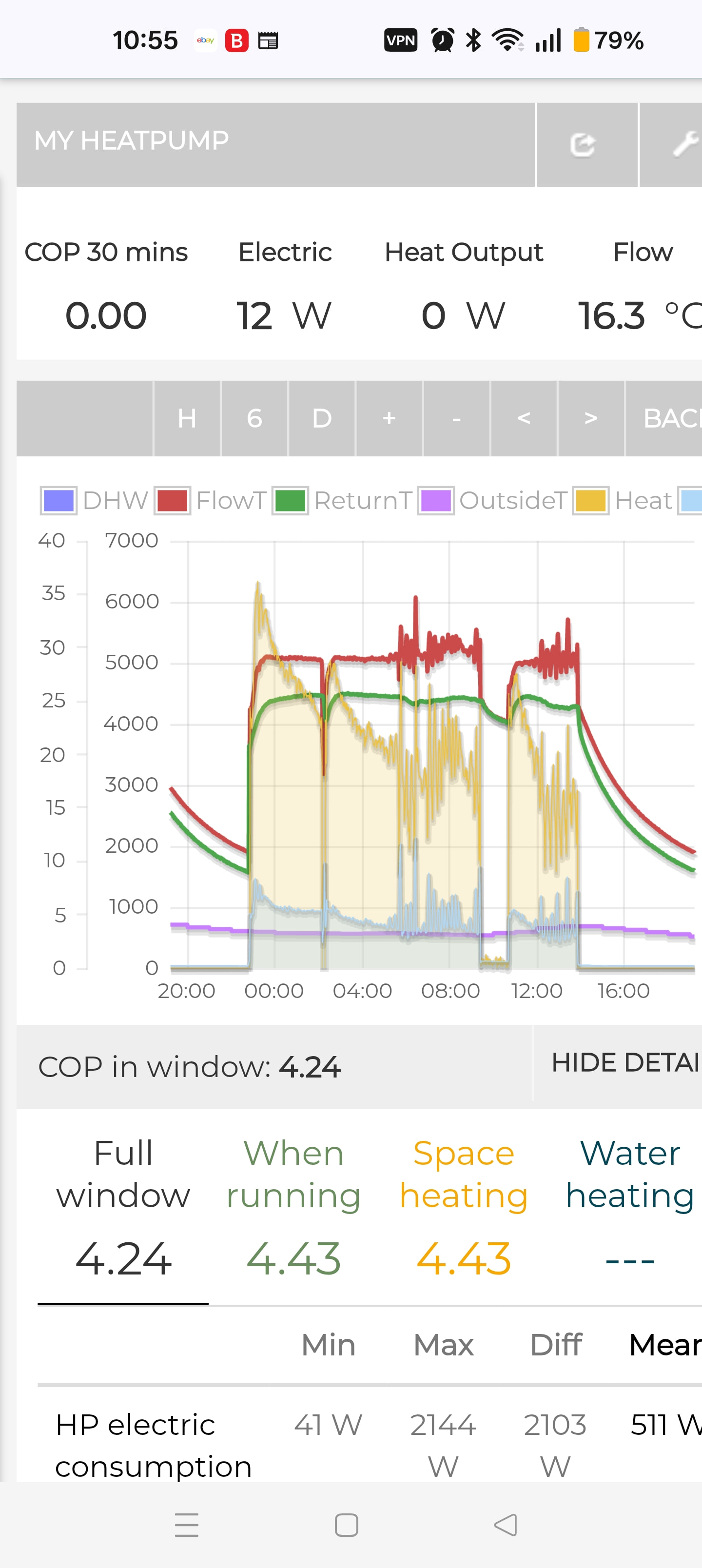

Original plan was to run pure weather compensation, but running practical flow temps at a typical 7 Deg day was really too low to get a sensible dT and a return temp that would allow compressor restart if it stopped. Also got quite a bit compressor hunting when heat pump had run out of room to put heat into the floor. Kept trimming back flow temp and it got better, but still not great. So reverted to running against a house thermostat, which help but did not cure the issue.
Working with AI to diagnose we found during hunting the heat pump control was doing things with the flow temp and due to the floor being a huge buffer not getting the feedback it expected (flat return temp) control went into chasing itself mode.

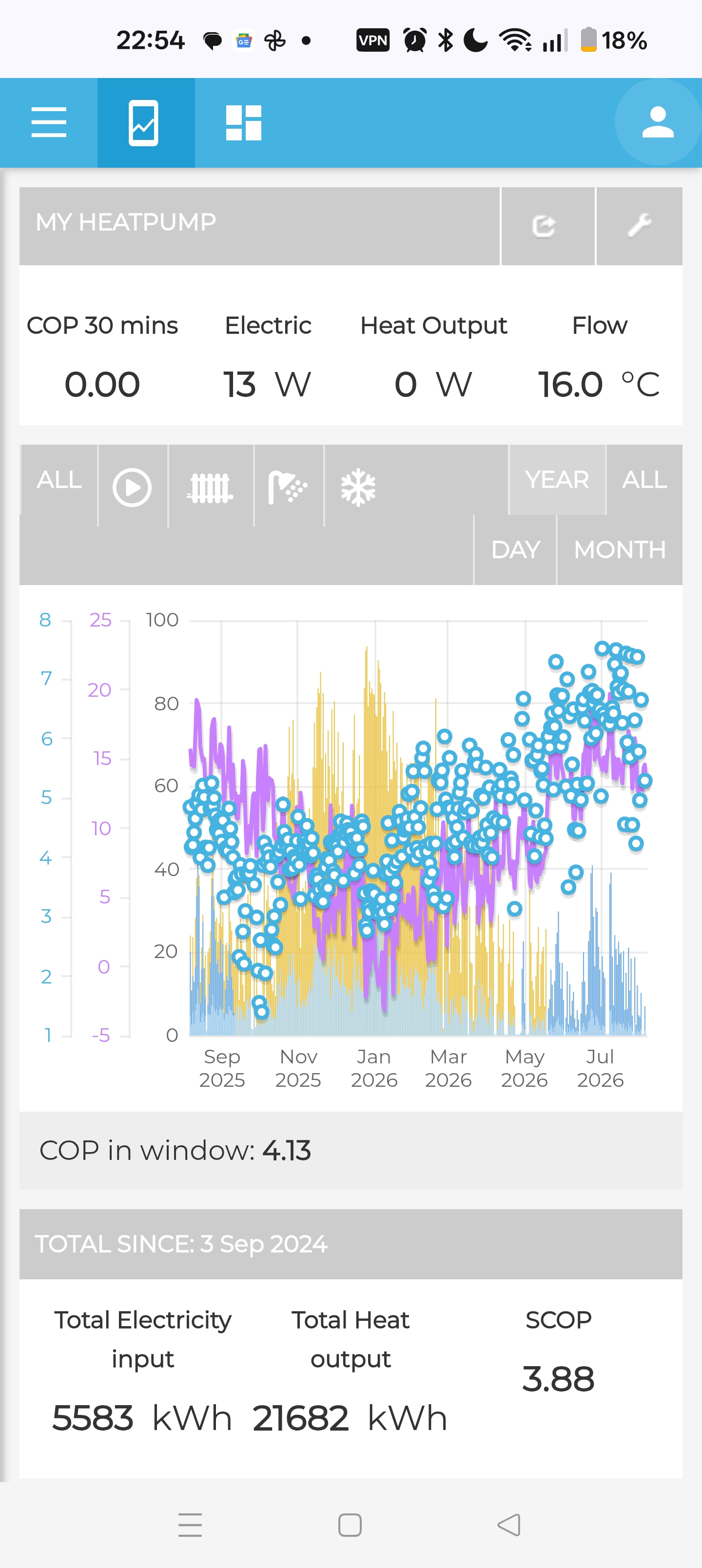

A years worth of data Haier installed Jan 2026 and CoP has got better as system tuned. Current 3 monthly CoP is 6.1. I don’t do DHW with heat pump. Would rather let the heat pump full use of cheap periods heating or cooling and let the immersion run at night in cheap period or day time when solar will provide the energy or again in a cheap period.

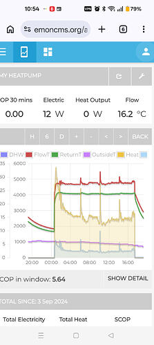

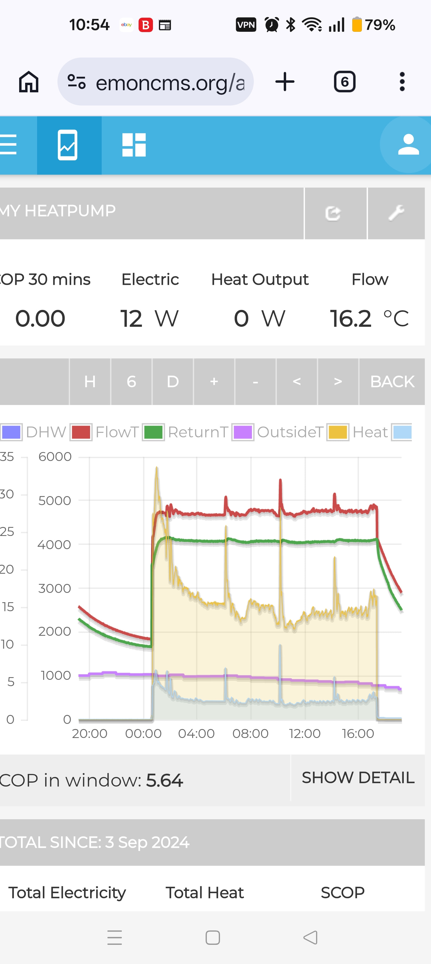

image below shows a one day run at 3 to 4 Deg, no issues getting a CoP of 5.6.

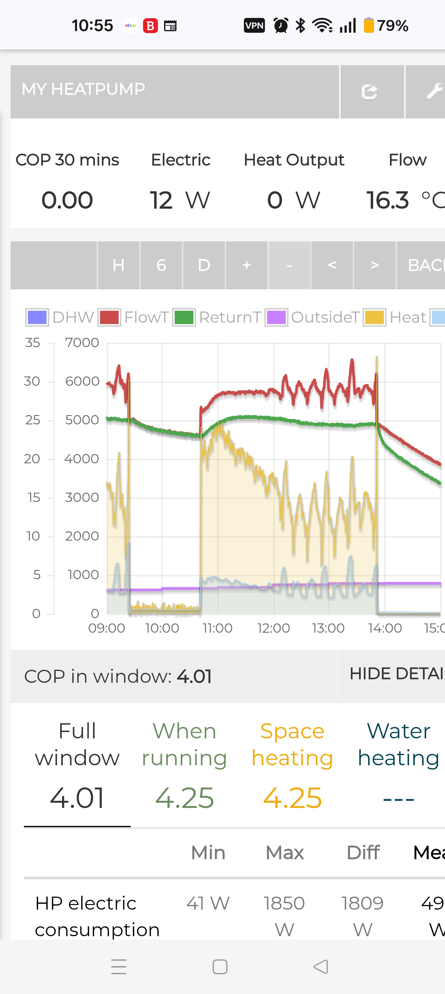

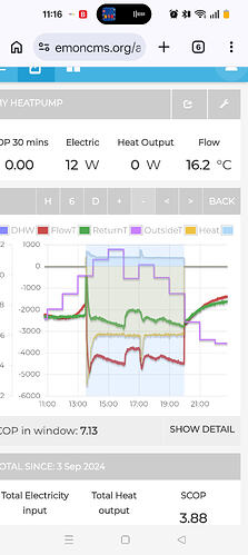

Next day slightly cooler at about 3 degs, runs fine for about 6 hrs then starts hunting.
Below is a close up of one section of the day
Close up showing return temp not changing to big changes in flow temp being input by the heat pump controller (green and red) during that part of the day CoP drops to 4.0.

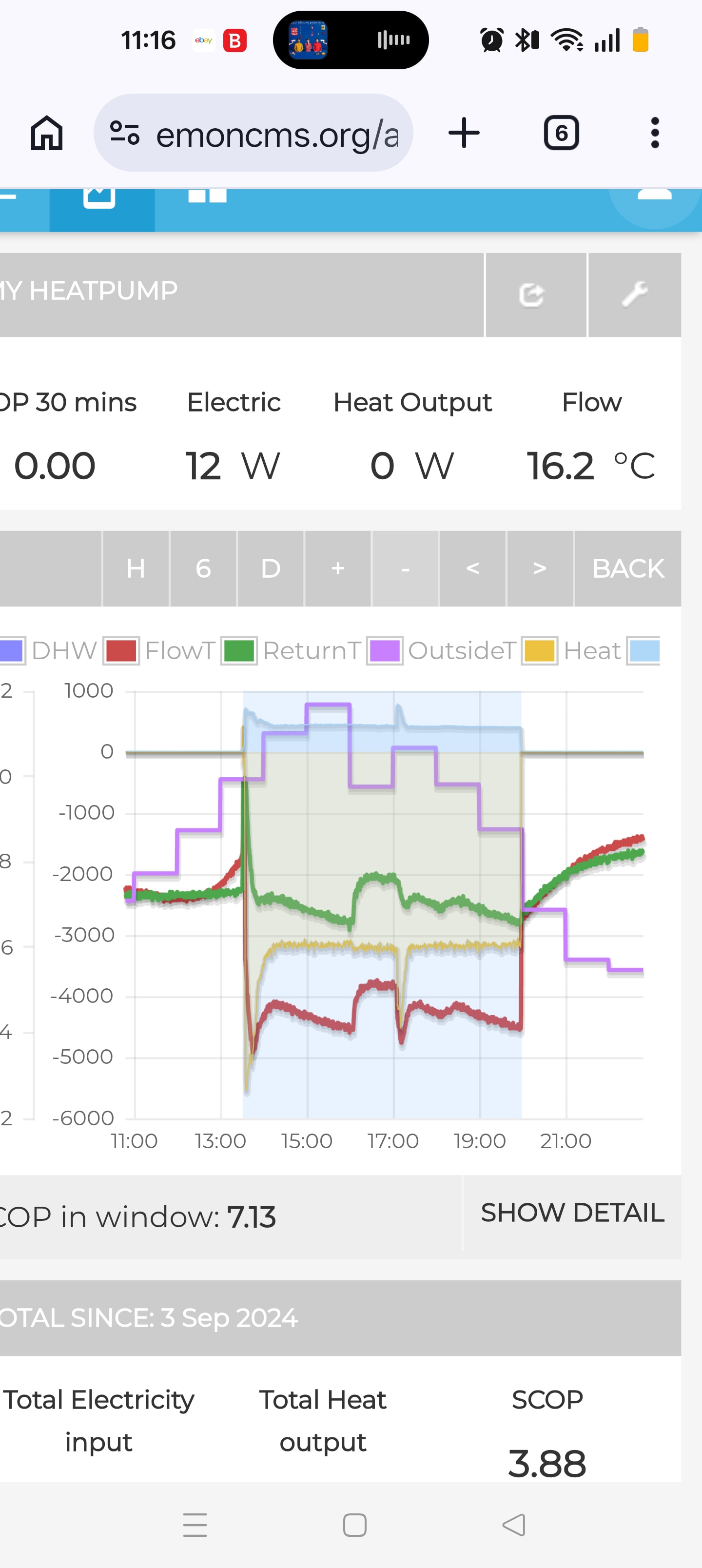

Below is a cooling run after installation of the CCTV now have good tracking of flow and return temps
Notice the power spikes - one at 1700, seems to do this every few hours in heating and cooling, not sure why assume to move away from a fixed running position to exercise things.
