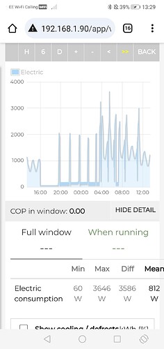

Hello after 3 years I can finally see the energy my LG Thermobloc V 14kw heatpump is using. Now I want to know if it is set up optimally. I run on Heat mode at 22C overnight, on AI/weather compensation mode during the day, apart from 4pm to 7pm when it’s off because we are on Octopus Agile tarrif. The house is at a steady 18/19 which is good. I’m concerned about the spikes though. Apologies if this is the wrong thread for this question!

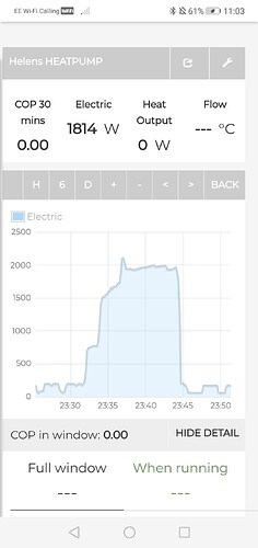

Hi Tim thank you for getting back to me. I was advised on the Facebook Group for LG Themabloc owners to try turning on silent mode, which I did yesterday at 1.30pm. This is the first picture, it dud seem to reduce the frequency of the spikes. The second picture is zoomed in. I have set my feeds to public but I haven’t looked into how to share them yet.
Looking at your first charts, some of the spike seem so coincide with the peak power draw when the heat pump is running…

Turning on silent mode does look to have changed the behaviour when running:
Can you zoom in on one of these spikes?

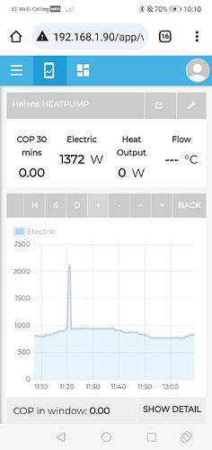

I have zoomed in on one if the spikes that occurred while in Heat mode.
Thank you, Helen
Hmm… that is quite a chunk of power, which doesn’t look like noise. It also doesn’t look like a backup heater, which the manual suggests would be 3kW.
Would be interesting to know what the flow temperature is doing during that period, if you’re able to find out.

Ooof, that is very low, possibly too low for your model of heatpump and size of radiators. I can now see that the night time behaviour is very spiky as it tries to get the flow temp up to 22°, overshoots within 10 minutes and turns off again. This is what we would call “cycling”.
I would suggest either a higher flow temperature of, like 35°, or keep it on AI mode all the time. The daytime behaviour on silent mode looks much more sensible.

I’d say the consumption looks to be right, and the spikes are just normal cycling operation; not too frequent to be of any concern. Silent mode may help with this, have seen similar advice for other heatpumps.
The heatpump looks to be targeting a flow temperature of 32° during the day, which is pretty good for a radiator only system. Is there a setting in LG for what room temperature it’s aiming for? Is there a mode where it’ll turn off when the house is warm enough?

Similar to what Helen sees, mine cycles a lot in warmer temperatures if I don’t switch silent mode on and allow a +4C overshoot which gives it space to find a balance. I think this comes from the pump being a bit oversized.
@Peter_WA is the expert on LG spikes though. If I were to butcher his summary, I’d say that the LG starts each cycle very heavily - it consumes a lot of power for the first 20-30mins before settling down. If the pump is oversized to begin with, this means it will often overshoot and stop. Allowing the +4C overshoot helps it get over this bumpy start.
Peter has also been looking at some spikes that occur during normal operation but not in silent mode. He was speculating if they may be for an “oil recharge cycle where lubricant is injected into the refrigerant circuit”.
Hi @sambeaton - I’m actually under @dyllysdad :slight_smile:
Attached is a doc I created regarding observed short spikes which I think is what Helen is seeing, together with possibly the usual LG aggressive startup. I only see the spikes when running in normal (vs silent) mode and the system is humming along continuously. I expect that when a compressor cycle starts that some housekeeping is performed, and that could involve some lubricant operation - but a complete guess on my part (I have seen others mention it, but never had LG confirm it). If the system is cycling then there will be that housekeeping - but if its continuous then my suggestion is that it enforces this action. In silent mode I don’t see this. As the spike is high power then it escapes silent mode temporarily so I guess silent mode supresses it.
