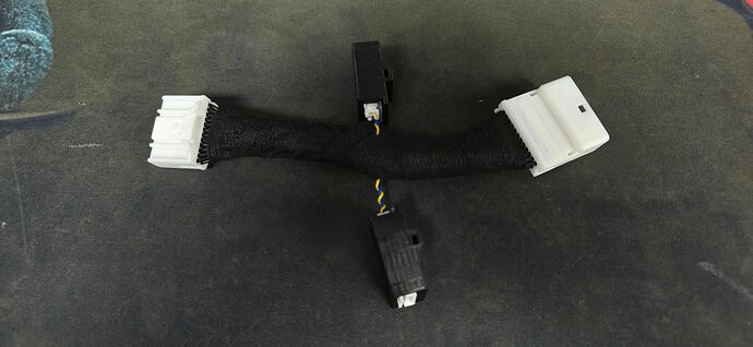

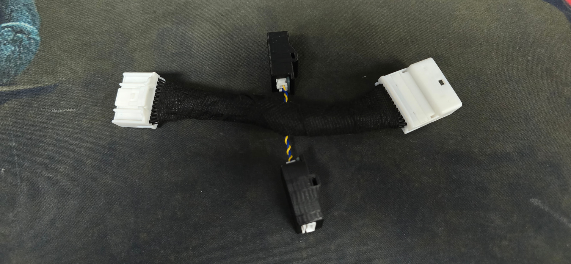

I’ve finished the wiring extension harness with two breakout connections for the CAN buses I’m interested in: EV-CAN and CAR-CAN.

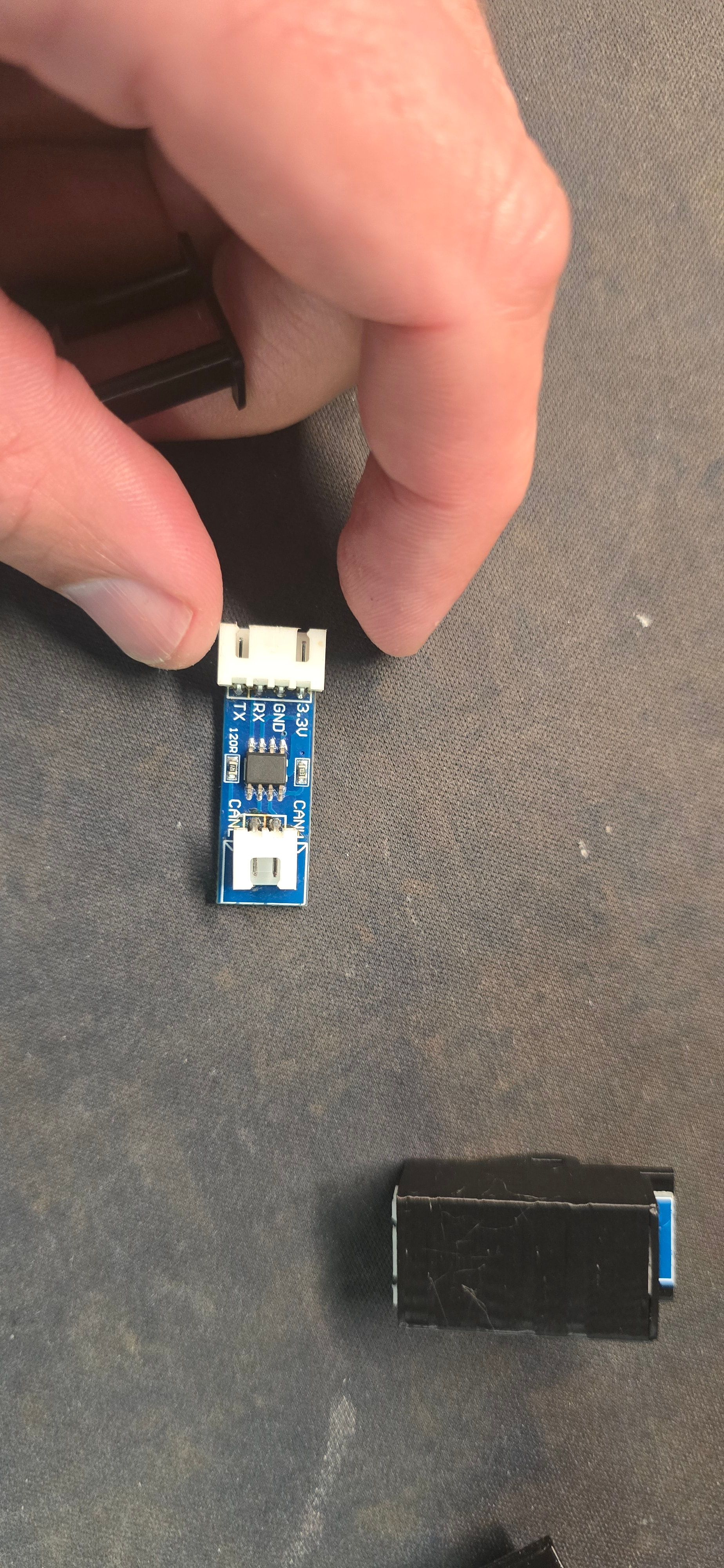

I’ve also installed the two SN65HVD230 transceivers, replaced their connectors, and designed and 3D-printed custom enclosures for them.

Nice progress today! After fixing a few bugs that left me with no connection at all, I finally tracked the issue down to poorly crimped JST connectors. Everything is now working as expected.

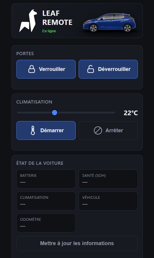

I’ve completed my EV-CAN and CAR-CAN taps. For now, I’m focusing on the EV-CAN since my main interest is remote climate control.

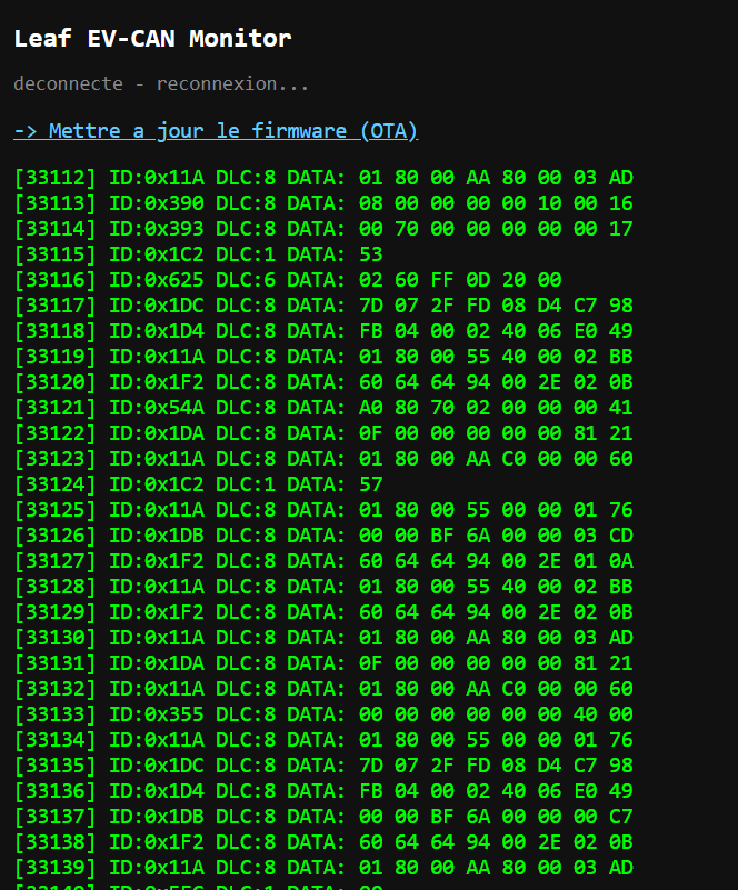

Today’s goal was simply to listen to the CAN bus. The next step will be message injection.

Just wanted to say thanks. This harness mod thread was a huge help. Used it as the reference to tap into EV-CAN/CAR-CAN on my ZE1 and built an ESP32 + Particle Boron setup for remote HVAC control and lock/unlock (no OEM TCU dependency). The vehicle_nissanleaf.cpp CAN sequences from OVMS were the missing piece that made it actually work reliably. Happy to share details if anyone’s doing something similar.
