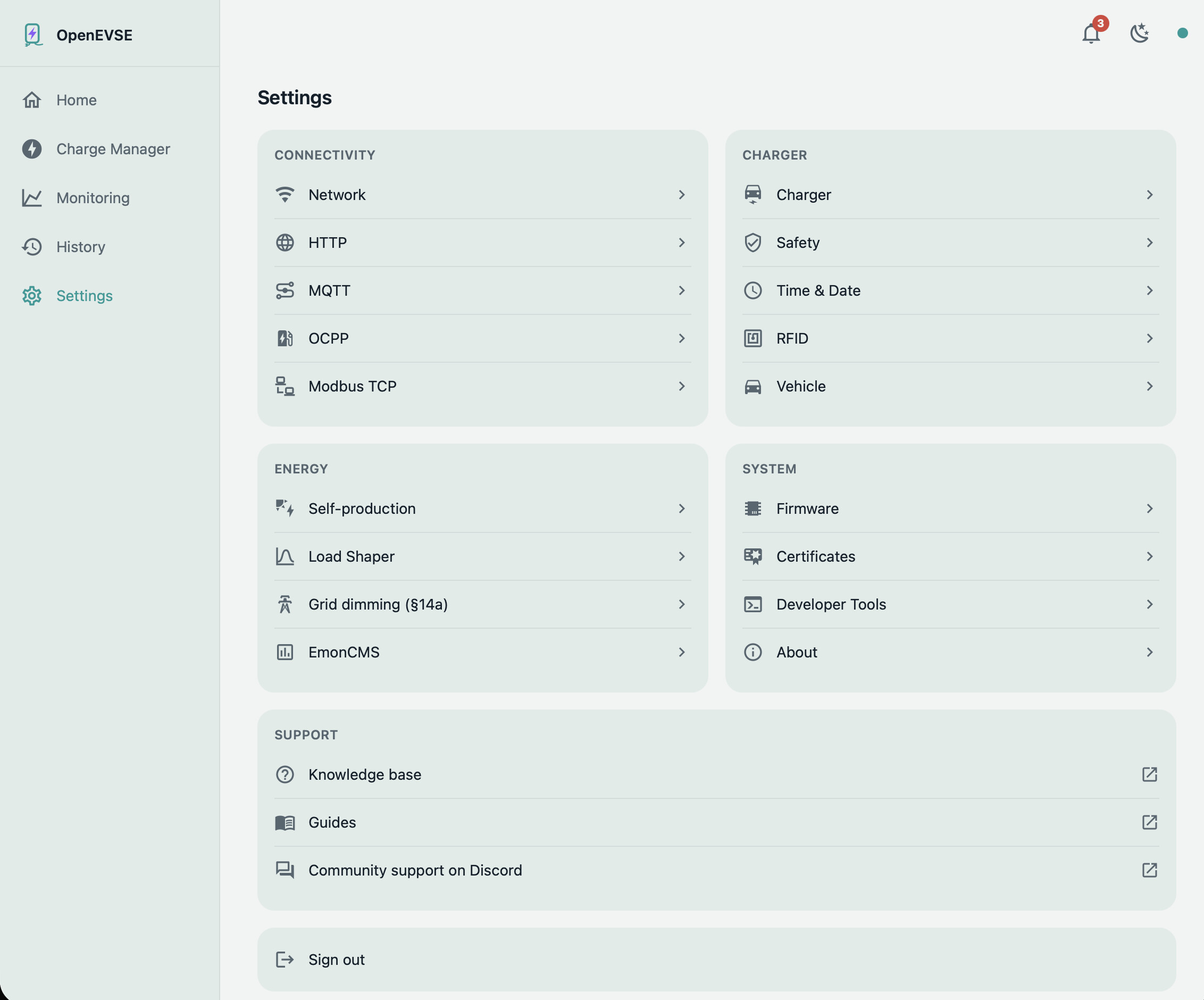

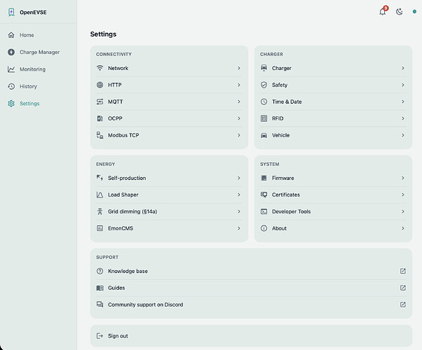

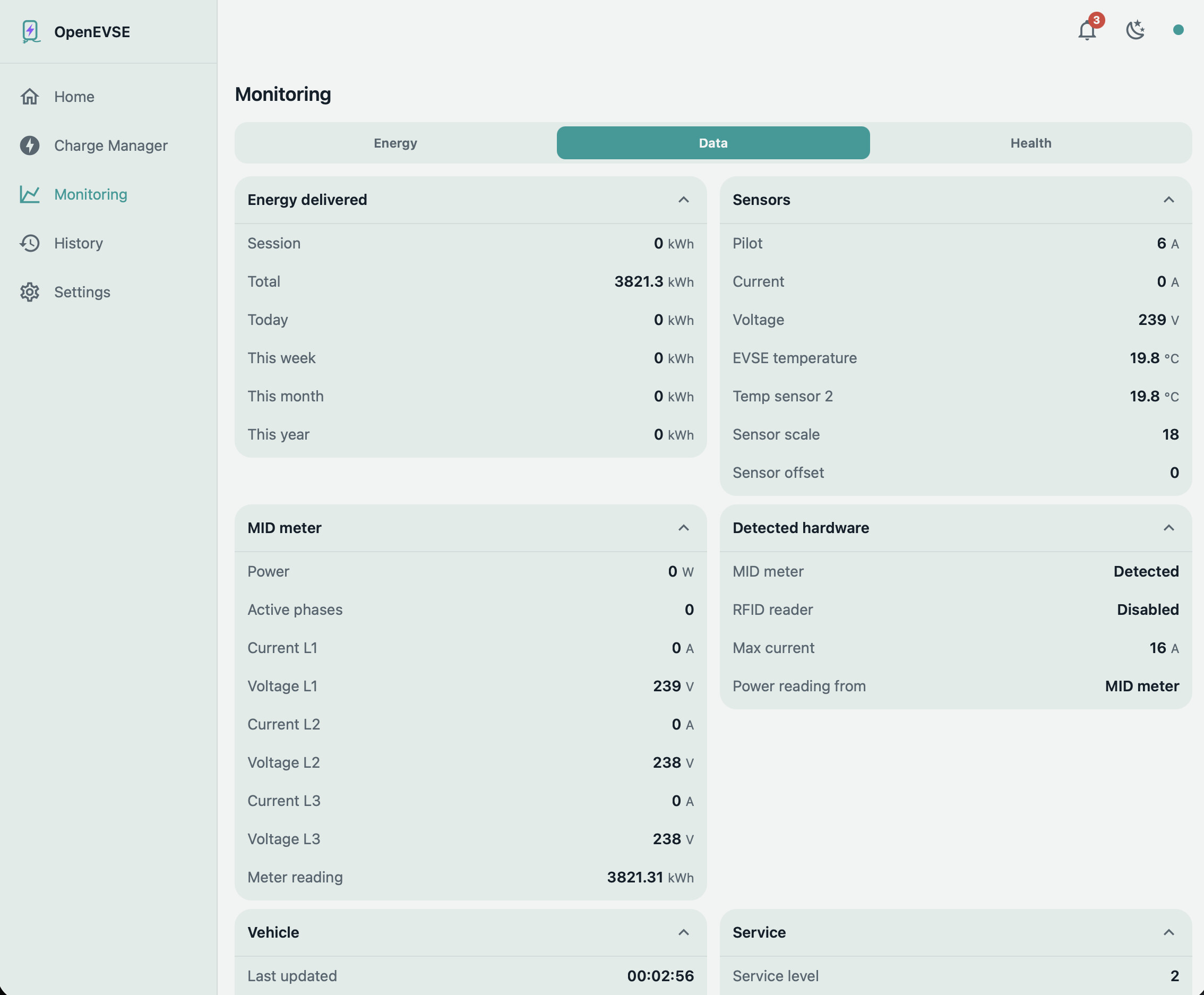

Maybe that will help all the People who bought in Germany one of the Kinetos Boxes, I updated my EVCC and now it had a problem with the EVSE Firmware on the Kinetos Boxes (Power Rock Pro), My Version was 4.1.4 and EVCC mentioned only 4.1.9 or so.
So I took my Claude together and said that it should Update my Kinetos Firmware to the latest one, so it did deliver and now my Box ist on the Latest OpenEVSE Master Image. I tried to build all Functions of the Kinetos Hardware into the OpenEVSE Firmware und let it all Document it with all the Pins and Whistles it found in the Firmware.
It also wrote a Firmware Image Downloader so that everyone can Download their Firmware as a Backup, you only had to Upload the downloader and then you habe som endpoints on the ip on the reboot that you can dump your Firmware.
After That you can update to the latest Firmware from OpenEVSE - I habe a complete guide on how to build your on Version of it.
I also released som Version which is currently running on my Kinetos Box, I did not charge my car yet, but from all what claude could read, it should function - will do a Charge in the Afternoon.
This Version also works completely with the MIDI Counter and Display and RFID Reader if you have one.
Functions I added:
- §14a Reduction
- RGB LED Light Show
- Modbus TCP for the MIDI Counter
- trimmed down old Stuff from Kinetos like their uLM Load Balancing - now it uses OpenEVSE Loadbalancing, whit the addition of having a house budget which the boxes now can load balance arount
- Home Assistant Discovery over MQTT
- Individual RFID Card History
If you are interested, here is my Github Repo to Checkout **[kinetos-openevse-v5](https://github.com/chloepriceless/kinetos-openevse-v5)**
