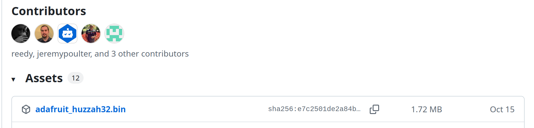

Indeed, but I guess that is not happening anymore. I got in touch with someone who flashed OpenEVSE firmware using the provided web frontend of the box with :
 ![image](https://community.openenergymonitor.org/uploads/default/original/3X/7/5/758336b0ac80147430a6bf613c5c6c1f103f015c.png)
> **[Releases · OpenEVSE/openevse\_esp32\_firmware](https://github.com/OpenEVSE/openevse_esp32_firmware/releases)**
> OpenEVSE V4 WiFi gateway using ESP32. Contribute to OpenEVSE/openevse\_esp32\_firmware development by creating an account on GitHub.
Is that that simple? But the box stopped reporting any ampere values at all. I am not sure about how safe that approach ist.
Is there a way back? Mhmhm…
Thanks,
PNT

ESP32 only reports stuff, so it is rather safe to flash it. Charging controller an
He lost ampere indication, because of Kinetos using separate energy meter for that. Maybe the board still has CT header for this case and he can connect a CT.
That is a main reason why i want to make a backup before flashing.

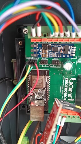

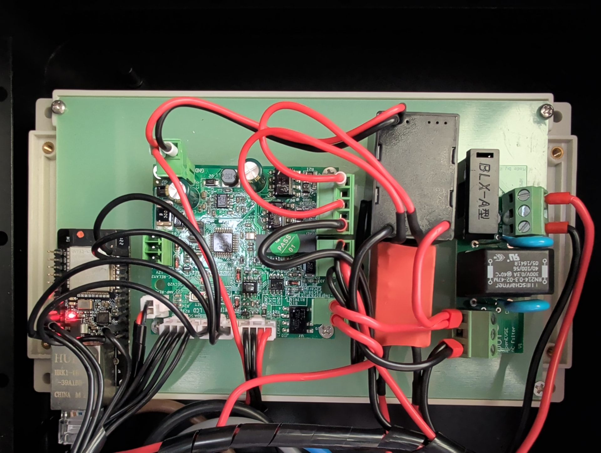

My Olimex gateway arrived early and I decided to flash it and try to connect it, as I saw jumpers on TX/RX and i managed to guess right - I connected to RX/TX/GND/3V3 pins and changed pin 5V to 3V3 on Olimex board and things work just fine. Olimex with external antenna even has good Wifi reception where original board was offline. The only thing that nowhere did I see flash size, up until the flashing. Just have to figure out a good place for this board.

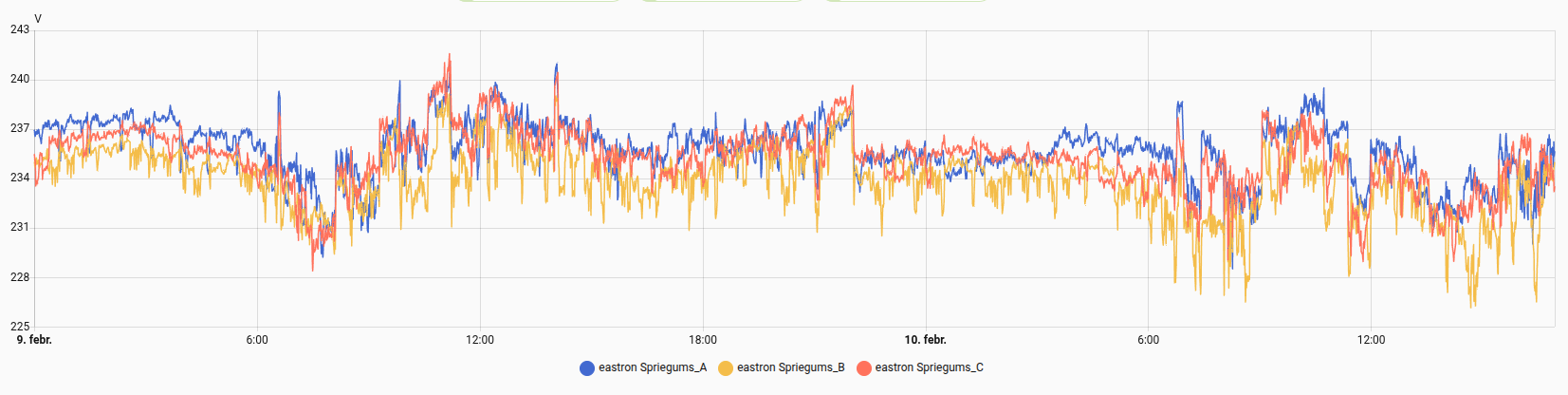

And yet, we can take a good idea from Kinetos, but implement it better - voltage measuring (i.e. usage of a meter or something in that style).
Here is my home voltage graph of all three phases for this day:
 ![image](https://community.openenergymonitor.org/uploads/default/original/3X/c/6/c642a9796a3625facf4e2d7d7d8c81ba3deaaeca.png)
Our standard (EU EN 60038) allows for 230V/400V with ±10% deviation, therefore power may deviate by 10% and ±10% is not exactly precise even for home use statistics.
I would implement PZEM style device that would be cost effective and functional at the same time. PZEM-6L24 for 3 phases or just PZEM-004T for single phase.
When it gets warmer, I will probably try to connect that meter to my HomeAssistant, though I have no hopes, since it was branded Bond Electronics and nothing can be found on the internet about it.

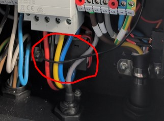

So.. a tiny progress.
Got a pack of small current transformers and connected one to the C+ and C- pins on the board and got a working current detection with reasonable precision.
I have not flashed the EVSE yet and to most of the commands I get a respoonse of “RAPI\_RESPONSE\_BLOCKED”.
So far only the light colour does not work and I haven’t tested RFID, nor I plan to implement it.

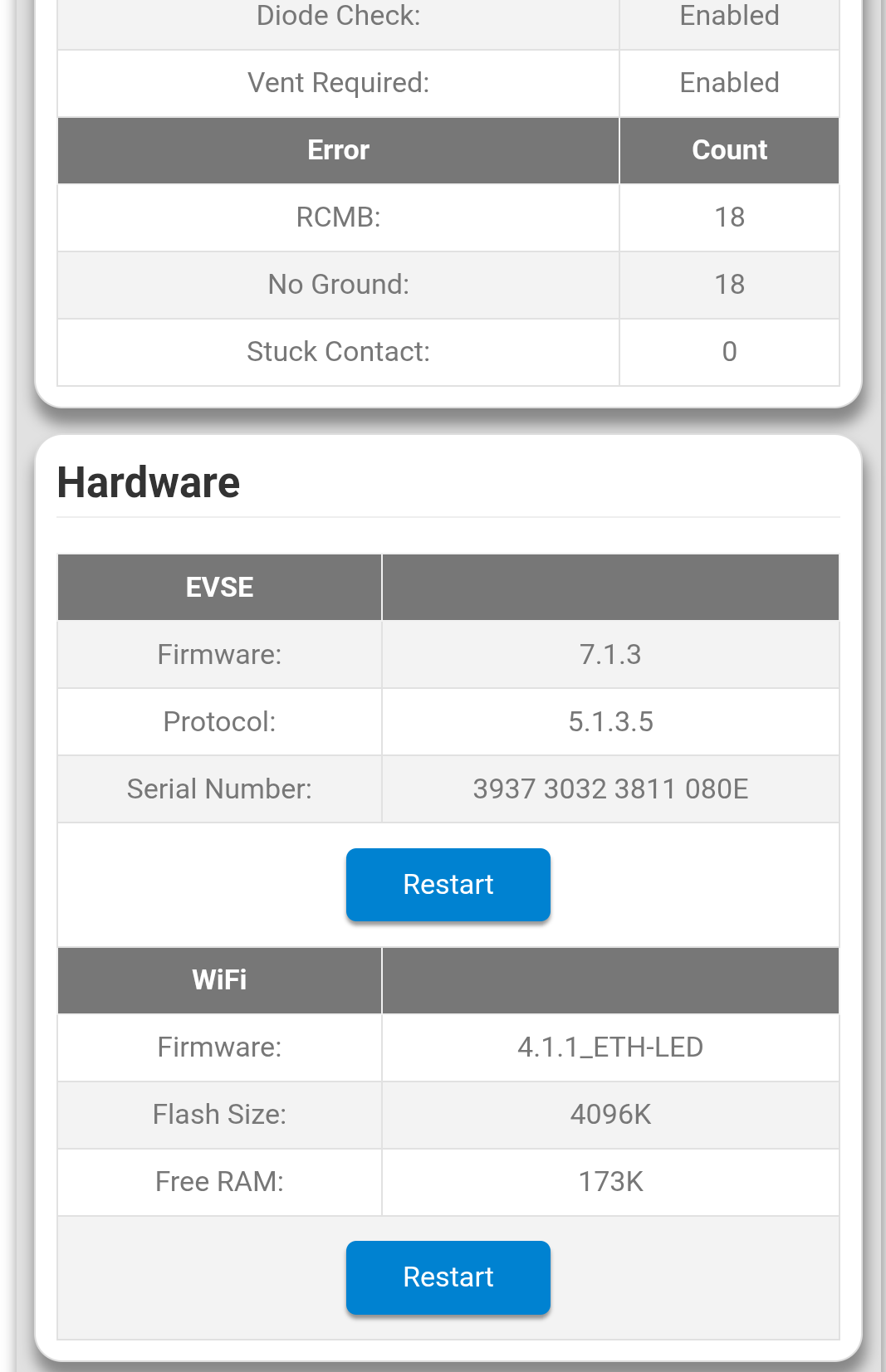

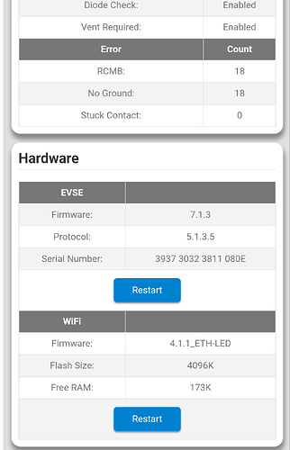

**Post date:** [13 March 2026 05:45 UTC](https://community.openenergymonitor.org/t/kinetos-professional-openevse-wallbox-issues/28762/30 "2026-03-13T05:45:54Z")
I have one too…
Mine is working stable. Wifi, Car Connection..all works fine until I rise the current above 7A.
If I do that, the current is jumping way higher, I get an overcurrent error and charging is stopped.
My evse Firmware is 7.1.3 and esp is 4.1.1

That’s quite odd. The current is controlled by car and EVSE just “advertises” the capability.
Do you have a “single board (Bond electronics)” or “dual board "(AUEM)” version?
You can upgrade built in ESP32 with a bit customised OpenEVSE wifi firmware, to keep all functions.
I had to chenge some parts and compile myself after connecting Olimex board for testing.
EVSE firmware is upgradeable only on 2 board version, because germans decided to goof around with ISP pins on “Bond electronics” version. Your problem sounds like either car fault or EVSE settings.

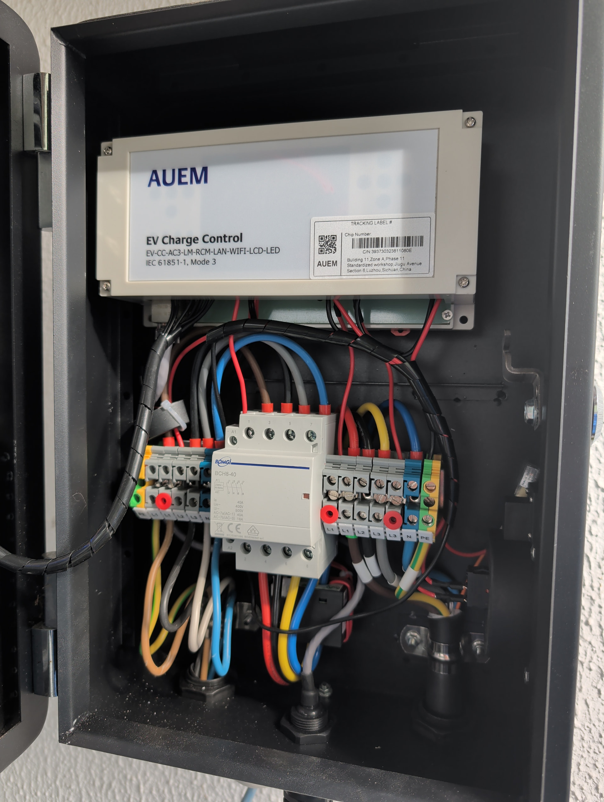

![17752244779263803403670949846842](https://community.openenergymonitor.org/uploads/default/original/3X/a/6/a631df50cda6b062c44a5661df7b802fbc39f379.jpeg)
Single Board as far as I see.
**Author:** ![Janis\_Vaskevics](https://community.openenergymonitor.org/user_avatar/community.openenergymonitor.org/janis_vaskevics/32/35309_2.png) [@Janis\_Vaskevics](https://community.openenergymonitor.org/u/Janis_Vaskevics)\
**Post date:** [3 April 2026 16:08 UTC](https://community.openenergymonitor.org/t/kinetos-professional-openevse-wallbox-issues/28762/33 "2026-04-03T16:08:23Z")
Nope, Auem must be 2 boards. Try to remove that plastic cover. _ **Please be sure to switch off power before!** _

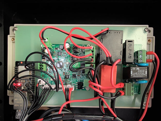

**Post date:** [12 June 2026 05:20 UTC](https://community.openenergymonitor.org/t/kinetos-professional-openevse-wallbox-issues/28762/34 "2026-06-12T05:20:10Z")
Long time no see…
I have opened the Case and…
 ![17812415206626406532975902638225](https://community.openenergymonitor.org/uploads/default/original/3X/9/4/94833ef5b321b2360db1b2c95a9246f17c944f72.jpeg)
You was right. It is a 2 Board.
Also I switched from ID4 to 2026 M3. But same behavior. All above 7A brings me a over current error.
**Post date:** [12 June 2026 07:00 UTC](https://community.openenergymonitor.org/t/kinetos-professional-openevse-wallbox-issues/28762/35 "2026-06-12T07:00:09Z")
Yep, one of the first iterations and more compatible with OpenEVSE. There is a modification in source code for this esp32 board as well. Not sure what brings this error. Maybe wrong CT configuration.
