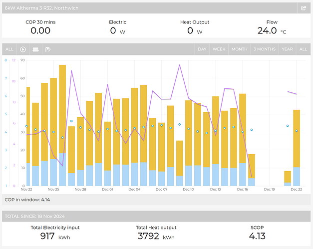

i recently lost all the data from sensors from my heat pump , but the energy used has continue to record , this is not a huge issue but its had a huge impact and distorted my data
is it possible to nil off the data for the days so it dose not distort my data
many thanks Chris

Hi Chris, HPM will only use periods when there’s both electric and heat meter data available when calculating SCOP. So this won’t have affected your overall SCOP figure

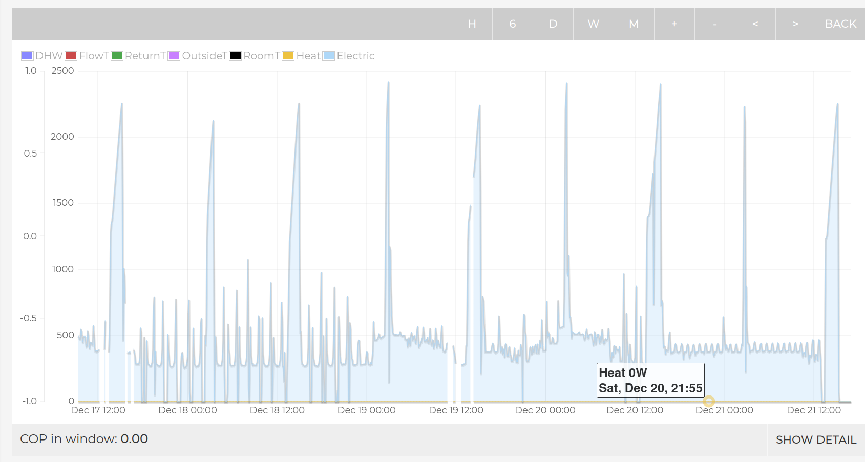

Thanks for the reply @glyn.hudson , but I’m not sure that’s the case the scop figures have nose dived since the heat pump sensors were offline at my end , I assume your systems were still expecting the data to come through
If it can’t be done it’s not a issue it’s just not a true reflection and the data is wrong
Which really dosent help with keeping accurate data
I should of taken the power used sensor away when I lost the heatpump data
Hello @Chris_Hill the issue is that while the flow and return temperature disappered it seems a heat output of zero was returned through that period, not sure if it’s possible to change the logic in the heat pump integration script your using to not post heat data if the integration is offline?

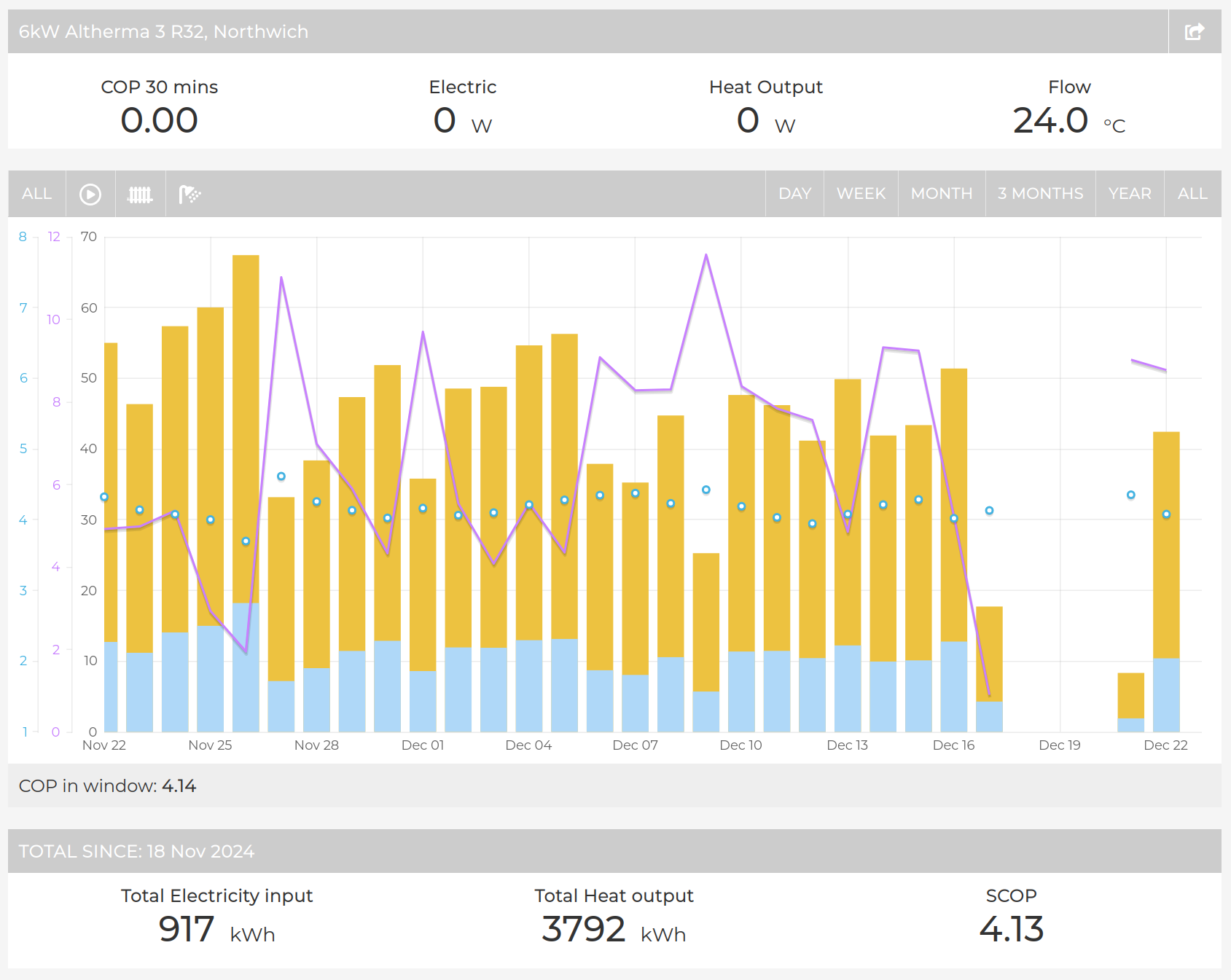

I will fix this particular period though for you manually, I can delete the 0 value heat data in that period and recalculate the daily data
Fixed:
Your a star @TrystanLea , I thank you :folded_hands:
The problem came from the fact I lost all sensors with the exception of the power used sensor , but again thanks for doing this
