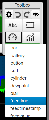

Jaddache
(Simon Sykes)
6
Within the EMONCMS dashboard, the feetime widget will show the latency of a feed as a number.
The isactivefeed widget will display a shape whose colour reflects the latency of a feed.
Will one of these widgets meet your need?
