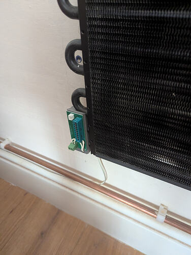

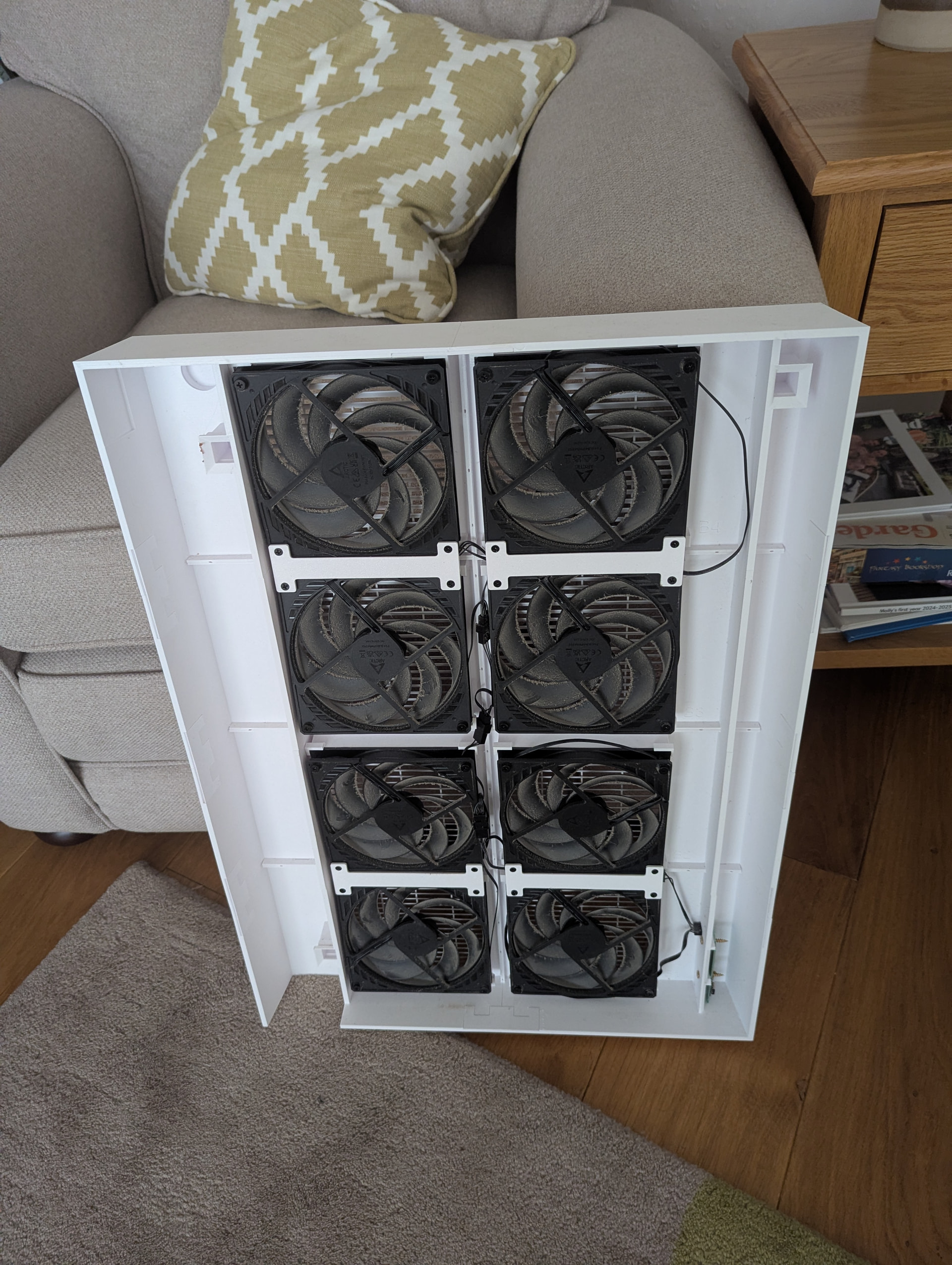

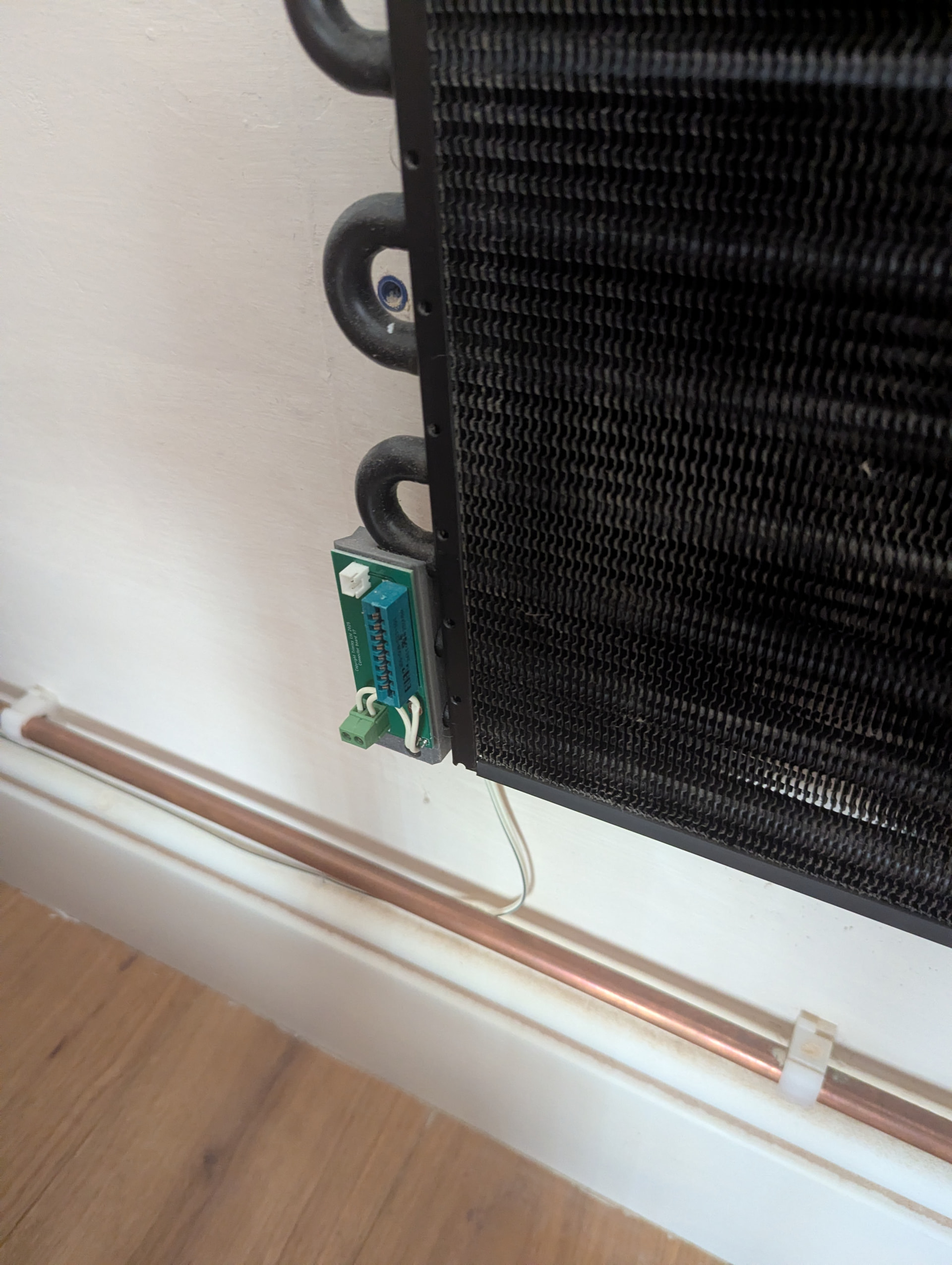

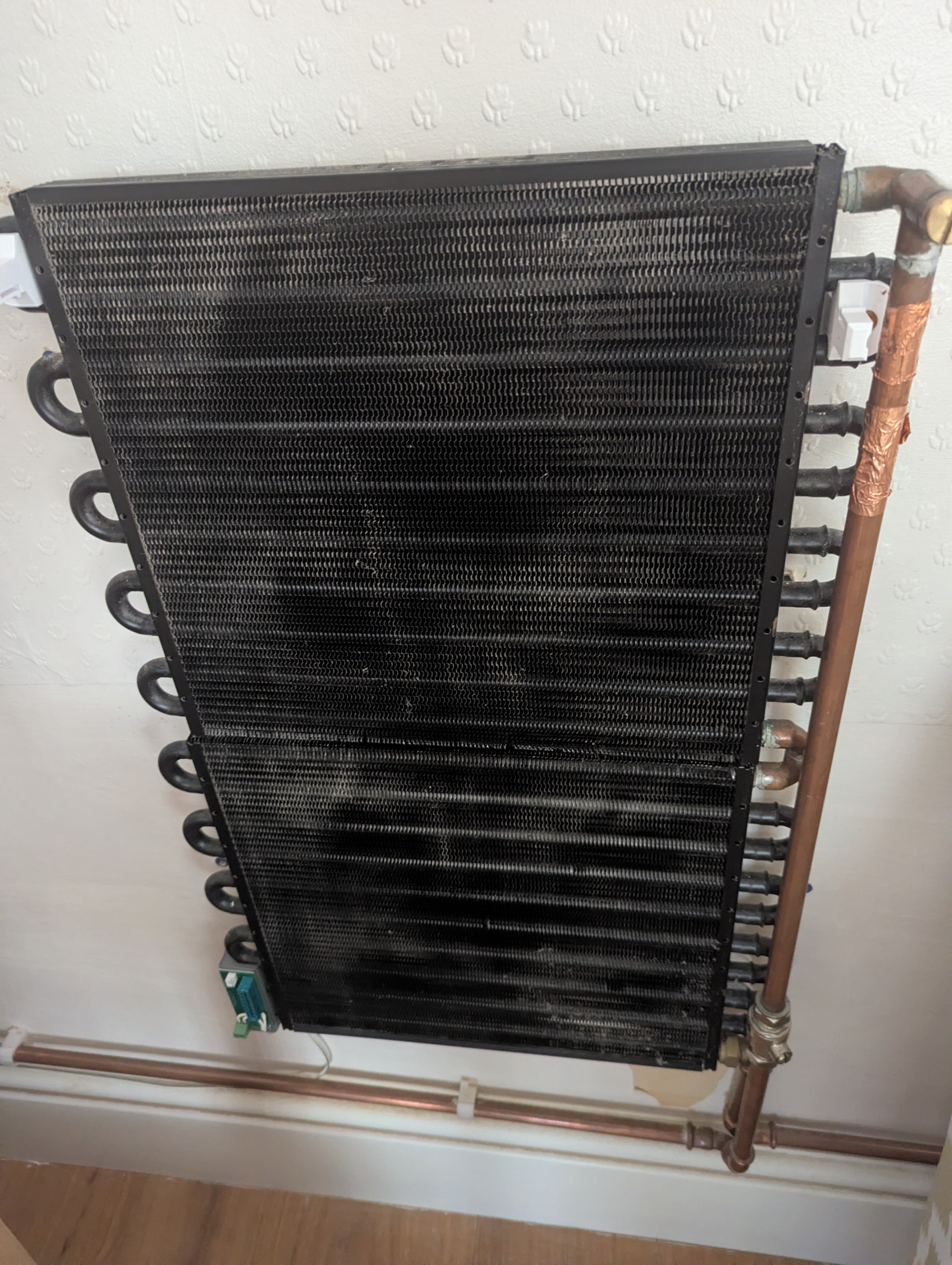

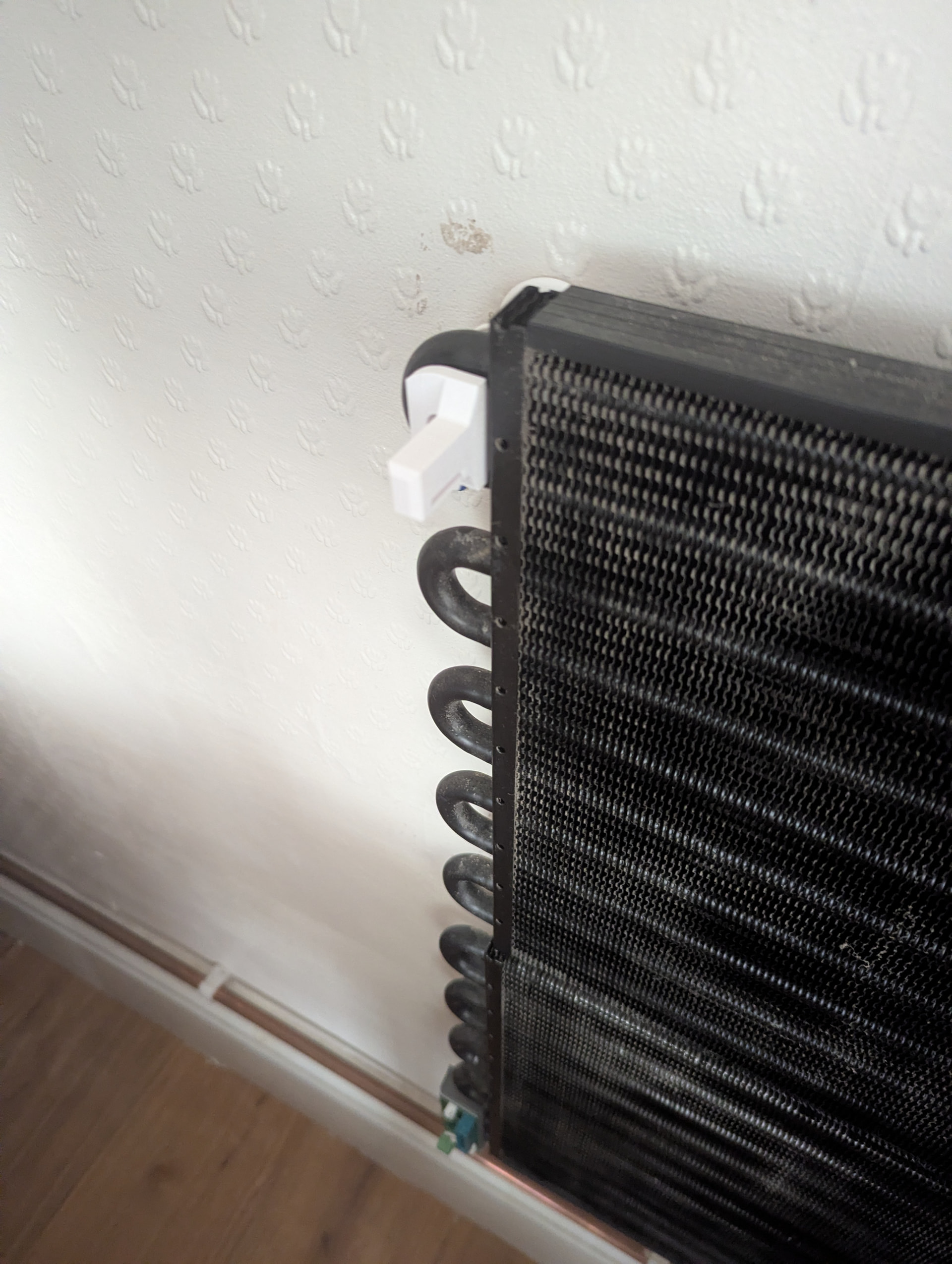

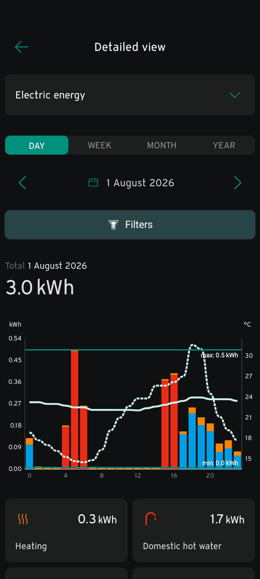

Here are photos of the eight fan unit - excuse the dust, it shows that I need to vacuum them regularly as can eventually affect performance.
No documentation as these have evolved as Trimley refine their approach - e.g. mountings, electrical connection etc. This one replaced a 1600mm T3 radiator so connecting pipework not so elegant.but could obviously be cleaned up eventually. We have another 8 fan unit in another 4x4m room and a 4 fan unit in main bedroom.
When door is closed and room left so you can feel the temperature difference as you enter, or leave the door open and get more widespread but lesser effect. I keep the Vaillant Sensoconfort control box in the cooled lounge as placing in a no
 ![PXL_20260804_131135477](https://community.openenergymonitor.org/uploads/default/original/3X/1/f/1fdee2746d89ae6b65d07e0c1b15abd3fc26f7c3.jpeg)
 ![PXL_20260804_131144917](https://community.openenergymonitor.org/uploads/default/original/3X/f/e/fe3f15e5f204eed413a8ca08a8488080c0a5236b.jpeg)
 ![PXL_20260804_131202352](https://community.openenergymonitor.org/uploads/default/original/3X/c/5/c5a9d16ecaf50e8026b9b7fbf2b48379597a7349.jpeg)
 ![PXL_20260804_131211836](https://community.openenergymonitor.org/uploads/default/original/3X/f/7/f7e385e46a5a32b689227430f37cb339e95c3fcf.jpeg)
 ![PXL_20260804_131326638](https://community.openenergymonitor.org/uploads/default/original/3X/6/0/60f35829552df90a99195146dea19c10be64a0fd.jpeg)
 ![Screenshot_20260804-142811](https://community.openenergymonitor.org/uploads/default/original/3X/7/d/7d68e3f2455061fdd2f490301b1a03a00bd3b297.png)
n-cooled room would find it continually trying to cool.

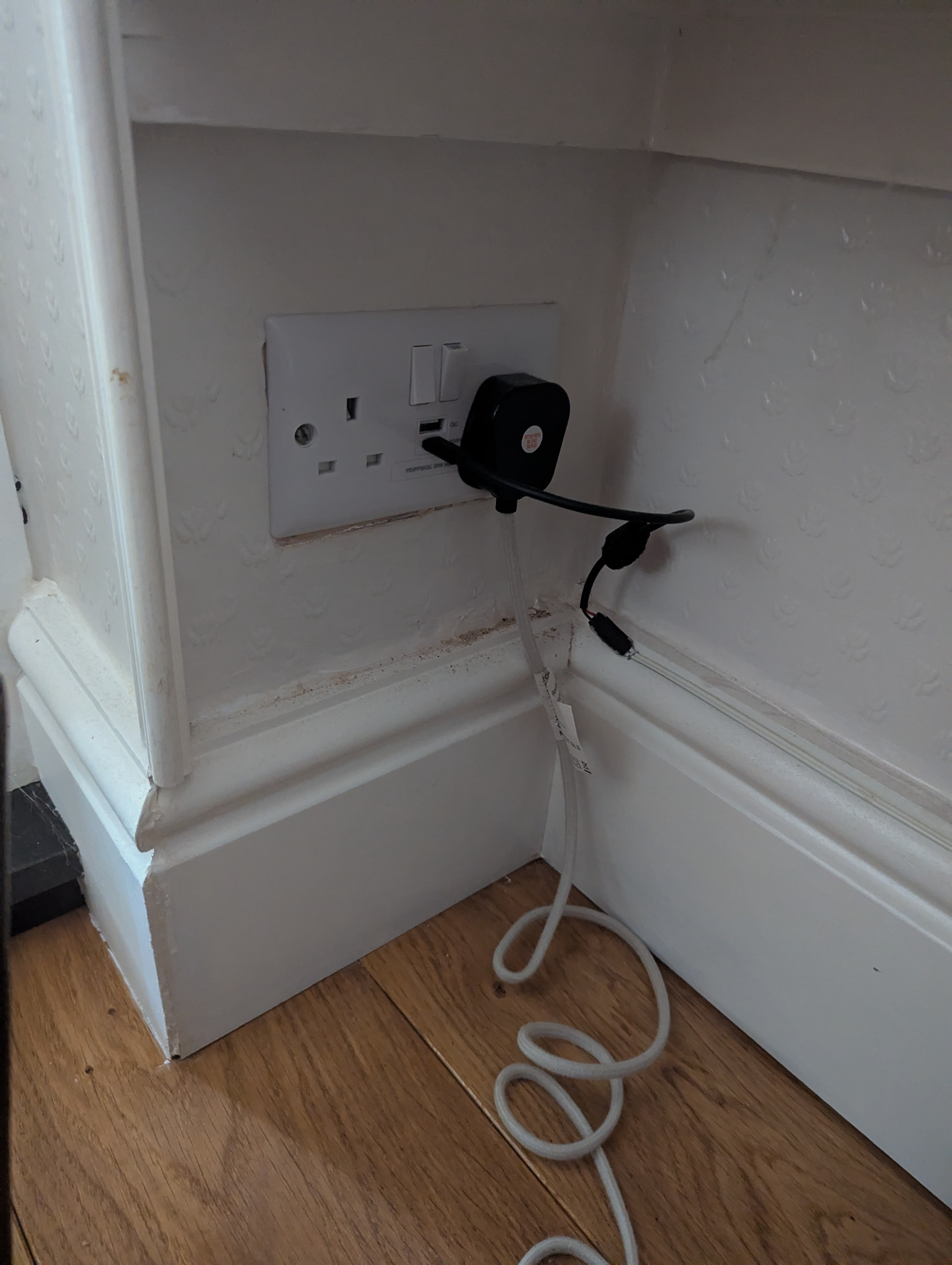

The power comes from a usb-c port in adjacent socket. These are 12v, I think, not standard to give sufficient power to drive the fans. Works pretty silently. The air is drawn in from the front and cold air emitted from wall side. You can feel the cool air movement with your hand or sitting close by when it is on.
Attached is a screen shot from yesterday (we are in Cambridge) showing electricity consumption by function plus inside and outside temperature. The Vaillant generally gives a cop of 7 for cooling. We come off Havenwise in summer as their algorithm does not support cooling. In prolonged heatwave the fabric of the house heats up (beneficial in winter, not in summer) so the internal temperature can push up a bit on hottest afternoon/early evening but never above 26 deg. so far.
