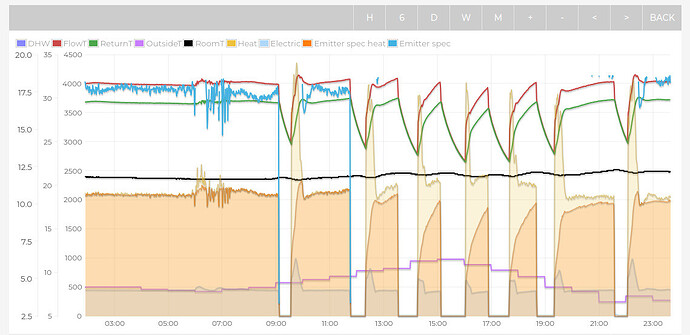

**Post date:** [24 October 2024 20:33 UTC](https://community.openenergymonitor.org/t/infer-radiator-spec-and-system-volume-using-the-myheatpump-app/24798/18 "2024-10-24T20:33:03Z")
Pleased to say the radiator and volume tool has been significantly upgraded. No need to zoom in any more or do a two step process to get a volume calculation. Just enable the tool in the detailed section of the power view and it tries it’s best to analyse the full window!
It also draws the heat output from the radiators in orange, vs heat that is absorbed in the volume:
System 75 example: [HeatpumpMonitor.org](https://heatpumpmonitor.org/system/view?id=75)
 ![image](https://community.openenergymonitor.org/uploads/default/original/3X/7/4/741aa83bdfac6419e5a35d5c258c32080497093a.jpeg)
![image](https://community.openenergymonitor.org/uploads/default/original/3X/0/2/02409427f4915b8b2b81e60b90e8518afc0bd333.png)
 ![image](https://community.openenergymonitor.org/uploads/default/original/3X/4/4/449d450b30fbea06369aac4c20aece6b2384df08.jpeg)
 ![image](https://community.openenergymonitor.org/uploads/default/original/3X/5/d/5dd12883ef0b45f1b6764355993e41243a1c60aa.png)
