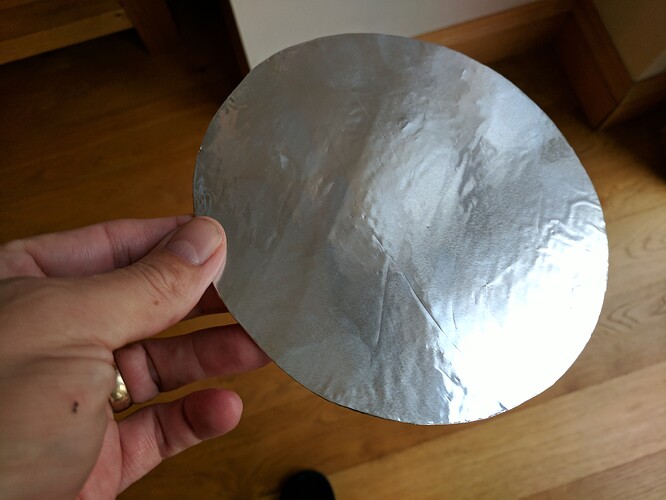

**Author:** ![Paul](https://community.openenergymonitor.org/user_avatar/community.openenergymonitor.org/paul/32/28_2.png) [@Paul](https://community.openenergymonitor.org/u/Paul)\
**Post date:** [12 October 2017 19:08 UTC](https://community.openenergymonitor.org/t/improving-rf-signal-strength-emonth-emontx/5318/11 "2017-10-12T19:08:32Z")
### Further improvements…
I made 2 ground planes earlier from 165mm diameter pieces of cardboard, and stuck aluminium foil to the uppermost surface (see image below).
I sat the emonTX on one (instead of the sheet of foil I tried yesterday), and also sat the Raspberry Pi base station on the other (no earth connection) and immediately saw yet further signal strength improvements, despite both units remaining in exactly same locations.
Measuring over a 2hr period, I now have;
| Mean | Min | Max | Diff | Dev | npoints |
| -66.1 | -72.0 | -54.0 | 18.0 | 3.0 | 720 |
Which seems a big difference from the -81.8db mean average, which I had 2 days earlier.
 ![groundplane](https://community.openenergymonitor.org/uploads/default/original/2X/4/42f89d1b7986073cd1b7d9d1a2439226d38de910.jpg)
**Post date:** [12 October 2017 19:52 UTC](https://community.openenergymonitor.org/t/improving-rf-signal-strength-emonth-emontx/5318/12 "2017-10-12T19:52:15Z")
Any particular way of attaching it to the PCB?
**Post date:** [12 October 2017 19:58 UTC](https://community.openenergymonitor.org/t/improving-rf-signal-strength-emonth-emontx/5318/13 "2017-10-12T19:58:16Z")
No, just place the Pi on top of the disk so the antenna is centered in the circle - there are no electrical connections to the foil.
**NOTE;** I made it 165mm diameter because I understand that it’s radius should equal the antenna length. Which in my case it was 82mm (868MHz).
I assume that it would need to be 330mm diameter for a 433MHz system which has a 165mm antenna.

**Author:** ![Greebo](https://community.openenergymonitor.org/user_avatar/community.openenergymonitor.org/greebo/32/4556_2.png) [@Greebo](https://community.openenergymonitor.org/u/Greebo)\
**Post date:** [13 October 2017 01:04 UTC](https://community.openenergymonitor.org/t/improving-rf-signal-strength-emonth-emontx/5318/14 "2017-10-13T01:04:25Z")
I wonder if sitting it on a metal shelf would achieve the same outcome?
I think I’ll give that a try when I get home tonight!
**Post date:** [13 October 2017 11:21 UTC](https://community.openenergymonitor.org/t/improving-rf-signal-strength-emonth-emontx/5318/15 "2017-10-13T11:21:23Z")
It should do.

**Post date:** [15 October 2017 20:40 UTC](https://community.openenergymonitor.org/t/improving-rf-signal-strength-emonth-emontx/5318/17 "2017-10-15T20:40:19Z")
> [@Paul](#):
> No, just place the Pi on top of the disk…
I was thinking more of the connection to the PCB for the antenna. Straight down or a slight bend on the bottom of the wire and if so, does the bent part get included in the 82mm length?
I also wonder about putting a hole in the ground plane and putting the antenna through the hole and sitting it on the case.
**Post date:** [15 October 2017 20:50 UTC](https://community.openenergymonitor.org/t/improving-rf-signal-strength-emonth-emontx/5318/18 "2017-10-15T20:50:56Z")
> [@borpin](#):
The wire is completely straight & vertical. Distance from PCB to tip of antenna = 82mm (for 868MHz)
> [@borpin](#):
No, the complete antenna must be above the ground plane.
Paul
**Post date:** [15 October 2017 21:02 UTC](https://community.openenergymonitor.org/t/improving-rf-signal-strength-emonth-emontx/5318/19 "2017-10-15T21:02:08Z")
> [@Paul](#):
> 82mm (for 868MHz)
Ah, and for 433MHz?
**Post date:** [15 October 2017 21:04 UTC](https://community.openenergymonitor.org/t/improving-rf-signal-strength-emonth-emontx/5318/20 "2017-10-15T21:04:22Z")
Ahh, you mean for the emonTX.
My emonTX is in a bespoke case, which enables me to have the antenna vertical, however with a emonTX in a openenergymonitor case, it’s problematic to use a ground plane, unless you drill a small hole in the case, pass the antenna through, and lay the emonTX flat.
I think that I gave details for the 433MHz antenna in a post above.
