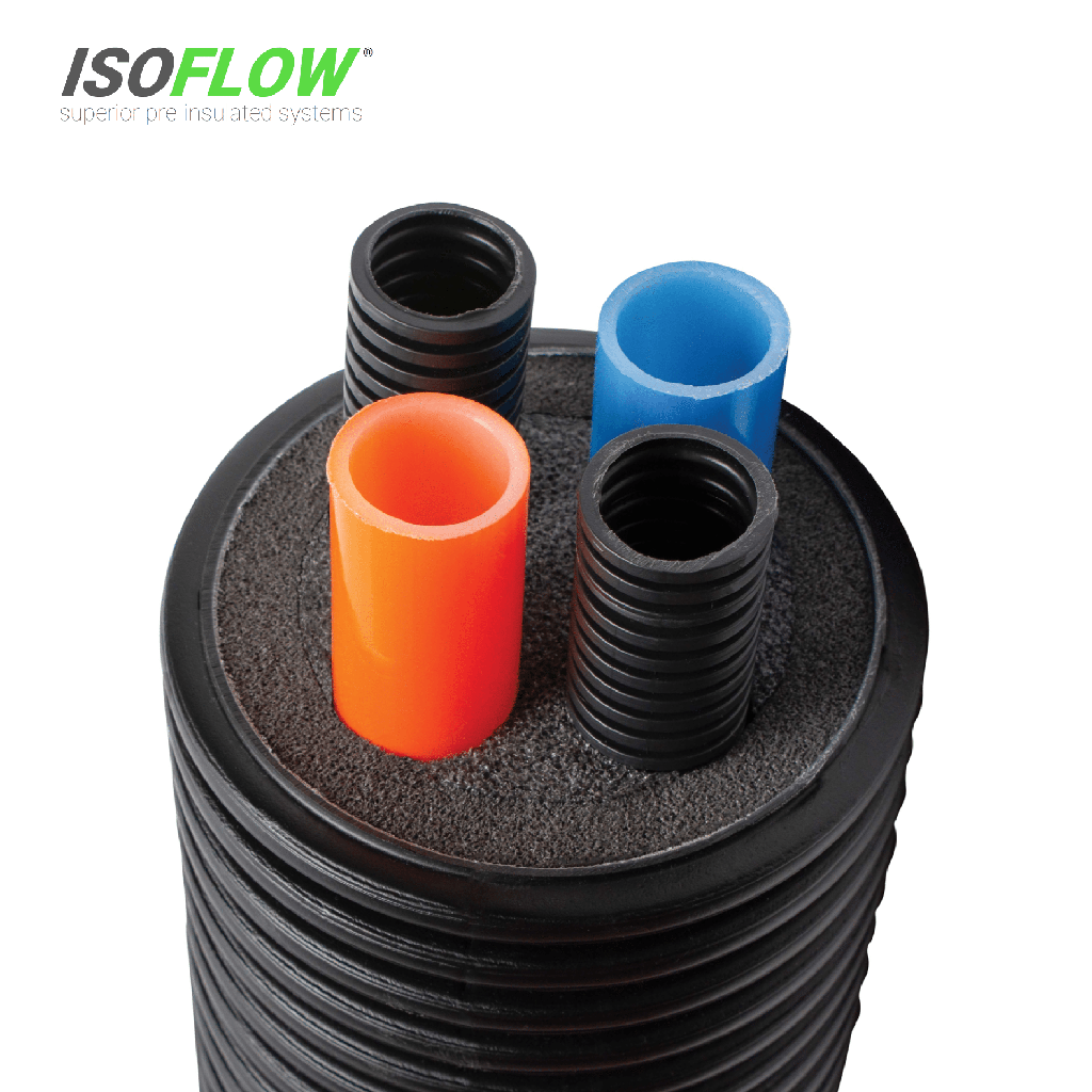

I want to keep the heat pump as far away as possible from the house so I’ve requested that the unit is installed in the garden, roughly 10m away. The pipework will be buried up to the house, where it will then run up the side and into the first floor or the loft. Is this a wise decision? How will this run affect flow temp?

I’m new to the forum having joined only a few weeks ago after having a Heat Geek installation. One of my requests was to have the heat pump wall mounted 6 inches above ground on my garage wall, approx 4 metres from the house wall.
I had my local gardener dig a 6m x 1m x 1m trench from the heat pump position to the house to accommodate a multi-bore pipe
In the end 2 single runs were used because of stock issues. These products have exact heat loss charts available so the flow temperature loss will be known to the installer. I would suggest you’ll see more loss on the above ground piping going up the exterior wall to the entry point. As long as industry standard piping and insulation are used, these should be negligible.
I would note that these pipes are not very flexible, so haveing a deep trench will make the transitions to copper piping easier.

Oh, I do not think CB will design with a 10m run between ASHP and hot water tank. 10m is the maximum specified by, for example, in the Vaillant installation manual. A long pipe run like that, I think, will hit efficiency but if it is designed carefully with few 90deg bends it should work OK.
Anyway, I believe none of the big players like BG, EDF, Aira, Octopus will do accept 10m. They will push you to have the ASHP closer to the house.
Anyway, I think CB have several designers in their team and I would suggest you keep a close eye on the design details and heat loss calculation.
