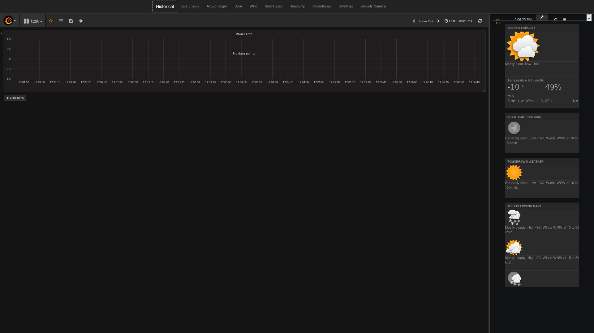

**Author:** ![stephen](https://community.openenergymonitor.org/user_avatar/community.openenergymonitor.org/stephen/32/19571_2.png) [@stephen](https://community.openenergymonitor.org/u/stephen)\
**Post date:** [18 November 2017 23:56 UTC](https://community.openenergymonitor.org/t/howto-updated-method-for-freeboard-iot-interface-with-mqtt-node-red-for-emontx/5662/3 "2017-11-18T23:56:38Z")
![paymentAck7](https://community.openenergymonitor.org/uploads/default/original/2X/5/5c28d30db70cdd9907adc44f47a9b899e02a65c4.jpg)
I modified the freeboard IOT it now starts up with multiple tabs and a fixed pane for weather information ( or what ever data you wish to place in there… I also incorporated grafana into the web interface under the historical tab. the other tabs are for live data from iot devices and switch controls. plus security camera has being integrated using VXplayer if using chrome browser
it uploaded at github
[GitHub - krywenko/Freeboard\_multiple-tab](https://github.com/krywenko/Freeboard_multiple-tab)
git clone https://github.com/krywenko/Freeboard_multiple-tab.git
**Post date:** [20 November 2017 00:52 UTC](https://community.openenergymonitor.org/t/howto-updated-method-for-freeboard-iot-interface-with-mqtt-node-red-for-emontx/5662/4 "2017-11-20T00:52:27Z")
well got most of it configured and working fine though for some reason my navigator bar works fine on my computer in chrome firefox opera and others but on windows computer it has an issue . I believe the errors in the header.html – have to retool some IOT devices or figure out how to translate json to the new way they they take input on influx
some basic images
frontscreen - displaying live data streams
 ![freeboard3](https://community.openenergymonitor.org/uploads/default/original/2X/a/a00f217fc7ec8e6ce60a662863bdecffed9a6db6.jpg)
historical data
 ![freeboard2](https://community.openenergymonitor.org/uploads/default/original/2X/0/0f95012376314ebba6cce37f380de00990f524ee.jpg)
netdata for pi data
 ![freeboard1](https://community.openenergymonitor.org/uploads/default/original/2X/a/a99b8bf578cb4f519ce08ac665bb62f586d7ff78.jpg)
security camera firefox and other Browsers
 ![freeboard](https://community.openenergymonitor.org/uploads/default/original/2X/1/11e5f8778ed614a1e10c196a519f19480058b2ee.jpg)
security cameras chrome compatible
 ![freeboard7](https://community.openenergymonitor.org/uploads/default/original/2X/c/cd9c9671d7121ec26e0a223cf5e2ae1afcb7a30b.PNG)
