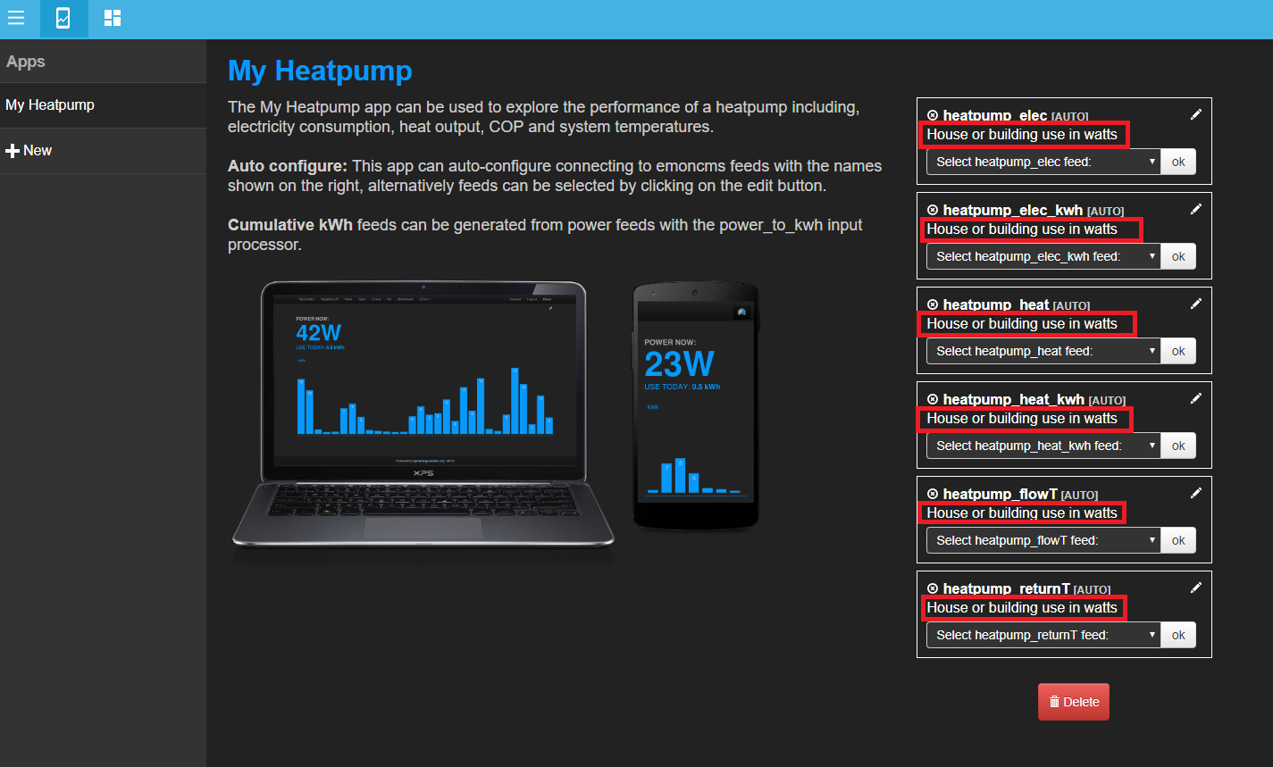

How to use the HeatPump Module
add the app as i want to experiment with the heat pump module
is it normal that initial text is repeated?

just seems odd to me
also the fields could use some short explanation, the 2 first i can guess
watts the heatpump use
next is the same but in kw/h
but heatpump_heat is an unknow
heatpump_heat_kwh, what is that?
flowT and return are temps i can guess that, the first must be inlet and the other outlet?

yep, those i guessed, but what about the other ones?
Sorry, I know nothing about the Heatpump module.
If I could find the ESP source code, I could trace it back. But I can’t find that.
or maybe our fearless leader @TrystanLea knows?
No that’s an error.
This is an app and has nothing directly to do with a heatpump, other than to display the metrics normally associated with a heatpump. Those metrics may be sourced from a variety of places, modbus for example, or mbus etc. Or they might just be roughly calculated in emoncms eg if a heatpump has a COP of 4:1 and it is consuming 2kW of electric, it will be pumping out an average of around 8kW of heat (Third metric heatpump_heat) and if it does that for 5hrs, it will have produced around 40kWh’s of heat (Fourth metric heatpump_heat_kwh). Obviously there are better ways of getting this value, the norm is to use a heat meter, which is a sensitive flow sensor with 2 matched and calibrated temp sensors to measure temp in, temp out and flow to accurately determine the heat produced, but very few installs have a heat meter as they are fairly expensive as a rule.
[edit] I’m not suggesting that electricity consumption and heat output are rigidly tied as they are not, due to things like ground/external temps etc. But it can be a reasonable indication. The app is specifically aimed at tracking that efficiency by comparing power used to heat produced, so the app is only fully utilised if a accurate heat value can be sourced. The OEM heatpumpmonitor uses Mbus to get that data from certain (kamstrup?) heatmeters.
