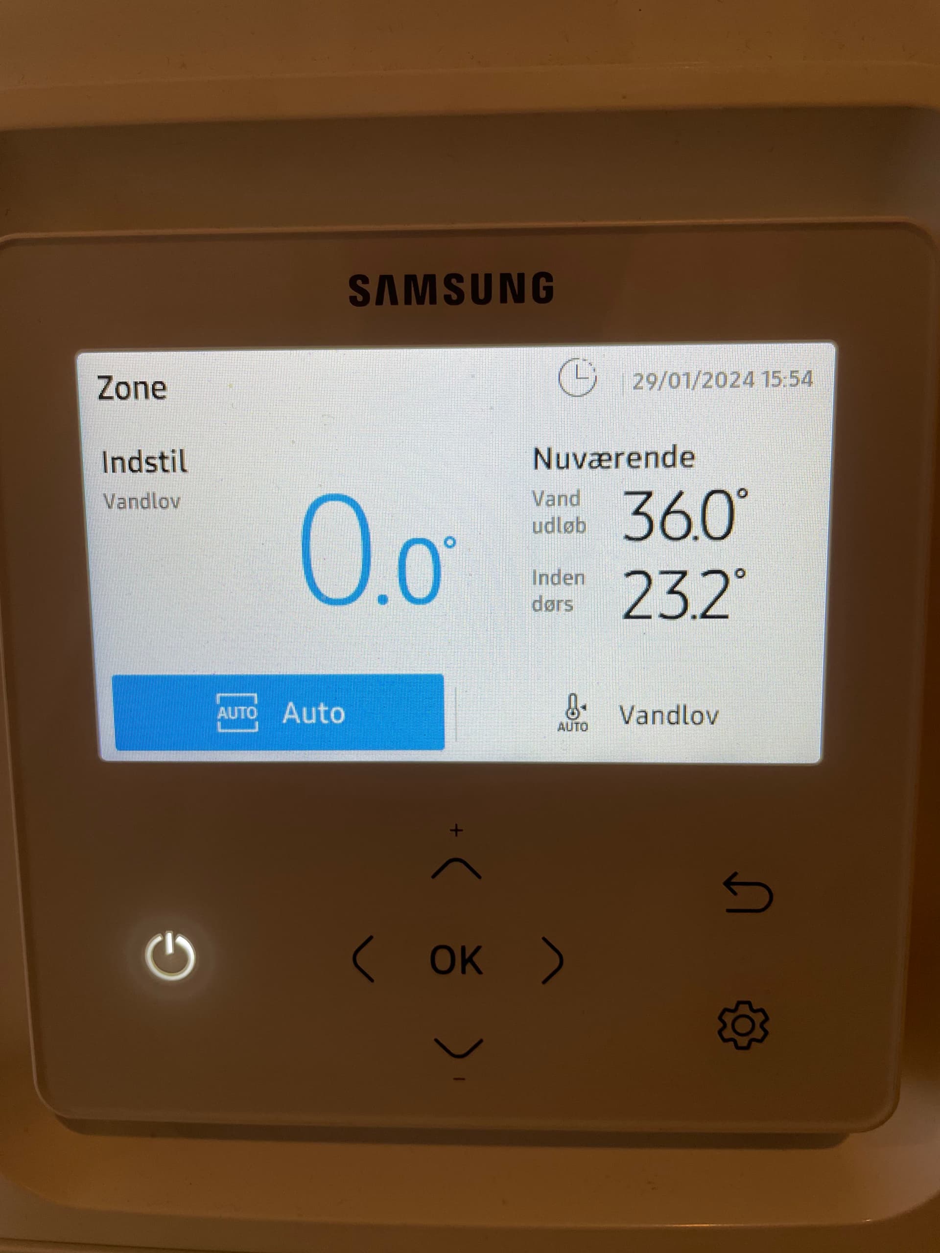

@Madsen68@SarahH it would really help to have some real time LWT / RWT / power graphs to compare rather than just descriptions
> [@Madsen68](#):
> Thermostat is not in use as it is set up - not 100% sure though, as I write this I get uncertain of this…
> If I remember correct, the only thing that controls the cycling is sensors on the flow and weather temp.
> I could be wrong though…
I’m confused now. please post a photo of your controller.

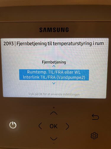

**Author:** ![Madsen68](https://community.openenergymonitor.org/letter_avatar_proxy/v4/letter/m/a3d4f5/32.png) [@Madsen68](https://community.openenergymonitor.org/u/Madsen68)\
**Post date:** [29 January 2024 14:46 UTC](https://community.openenergymonitor.org/t/how-to-reduce-cycling/25251/72 "2024-01-29T14:46:19Z")
@Ian_Calderbank
Guess you are right - @SarahH wrote it is in fact a part of the controlling system - I was not aware of that factor… My bad…
This is the one…
 ![Skærmbillede 2024-01-29 kl. 15.45.49](https://community.openenergymonitor.org/uploads/default/original/3X/d/2/d2ab945b262c4ab35809e7f9296cc0203c8be889.jpeg)

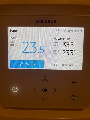

**Author:** ![Ian\_Calderbank](https://community.openenergymonitor.org/user_avatar/community.openenergymonitor.org/ian_calderbank/32/24687_2.png) [@Ian\_Calderbank](https://community.openenergymonitor.org/u/Ian_Calderbank)\
**Post date:** [29 January 2024 14:47 UTC](https://community.openenergymonitor.org/t/how-to-reduce-cycling/25251/73 "2024-01-29T14:47:03Z")
🙂 not an example of the controller
your ACTUAL controller. to show me what mode its in.

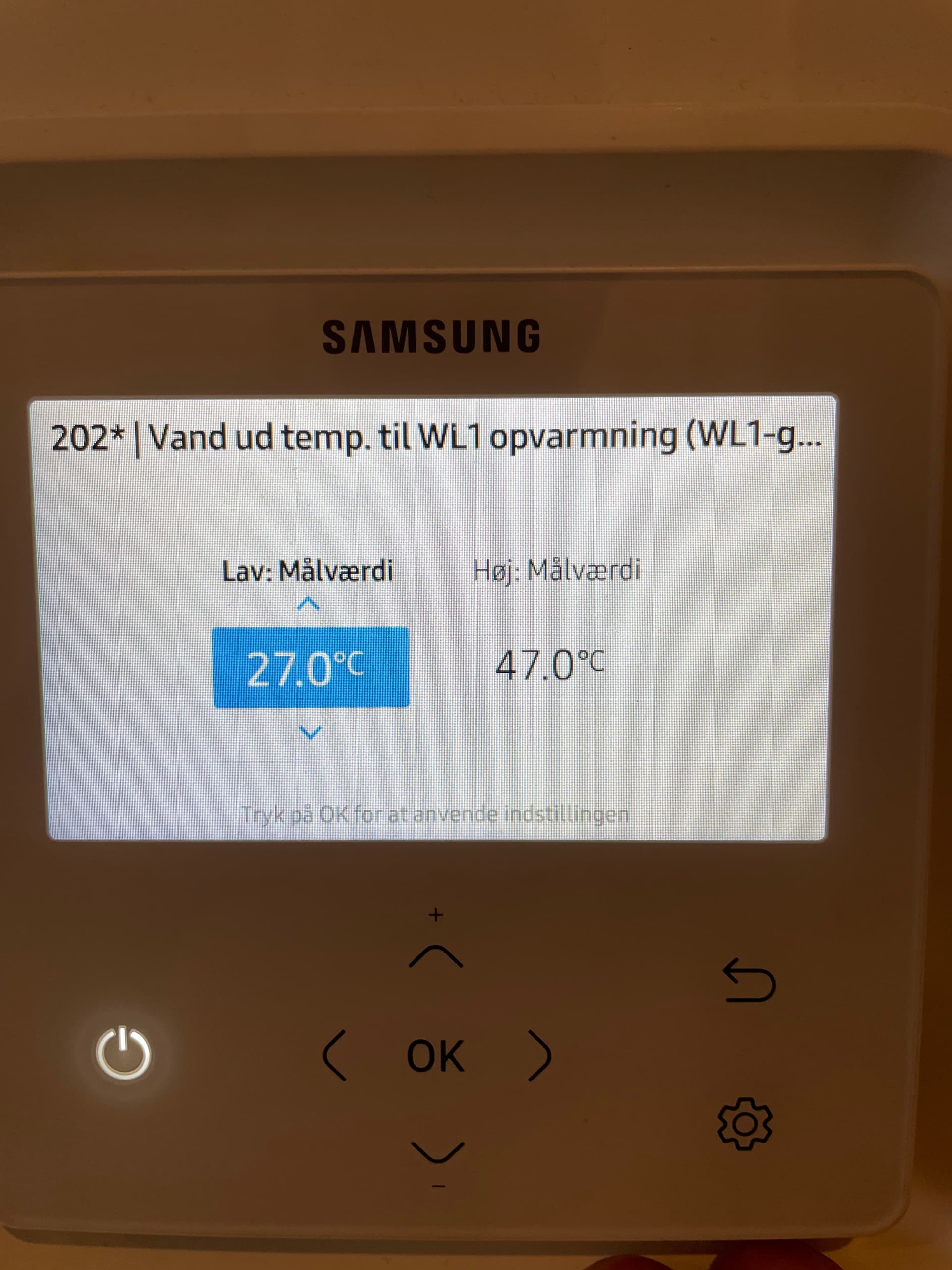

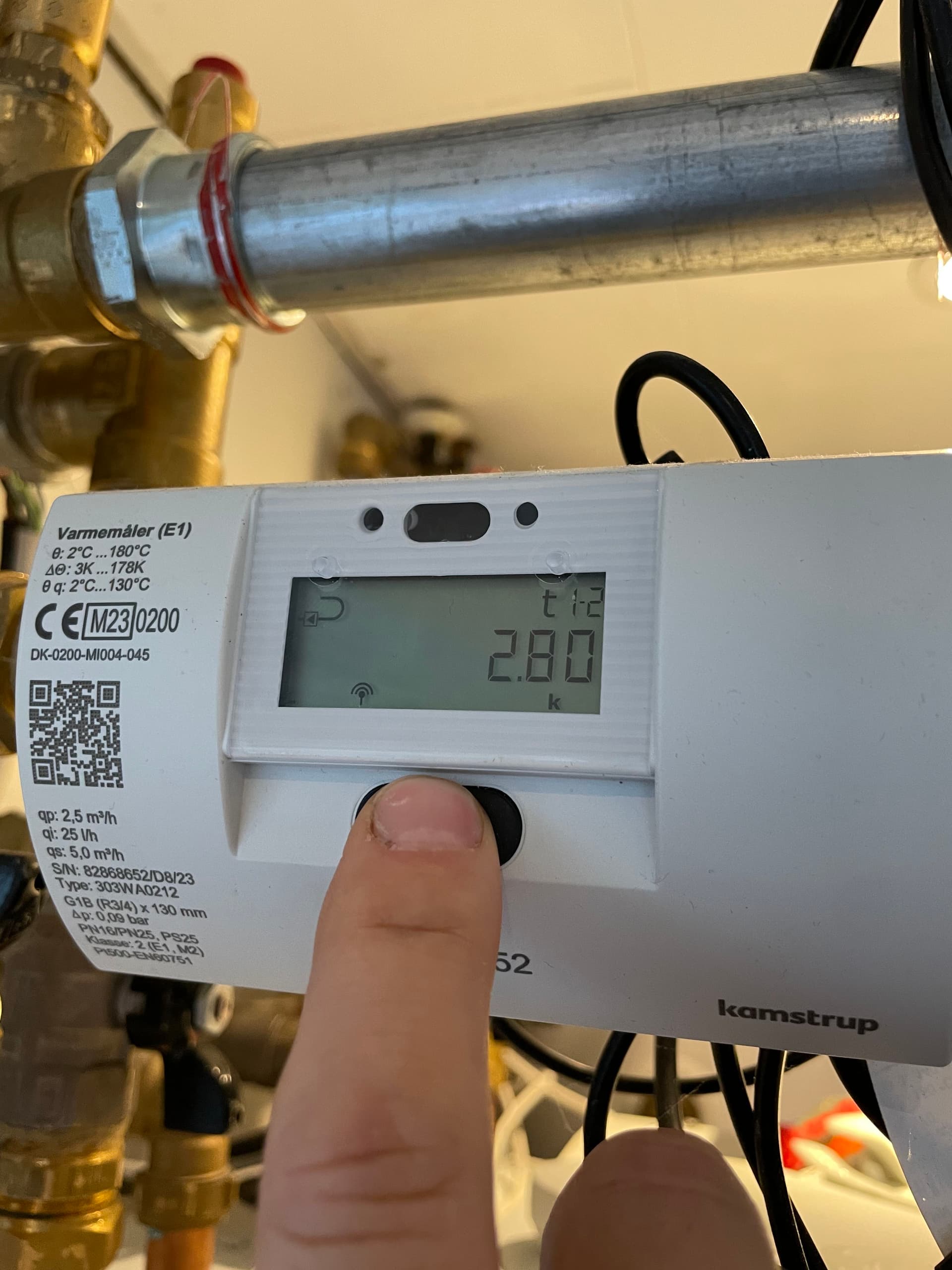

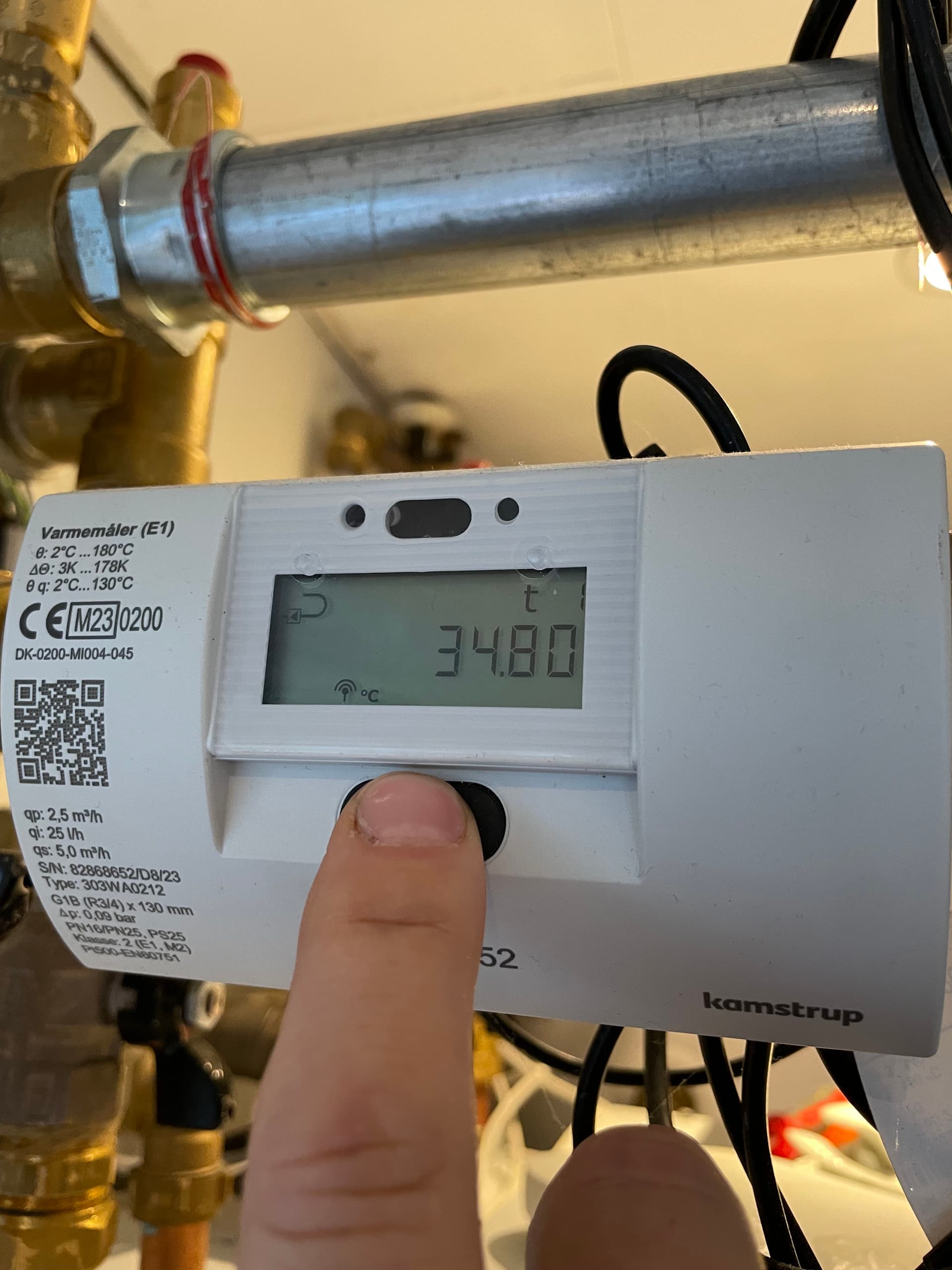

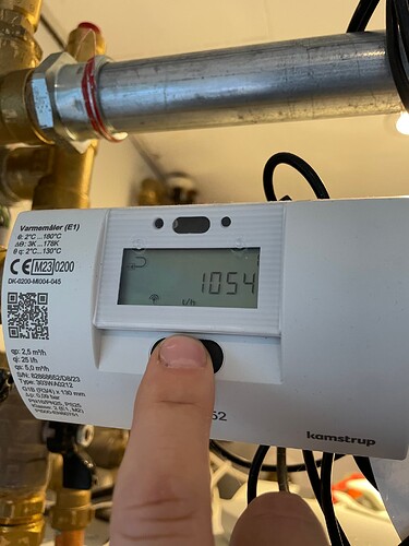

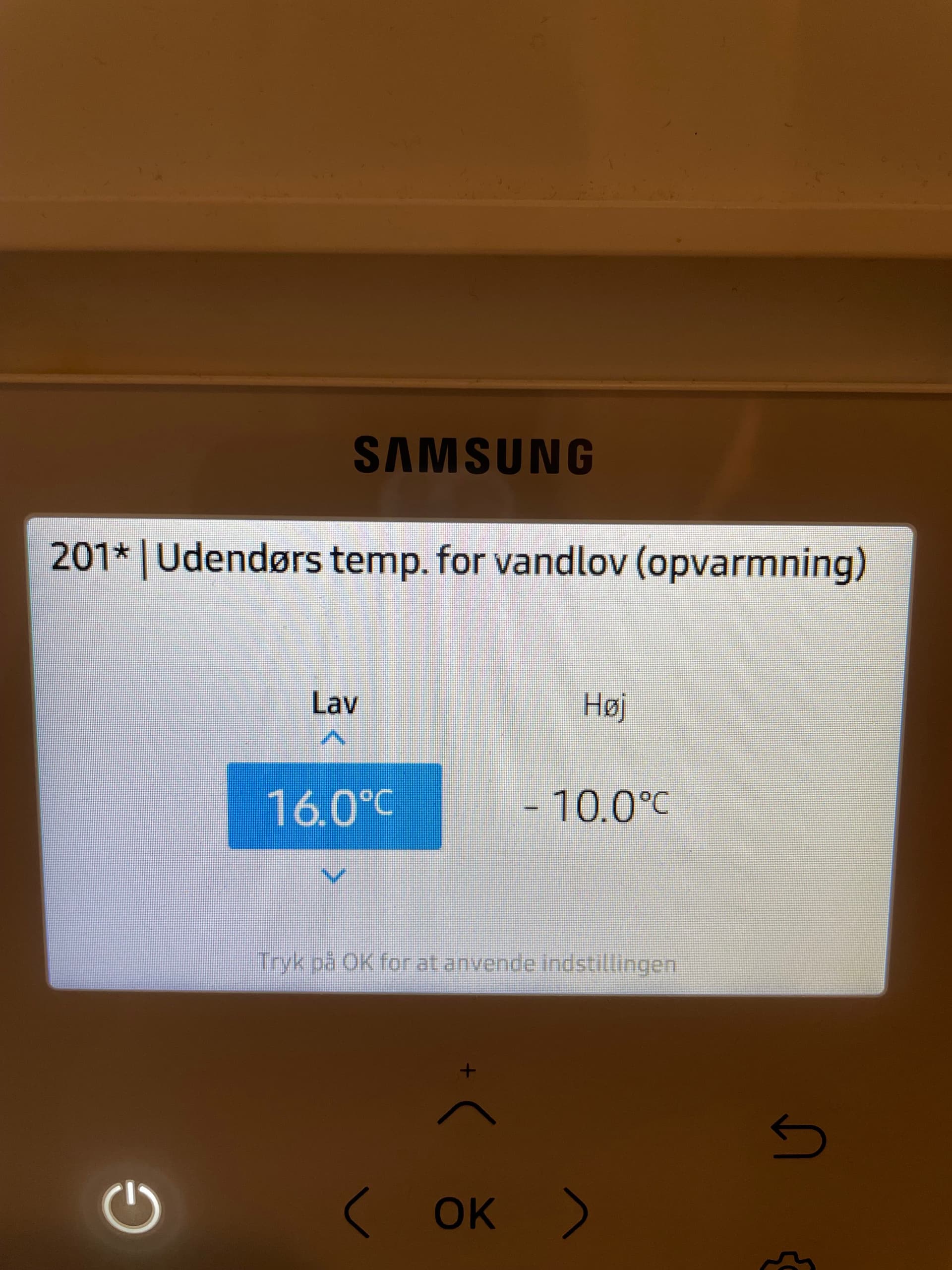

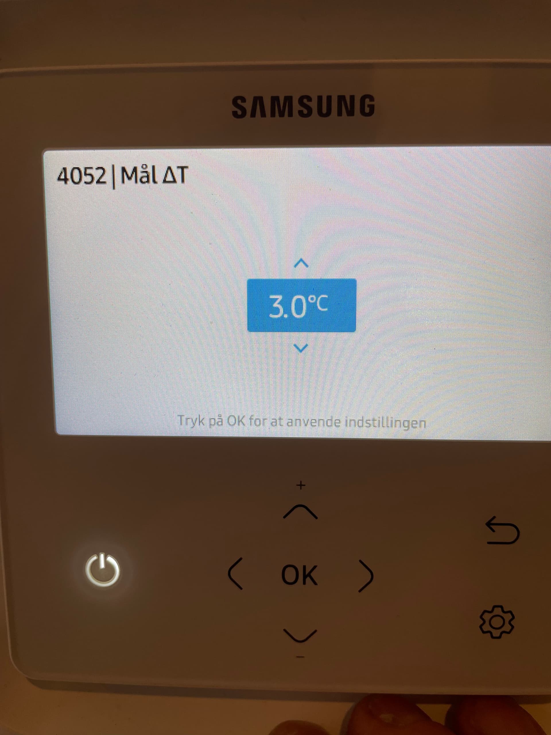

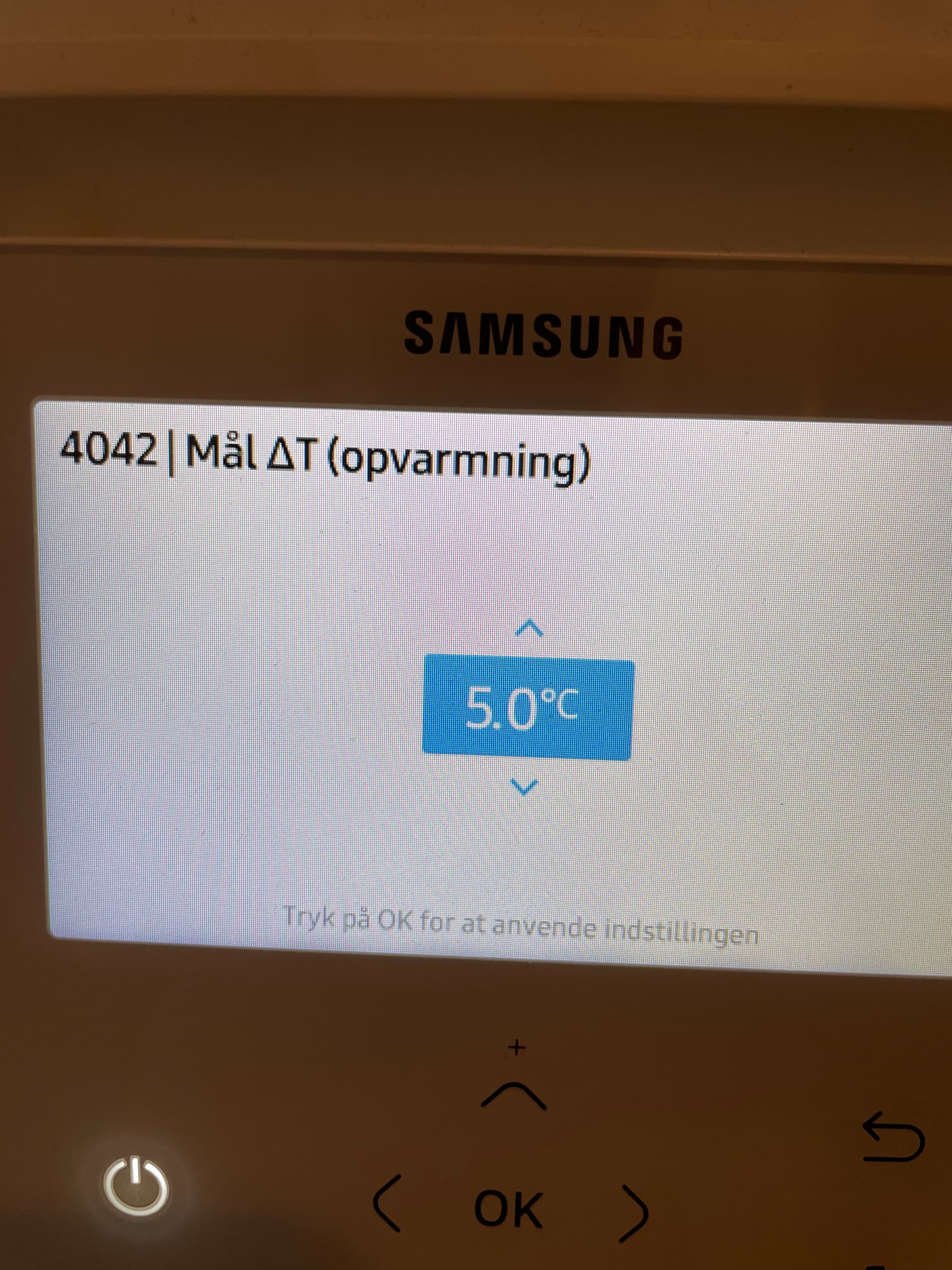

**Post date:** [29 January 2024 15:08 UTC](https://community.openenergymonitor.org/t/how-to-reduce-cycling/25251/75 "2024-01-29T15:08:48Z")
LOL - sorry m8
@Ian_Calderbank
I have no datalogger to show everything - would love to have the emon - anyway here are some pics.
A bit confused around 4042 /4052 Target dt

Flow temp

Current dt

Liters per HOUR

oh my this seems like quite a basic issue. you are running with the controller in the mode that would be normal if you had an external thermostat. but you don’t, right? that means, nothing is telling the system ever to switch off. the only thing its trying to do ever is keep the WT constant based on the number in the WL settings. any tiny drop in WT, it comes back on. no wonder it’s cycling.
Is the controller in a place where you can use it as a master thermostat ?
if yes
service mode-\>indoor unit options-\>standard temperature-\>indoor
expect to get some error messages when you change this but if you press off-\>on on the controller it’ll sort itself out.
if no
move it or get an additional thermostati.
**Post date:** [29 January 2024 16:27 UTC](https://community.openenergymonitor.org/t/how-to-reduce-cycling/25251/78 "2024-01-29T16:27:58Z")
Hi Ian
> [@Ian\_Calderbank](#):
I would dought it is a good place to use as Room stat - it is our Utlity room where I have Floorheating, so a kinda long time before temp drops in there, compared to living room with emitters.
I will move the controller in there - no problem.
here is how it is after changing to “Indoor”
 ![IMG_8743](https://community.openenergymonitor.org/uploads/default/original/3X/0/9/09bb25c594e13c74c16ce4e12140a1db9166a49f.jpeg)
**Post date:** [29 January 2024 17:02 UTC](https://community.openenergymonitor.org/t/how-to-reduce-cycling/25251/79 "2024-01-29T17:02:26Z")
ok, looks good. so now if you reduce the target temperature with the ± buttons it should start to control it.
its two wire cable, low voltage so easy to move.
