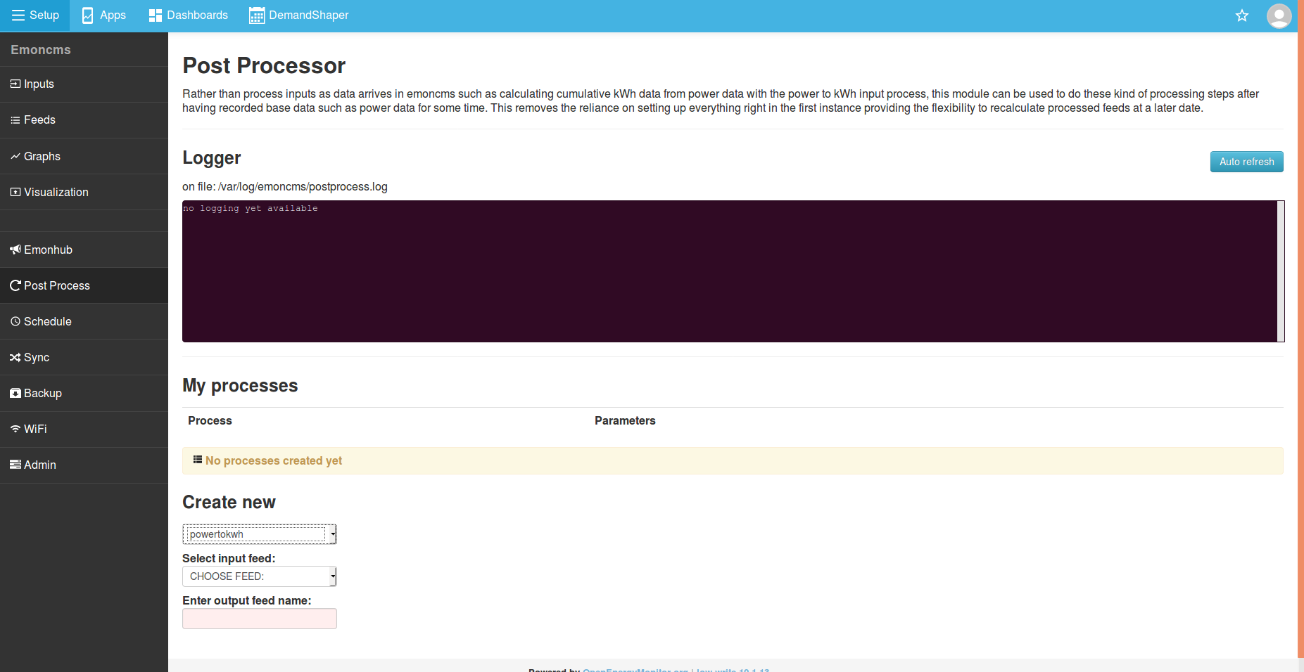

Hello @OlavKristiansen
Yes there is a tool called the post process module, you can select a source power feed and recalculate a kWh feed from this, you can find the post process module in the setup menu:
Thanks, I already tried that. It calculated all samples correctly and within a fraction of a second. But the new feed did not “come alive”, it calculates up to now only and stays there until you click “calc” again. And it creates a new feed, it does not recalc the old one.
Or have I got it all wrong?
Ok, so I may have misunderstood here. In the field “Enter output feed name” I did not dare enter an existing feed. But that may very well be the main purpose, is it? Just wanted to check with the experts before doing something entirely wrong.
Thanks for correcting my slightly embarrassing typo…English is not my native language…
Hello @OlavKristiansen, yes one more step after post processing is to recreate the input processing and link it to the new feed, so that it continues to update.
Ok, I got that working, thanks.
