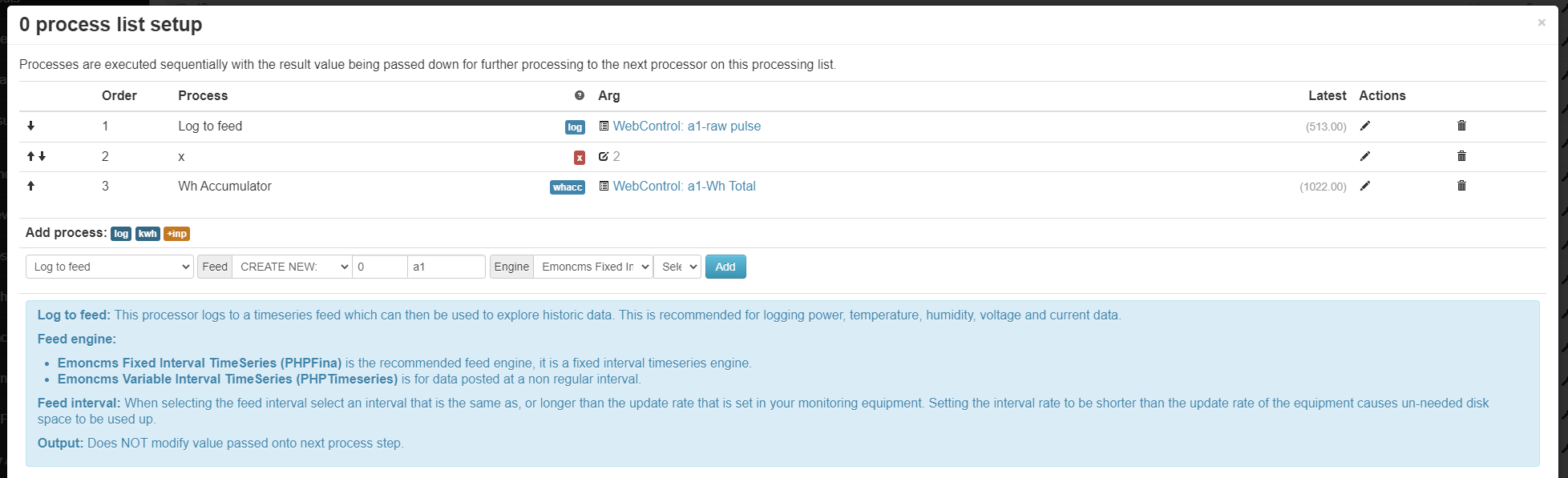

Hi Robert
i am still confused on this documentation i found for setting up pulscounter (and Wh Accumulator- although the docu talks a bout KWh Accumulator). Not very clear docu.
I have severa pulse-counters with 1000pulses/kWh and 2000pulses/Kwh.
the number of pulses arrive and i see the lines raising but this makes all no sense for me.
my understanding is that this emoncms should count the pulses arrived within one hour and then divide this with 1000 or 2000 to calculate the KWh.
so there is no process in feeds which can divide.
and the docu just says:
- raw pulses
- multiply with ??? (no clue why they multiply with 1.25 but ok)
- accumulate Wh (although they are talking about Kwh accumulator).
And the rest is nice but makes no sense in the dashboard (despite that this Graphs have a lots of bugs - and you need to step out and in again for correct graphs).
i am lost with this tool emoncms
i think it makes more sense to multiply my counts with 0,001 (1000) or 0,0005 (2000) to get kWh.
It would realy help if someone shows me correct inputsetup and graph setup for a simple power meter with s0 pulse logging with clear understandable description.
Big Thnx
Alex

at the moment i followed the documentation.
first log feed to get the counter values
then multiply with 1 or 0,5 (1000 or 2000 pulses per Kwh)
then i used the Wh accumulator
or should i use the kwh accumulator as you explained.
whats the difference between Wh accumulator and KWh accumulator in accordance to the pulse value (because multiply 1 or 0.5 is irrelevant for this feeds) ?
will try one counter with your settings:
- log feed raw value
- 0.5 (as this counter has 2000pulse/kWh)
- kWh accumulator
- kWh to kWhperDay
lets see what happens

hi @Robert.Wall
ok i now used the Wh accumulator and stacked all counters and scaled them with 0.001 which nearly gives me correct used kWh per Day
all the others kWh accumulator showed strange numbers and even the Wh to kWh/day doesnt work correctly
this is now my result
