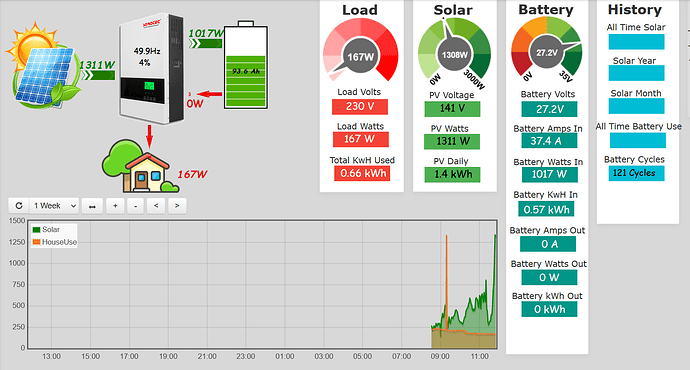

Hello,
New to all of this, so forgive my dumb questions.
I’m trying to use a self hosted instance of emoncms. Capturing data from my inverter and battery with some scripts.
Got the setup to a point where for example i have 2 feeds for solar production
Log to Feed
Power to kWh
These data do not survive a reboot of my Raspberry Pi
I’m trying to have a setup where i can have feeds for
Daily Solar
Monthly Solar
Annual Solar
All Time.
Feed data that will survive restarts or reboots ot anything going wrong.
ALSO
I have Battery data from my DIY bank
Battery watts in
Amps in
Battery Watts Out
Amps Out
Remaining Battery AH
I’d appreciate a guide on how to get Battery SOC from these data feeds
Thank you

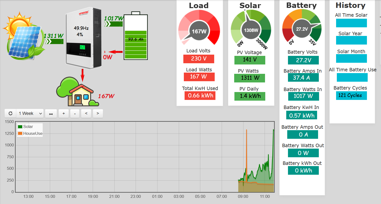

This is what i currently have.
I have a dashboard setup to display these feeds

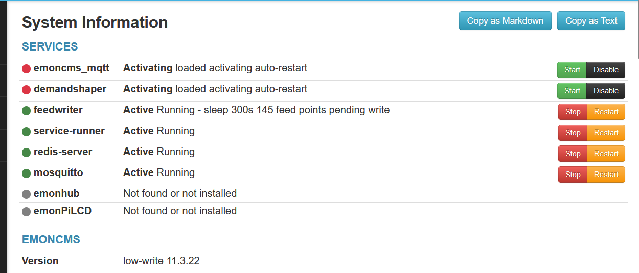

Is this a standard setup on a Pi?
Go to admin and see what the Services say especially feedwriter
Ashipa
(AshipaEko)
31 August 2023 09:57
5
I found that feedwriter was red, so i tried to reinstall. there was an error message with mysql which i solved by installing php-mysql.
This is what i have in there now. feedwriter is now green

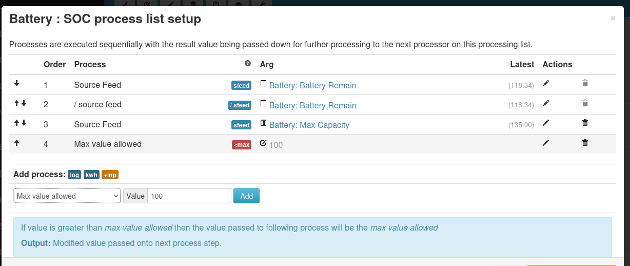

Isn’t Battery SOC = Remaining Battery AH / Battery Capacity AH?
Ashipa
(AshipaEko)
1 September 2023 18:54
10
sadly i am completely clueless about how all of these work.
I’ll appreciate a screenshot or some sort of guide. I’m guessing it’ll be a virtual feed like this?
