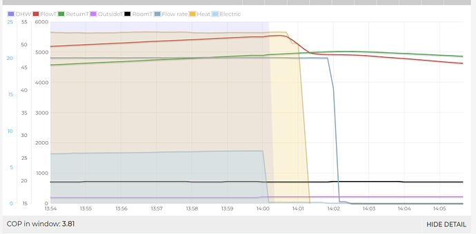

Interesting, the flow and return do converge at the end. Looks to me like:
1. Compressor turns off at 14:00
2. Time lag for just over 1 minute as 20L/min flow rate travels along the 16L on each leg of the primaries.
3. Flow and return converge at around 90s
4. Central heating pump turns off at 14:02
 ![image](https://community.openenergymonitor.org/uploads/default/original/3X/d/d/ddeb6dcab3fa5974bf9f8a518afb60982eaea83d.png)
My thinking is that the heat meter is measuring the heat transferred from the point of the heat meter onwards but happy to be proven wrong. I wonder if an extreme example would illustrate this?

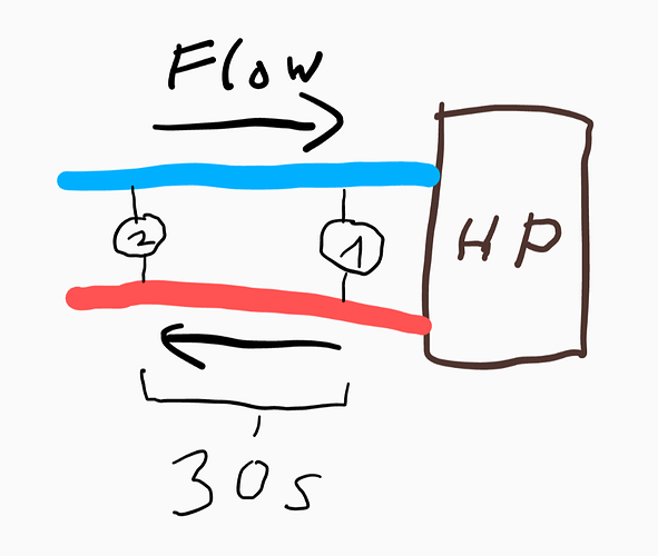

That’s correct and we don’t disagree on that. The heat must have passed the heat meter to be registered by it. If it sits “down the road” there will be a time delay until all heat generated will be registered. When the compressor is turned off, the pump needs to be on until the water heated passes the heat meter. No matter where the heat is generated (far away) it is always transported through the heat meter by the circulation pump.
For your example, I think the meter would register the full 18.4 kWh. My thought experiment goes like this:
Imagine you have a very large (infinite) reservoir supplying cold water to a heat pump (blue), which can heat this water up (red). You have two heat meters, 1 and 2, which are separated by a length of pipes. The flow rate is such that a bolus of water takes 30s to travel from 1 to 2. You now turn the heat pump (it could also be just an electrical heater) on for 10s. Heat meter 1 measures a certain dT for 10 s and a corresponding amount of heat. Heat meter 2 measures the same dT for 10s, just 30s later. For continuous operation this also stays true - all measurements are just delayed. It’s only important that you pump long enough to have all heated water reach the meter
 ![Screenshot_20240916-153711](https://community.openenergymonitor.org/uploads/default/original/3X/2/2/22b236e8bb40a9bde1e720d8ec614c412a8bb05b.png)

Yes, I would just have a simple series of connected pipes with discrete volumes and associated heat capacities (no branchings in the first step). Each segment could have an individual length/volume and a heat source attached, or alternatively a heat sink (flow temperature dependent, like a radiator). Then I would just timestep through the system, moving the water through the connected system and receiving/emitting heat as per the source/sink definitions. To properly model real life behavior, some form of mixing would have to happen as well I think, so that short bursts of heat delivery don’t move as small discrete blocks through the system.
