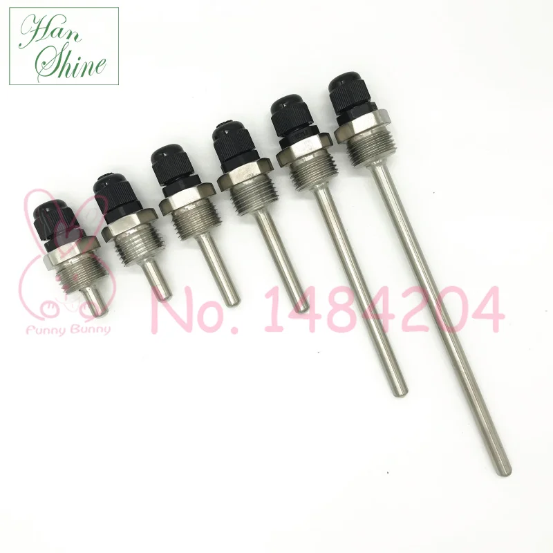

If anyone is interested, I got some 7mm ID brass tube from ebay and drilled and brazed into 3/4 BSP blanking plugs. I replaced elbows on my tank with T pieces and my new ‘immersion tube’ extending into the tank. Then a bit of heat transfer paste and a DS18B20. See photo…
 ![image](https://community.openenergymonitor.org/uploads/default/original/2X/0/05a882cba8a97bd419c1c7b41d5264007b5a9d72.jpeg)
**Post date:** [15 February 2019 08:41 UTC](https://community.openenergymonitor.org/t/hot-water-tank-temperature-monitoring/10017/29 "2019-02-15T08:41:50Z")
Or you can just buy a [sensor pocket](https://www.jtmplumbing.co.uk/pipe-fittings-c433/temperature-pressure-gauges-c445/jtm-pipeline-brass-sensor-pockets-p19410). 😄

I searched everywhere to find an immersion sleeve and could only find one at a solar hot water supplier, who wanted forty bucks each. Re: your link - hmmm… GBP71 for two delivered - I think not. I’ll stick to mine @ AUD7 each.
**Post date:** [15 February 2019 09:57 UTC](https://community.openenergymonitor.org/t/hot-water-tank-temperature-monitoring/10017/31 "2019-02-15T09:57:56Z")
The trick is using the right search term. Search for ‘sensor pocket’ - turns up loads of results here in UK.

Or use AliExpress
> **[2.32￡ 23% OFF|50 250mm Stainless Steel Thermowell 1/2" NPT Threads For...](https://www.aliexpress.com/item/32848374679.html?spm=2114.10010108.1000014.1.7c517118MQMs1o&gps-id=pcDetailBottomMoreOtherSeller&scm=1007.13338.106568.000000000000000&scm_id=1007.13338.106568.000000000000000&scm-url=1007.13338.106568.000000000000000&pvid=a59c4ea7-28ac-4765-bc29-a9dec1ebfbca)**
> Smarter Shopping, Better Living! Aliexpress.com
> **[6.8￡ |Thermowell G1/2 inch solar water heater temperature sensor probe for...](https://www.aliexpress.com/item/32881877857.html?spm=2114.10010108.1000015.3.7c517118MQMs1o&scm=1007.14452.124579.0&scm_id=1007.14452.124579.0&scm-url=1007.14452.124579.0&pvid=4dd3a103-a277-4843-af65-4be29eef80d5&s=p)**
> **[5.54￡ 3% OFF|Stainless Steel Thermowell OD=7MM ID=5.9MM BSP 1/2 Thread Probe...](https://www.aliexpress.com/item/32856089184.html?spm=2114.10010108.1000013.2.7c517118MQMs1o&gps-id=pcDetailBottomMoreThisSeller&scm=1007.13339.90158.0&scm_id=1007.13339.90158.0&scm-url=1007.13339.90158.0&pvid=91acee84-b43d-4a45-931e-de52a6e5c31e)**
Or even with a ds18b20 already fitted
> **[8.72￡ 3% OFF|DS18B20 Digital Temperature Sensor BSP G1/2" Thread 20 50 100mm...](https://www.aliexpress.com/item/32811388557.html?spm=2114.search0104.6.3.84d14b20kE8k2P&s=p)**
I’m certainly not wanting to take anything away from your ability and achievement @EnergyX, I think its great to be able to knock this stuff up yourself, but for those that lack the ability, tools, parts or time to do so, a ready made solution might be easier so even a general DiYer can still get the job done too.
**Post date:** [15 February 2019 10:44 UTC](https://community.openenergymonitor.org/t/hot-water-tank-temperature-monitoring/10017/33 "2019-02-15T10:44:47Z")
Ah **Thermowell** , that is a good search term!
Those prewired ones are absolutely perfect!

If you have a standard glass-lined steel tank, I would suggest caution using even stainless steel thermowells and would not use one made of brass/copper. Electro-galvanic corrosion will occur at a faster rate, which will reduce the life of your tank.
My heat pump water heater has its own sensors so I just get the data from it. My other heater has its own sensors too, but I have not tapped into them yet and may just use the external sensor under the insulation. It will have a delayed and muted response, but will probably be good enough.
**Author:** ![Bill.Thomson](https://community.openenergymonitor.org/user_avatar/community.openenergymonitor.org/bill.thomson/32/1834_2.png) [@Bill.Thomson](https://community.openenergymonitor.org/u/Bill.Thomson)\
**Post date:** [16 February 2019 18:58 UTC](https://community.openenergymonitor.org/t/hot-water-tank-temperature-monitoring/10017/35 "2019-02-16T18:58:26Z")
> [@Frogmore42](#):
He should be OK with Stainless. I use SS hardware on _Aluminum_ PV module frames
and after six years in the weather, haven’t seen any corrosion yet.
Few “commonly found around the house” metals exhibit EG corrosion characteriastics like AL.
_Edit -_ Agree with brass/copper being a definte _do not use with a Steel tank._
**Post date:** [16 February 2019 19:33 UTC](https://community.openenergymonitor.org/t/hot-water-tank-temperature-monitoring/10017/36 "2019-02-16T19:33:43Z")
> [@Frogmore42](#):
That depends on your geographic location. UK tends to be SS or Copper for the tanks. Solar tanks tend to have the wells factory fitted rather than leaving a blank boss.
I’d only use these via a Tee inserted in the pipe at an appropriate point.
YMMV
