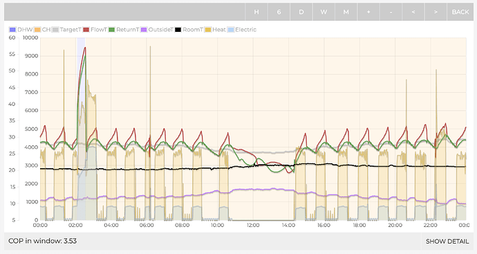

By the way, an “expert” (compared to moi) on here @chrisg runs an automation that I also adopted and he observes no cycling at these low temps - according to his ESP monitoring feedback , correct me if I’m wrong chris?

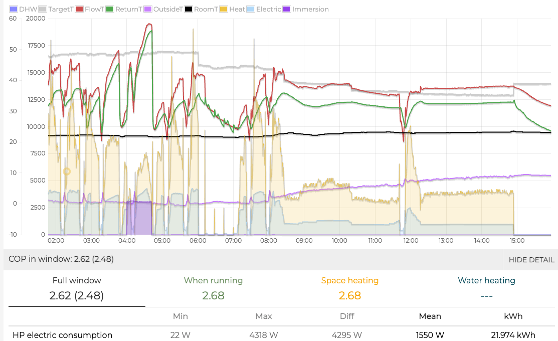

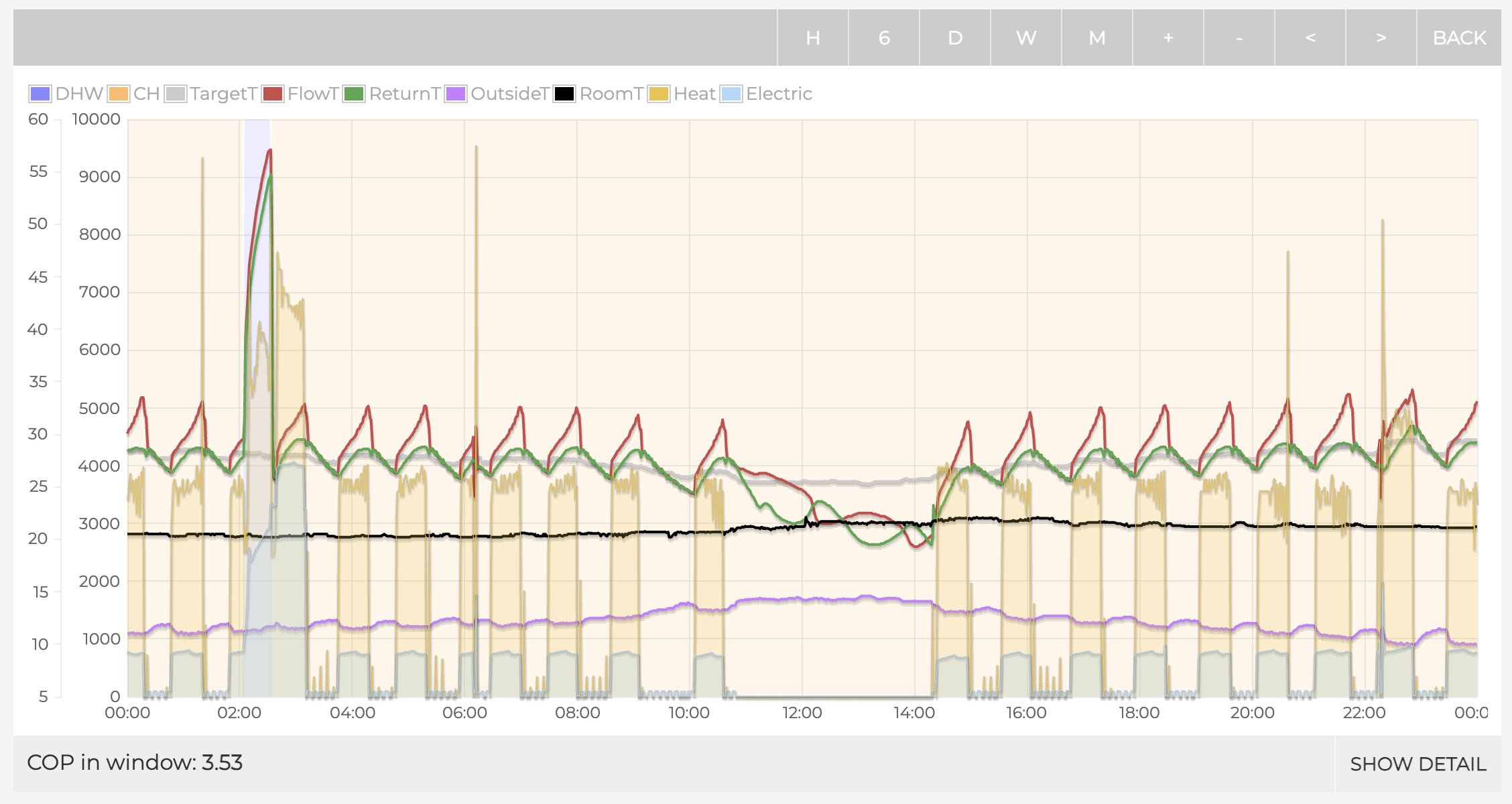

I do get some cycling of the heat pump below 30c LWT but it’s not rapid. Yesterday daytime, sunny spells and mild, it’s heating for about 15 minutes, sampling periodically for 45 minutes. It’d be better if I could have the 8kw unit though. Still waiting on Octopus reviewing my data.
Would it be better to run at min LWT 30c and have the heat pump heating for, say, 30 minutes then off completely for 2 hours? Maybe I should try that some day but a) the Madoka won’t do it in RT mode - the house will simply overheat and b) I want to reduce reliance on the cloud API as much as possible which means reducing the number of times on/off is requested from Home Assistant.

That’s not my experience, Ben. Take a look at my graph above. You can see that it never has high input power draw when restarting the compressor at low flow temps. After 45 minutes of sampling, the compressor starts up at its lowest power draw.

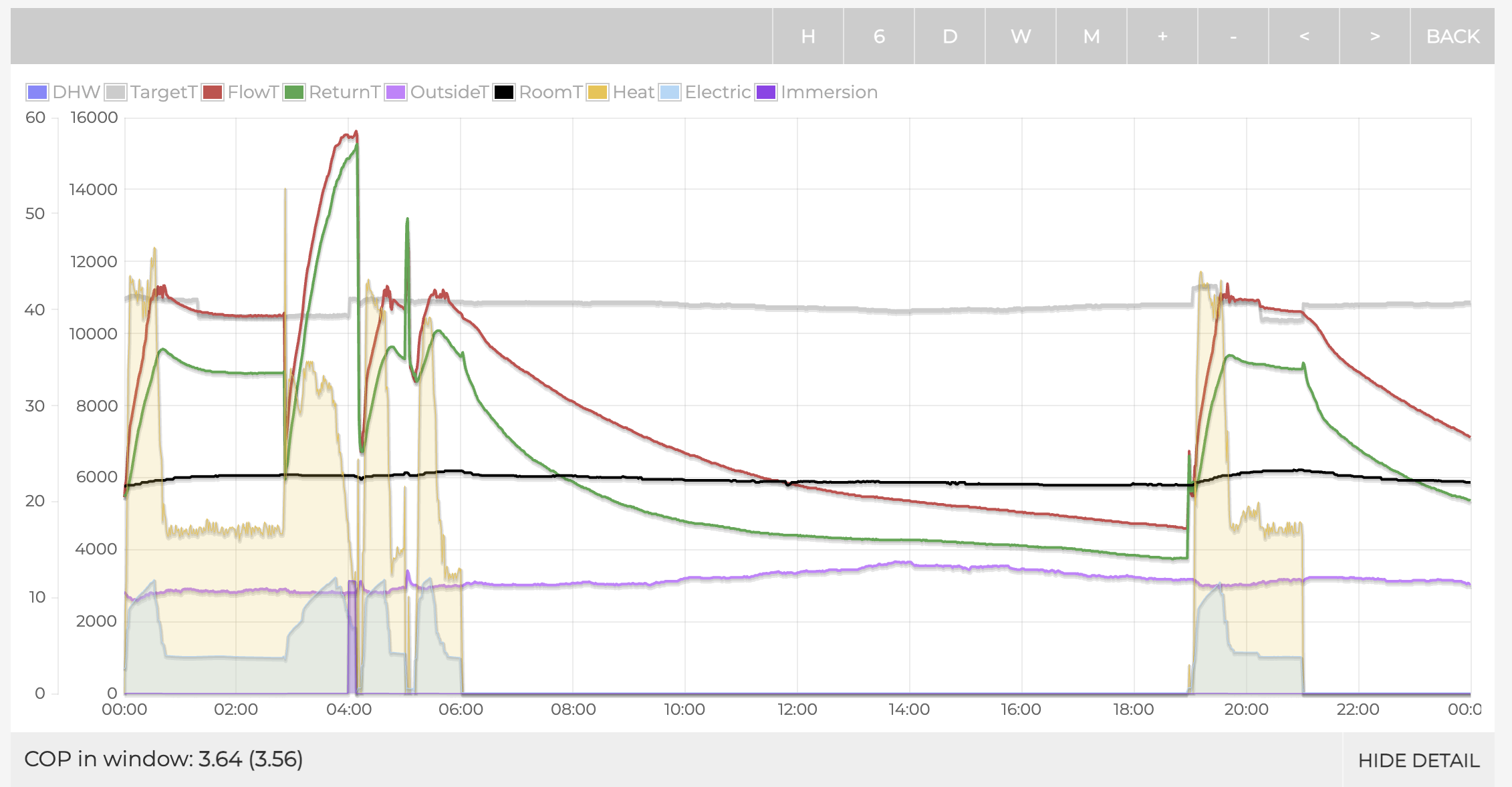

The only time I see a high input power draw on startup is if the requested flow temperature is much higher than the current flow temp - I’m seeing this more now the heat pump is off overnight due to the milder weather:
It settles down within about half an hour.

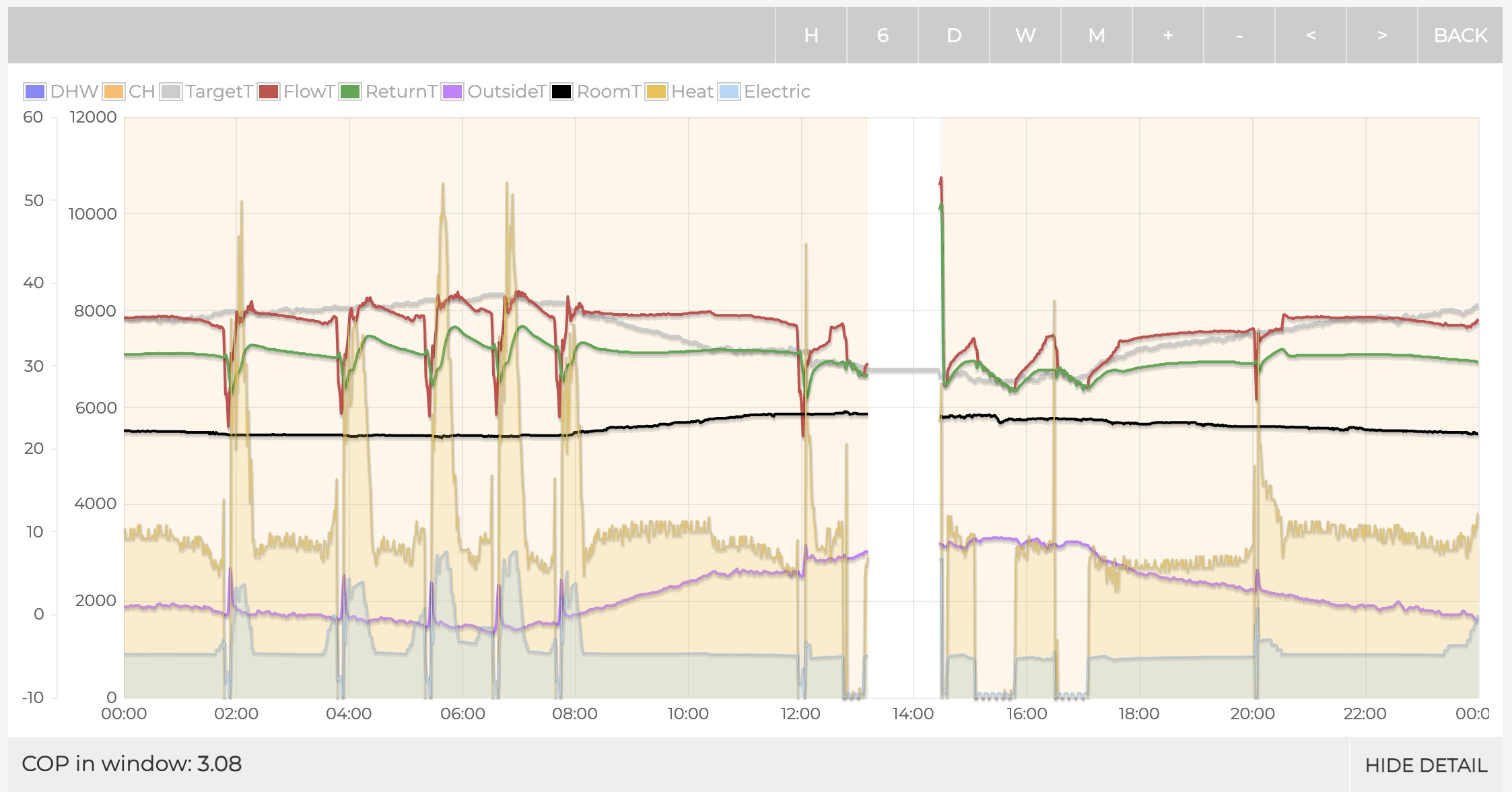

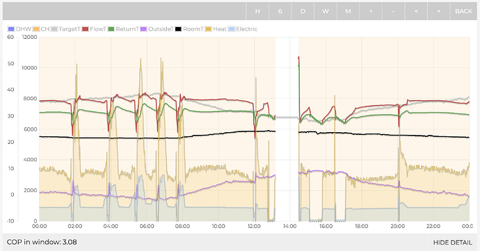

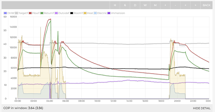

Hi @tims24! Looking at your data for 21 Feb, a relatively warm day when I’d expect cycling, and comparing it to my 9kW on the same day…
  • Outside temp is about the same
  • My target LWT is 25-28C, which obviously is too low for the rads to handle, so the HP gets too hot and cycles - great, that’s what I want
  • Your target LWT is around 40C! And it has some 2C steps in it - is that programmed by you - at 1.17-, 4.00+, and some +/- 19.00-21.00
  • My HP cuts off at 14C outside temp, as that’s how I’ve set it
  • It’s a Friday, so my legionella cycle starts at 2am, and includes a 3kW immersion session I also account for by adding 3kW to generated heat for that period
  • Something happens at 5am on yours - is that a defrost?? At 10C ambient?!
  • You’ve obviously turned the HP off 6.00-19.00
  • In-house mean temps: Tim 22.3C, John 21C
  • Heat output: Tim 49.6kWh, John 41.6kWh
  • Space heating COP: Tim 3.75, John 3.97
So yes, I can see that there’s quite a chunky startup effort at the beginning of each “cycle” compared to mine - is that what you refer to? But I’d argue your LWT is probably too high for that ambient, so I’m not surprised the HP felt (past tense!) it needed to try hard to reach that. Perhaps your heat loss is significantly less than mine, but then over the period you put more heat into the house, admittedly for a higher room temp. And yes, I’ve considered discussing the 8kW with Octopus, but it’s currently working.

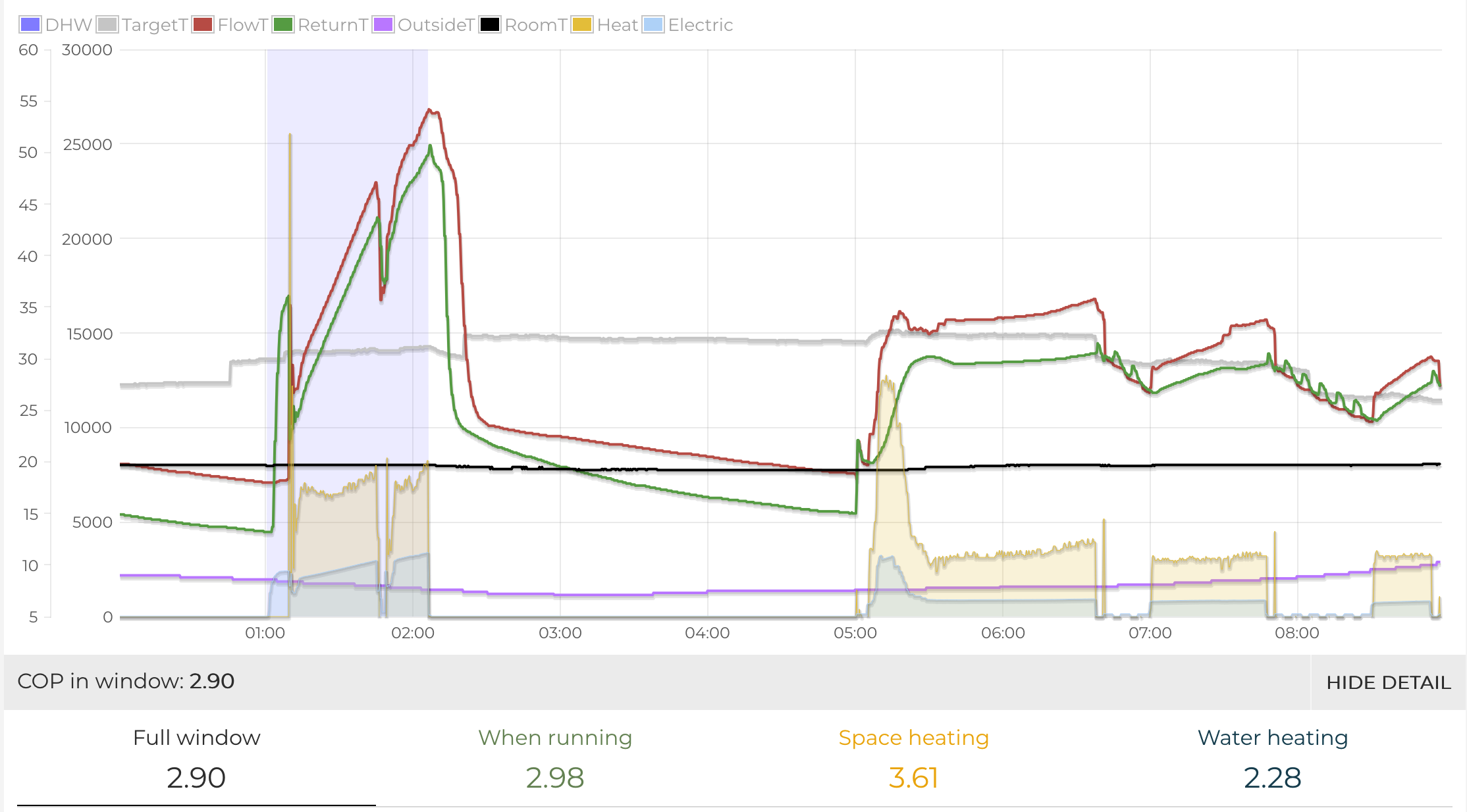

Looking at your 2 Mar screenshot, which is at OAT average 4C, -0.6-9.5C, a very different situation where one wouldn’t normally see cycling, it looks like it’s responding to defrosts, which is what I’d expect in those circumstances, rather than cycling. You turned it off at 15.00? Here’s mine for that date (apologies for the data hole - my wifi obviously dropped out!):
  • Big bang on defrost recovery
  • Average outside temp is 2.7C; -2.2->9.3
  • Cycling when it gets to 9C outside!
  • Room temp mean 22.6; 21.3->24.5(!) - might have been sunny, and I use LWT only, no 'stat
  • At 20.00 it kicks in hard, but again that’s post-defrost
I’m not sure I’ve added much to the conversation here, just some observations and some questions about how you were/are using it. For the record, I don’t usually see a big kick when it is genuinely cycling, rather than recovering from defrosts. And none of this is intended as a criticism of anyone or anything, we’re all learning. Oh, and mine was installed in May '23.

LWT driven by weather curve setup + Madoka stat. Steps are whatever the system decides to apply as we don’t manage that.
With the 9kW we had a “boost” of +1 set to the target room temp for whenever our EV kicked in an out of hours charge on Octopus Intelligent so the 1900-2100 might have been linked to that. Not necessary for the 8kW as it’s happy to run steadily at much lower power consumption than anything the 9kW could achieve.
With the 9kW’s minimum power input stuck at 930-950w there was limited practical benefit to chasing lowest possible LWT temps for us as the unit would ramp up cycles & defrost cycles if LWT dropped much below 37ºC so most of the time it would be sat at 37-40ºC LWT rather than achieving lower temperatures.
5am - coming off a DHW cycle & boosting room temps by a degree.
We never turn the system off; house hit target temperature at 0600 and the heat loss is low enough that the HP didn’t kick back in until 1900.
Your unit’s going to be at least a year newer than our 9kW was. Install was August 2022, but no idea how long the hardware sat in a warehouse/distributor before shipping to us. Not impossible there are differences between them in behaviour or perhaps software.
