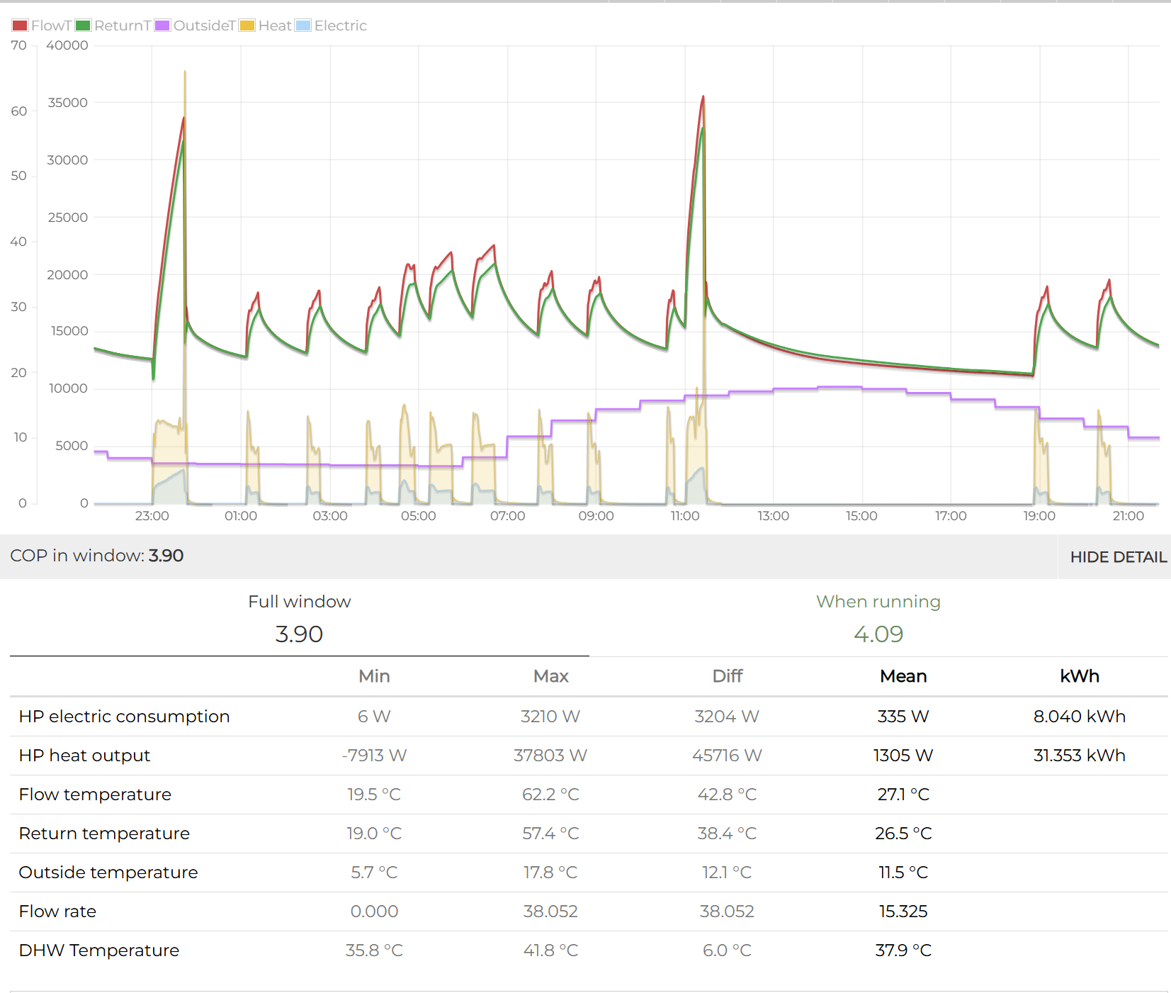

Had the heat pump installed last week - Vaillant Arotherm + 10kw
Slowly getting the grip of the controls and fine-tuning them.
I’m tyring to understand why the Heat output is -7913 W and max is 37803 W.
PS: The flow temperature peaks are due to setting an automation to boost DHW to 55 when there is excess solar.

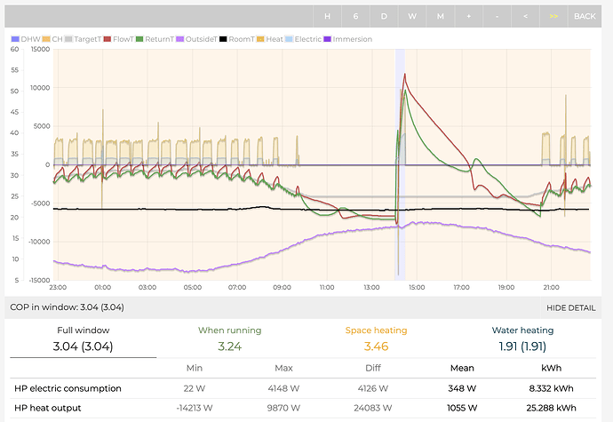

Try clicking on Show detail, then selecting **Show defrosts and other heat lost** - you’ll see a very brief negative heat probably when the DHW kicked over - see mine below. It’s when the return is hotter than the flow because the DHW tank is heating up the colder HP output water.
