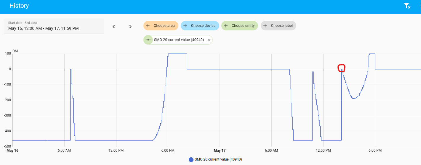

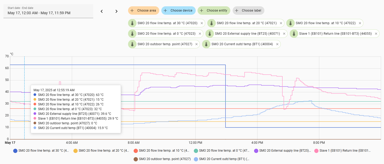

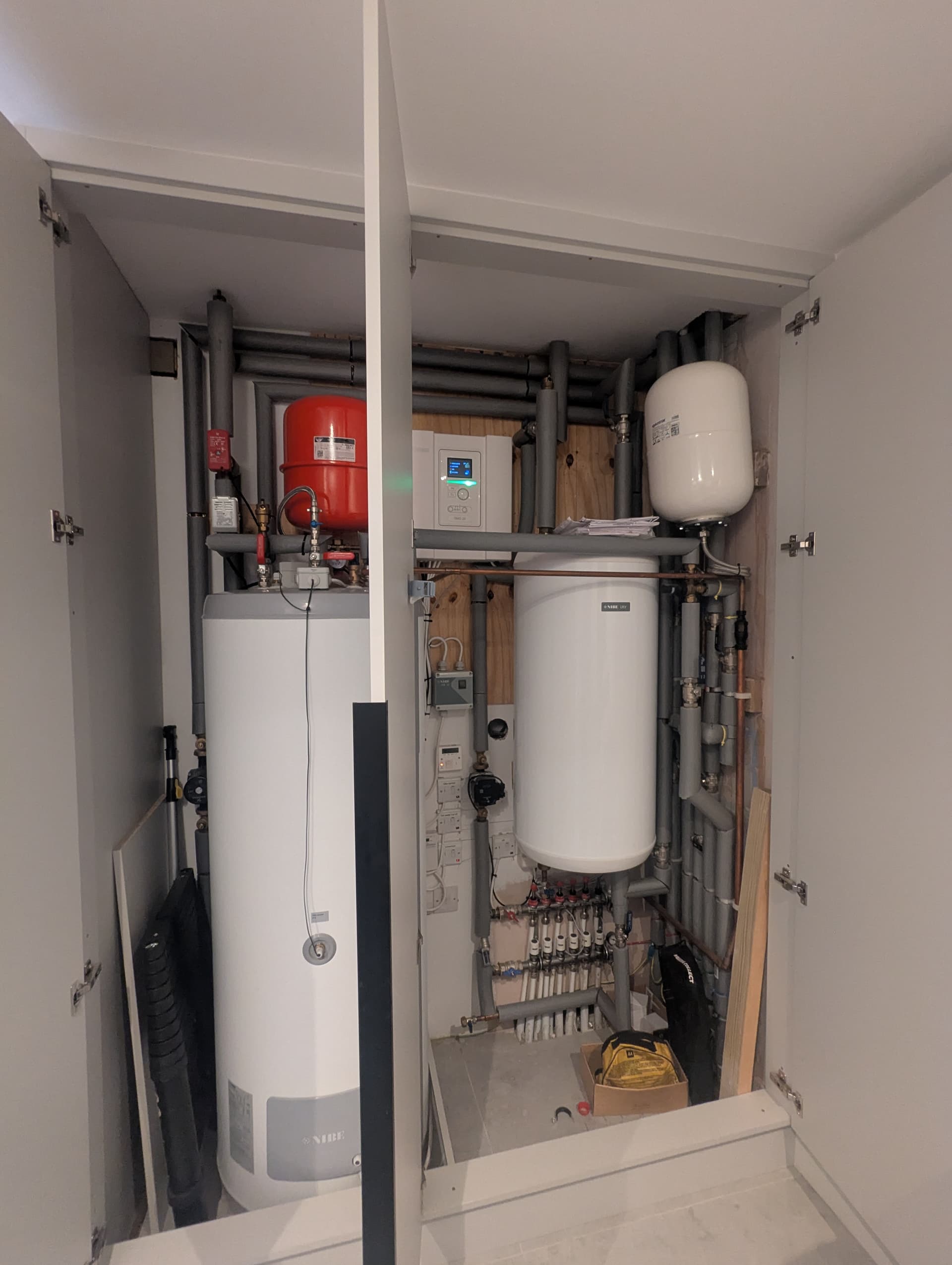

Hi everyone! I’m a newly signed up member but have been browsing the forums here for a little while now trying to make sense of my heat pump data and learning how I can make sure it’s running efficiently. I can see there a lot of helpful and knowledgeable forum members so I am hoping someone can point me in the right direction.
Recently we moved over to the eon next drive tariff which has a daily off-peak period between 0000 - 0700. To take advantage of the cheaper electricity between those hours I wanted to set my Nibe F2040 / SMO 20 system up so that it attempts to heat water only during (i) the off-peak period and (ii) between 1530-1630 to ensure water is available for the evening. On weekdays typically showers are taken between 0615-0645 and then occasionally evening showers anytime from 1700-1900 (hence the 1 hour heating window in the afternoon, assuming ~15min of off-peak heating from the morning would not be sufficient to have the 300L tank up to a reasonable temp).
I have data feeding into Home Assistant via the myUplink integration and would like to work out how to integrate it with OEM eventually. Unfortunately whilst I can see lots of data I’m not really sure what a lot of it means and am somewhat shooting in the dark when trying to diagnose recent issues.
Initially, my installer (who is unfortunately not very responsive at the best of times) had created a schedule which set the DHW to “economy” during the times I wanted the system to heat the water. That was seemingly working ok but then I believe I accidentally made some changes to some settings via the home assistant app ([accidental settings change on sliders](https://community.home-assistant.io/t/prevent-number-entities-sliders-from-moving-accidentally-when-scrolling-through-entities/674822). Those changes caused our system to start behaving oddly but with the help of the HA history view I think I was able to look back and revert the settings and the system returned to its prior pattern. However in this state I noticed the “add heat in tank” binary sensor (which I believe to be the immersion heater) was kicking in during times outside what had been scheduled. I flagged this to the installer but they said they had trouble seeing my data in myUplink and they asked me to contact Nibe. Upon doing so, Nibe suggested I instead schedule the system to be “off” during periods when I don’t want the water to be heated. I change this on the evening of Wednesday 14th May. Initially this seemed to be working (for around ~12-15 hours) but then on the evening of Thursday 15th May at around 10pm the charge pump turned on and remained on for ~20+ hours. I noticed that the DM value dropped from 0 to -489 when the charge pump initially switched on and I don’t really understand what drove that. I tried to reset the DM manually in HA to zero but it immediately dropped back down to -450 which I believe is the reason the charge pump is continuously running. Even though the charge pump was constantly on, water in the tank was not being heated and at around 6pm on Friday 16th May there was a cold shower had and I was not popular!
Worrying that the continuously on charge pump was running up my electricity bill but more importantly might have been damaging the equipment, I reverted to the original “economy when I want it” schedule that the installer has setup. Things again looked ok for a while and we had hot water this morning (May 17th). There was a bi-weekly legionnaire’s cycle overnight which took the temp to 60C but I understand that’s normal so I thought we were back to good state. The charge pump wasn’t continuously on…but then around 8am this morning (May 17th) I saw the charge pump is back on and the DM reading is negative again. I’ve attached a screenshot (I highlighted in blue the times when the schedule was changed. The red highlight is the time of the cold shower. I’m not really sure the screenshot in itself is that useful and I’d be happy to zoom in / show different metrics if anyone with a bit more experience of these systems can provide me with some guidance as to what is most relevant but I figured I’d share some data in case someone can see anything obvious. One thing I do see is the “flow line temp at 30C” is set to 63C which looks odd (but I don’t know if that setting was recently changed somehow). It seems inconsistent as the settings for 10C/20C are much lower at 26C/15C respectively and presumably the setting at 30C should therefore be lower. Maybe around 10C?
Any help would be very much appreciated and hopefully in time I can learn how this all works and give back to the community too!

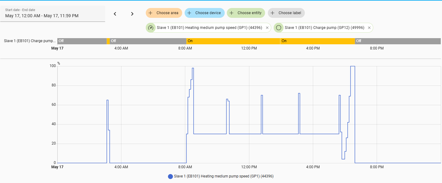

 ![Screenshot 2025-05-17 132017](https://community.openenergymonitor.org/uploads/default/original/3X/c/2/c2e16b955063b05d0675b7ac844955f37a99cfc1.jpeg)

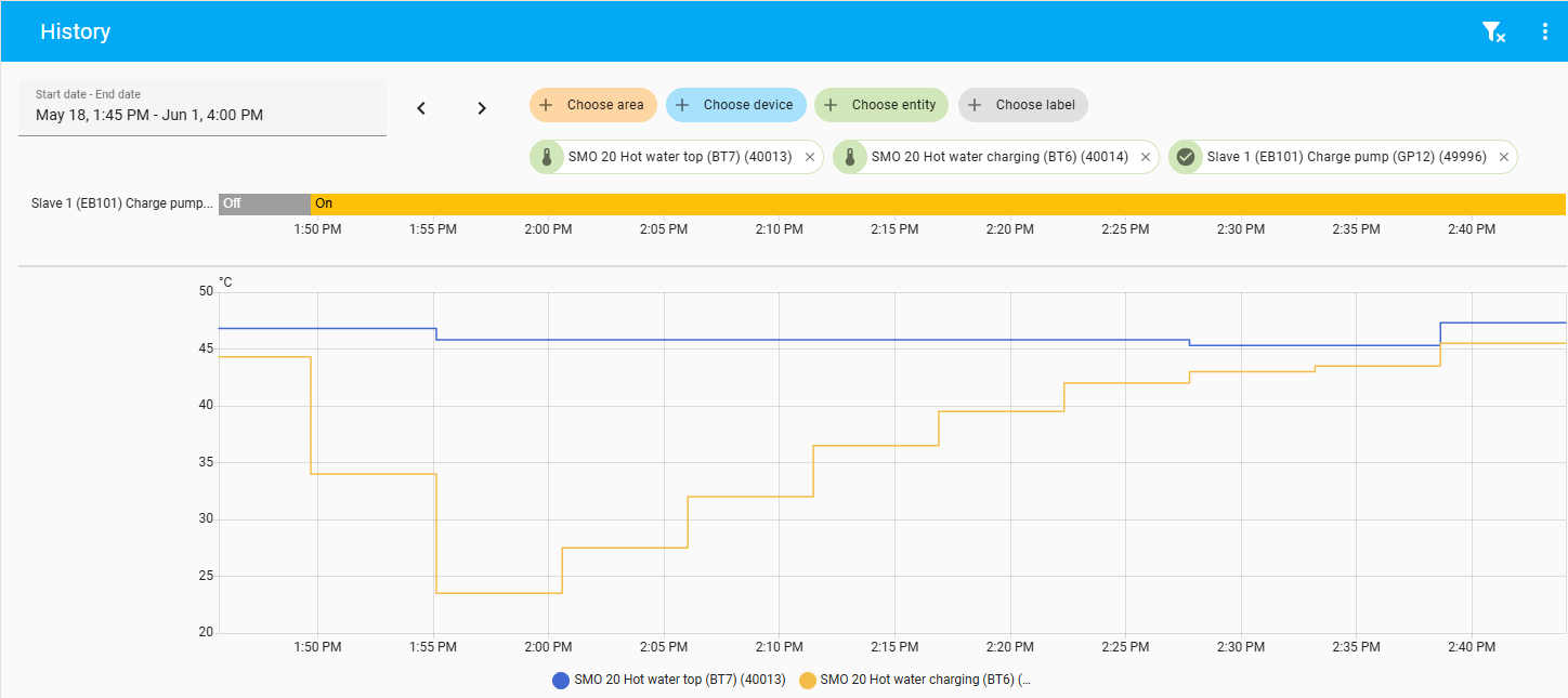

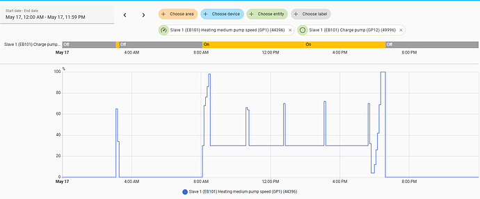

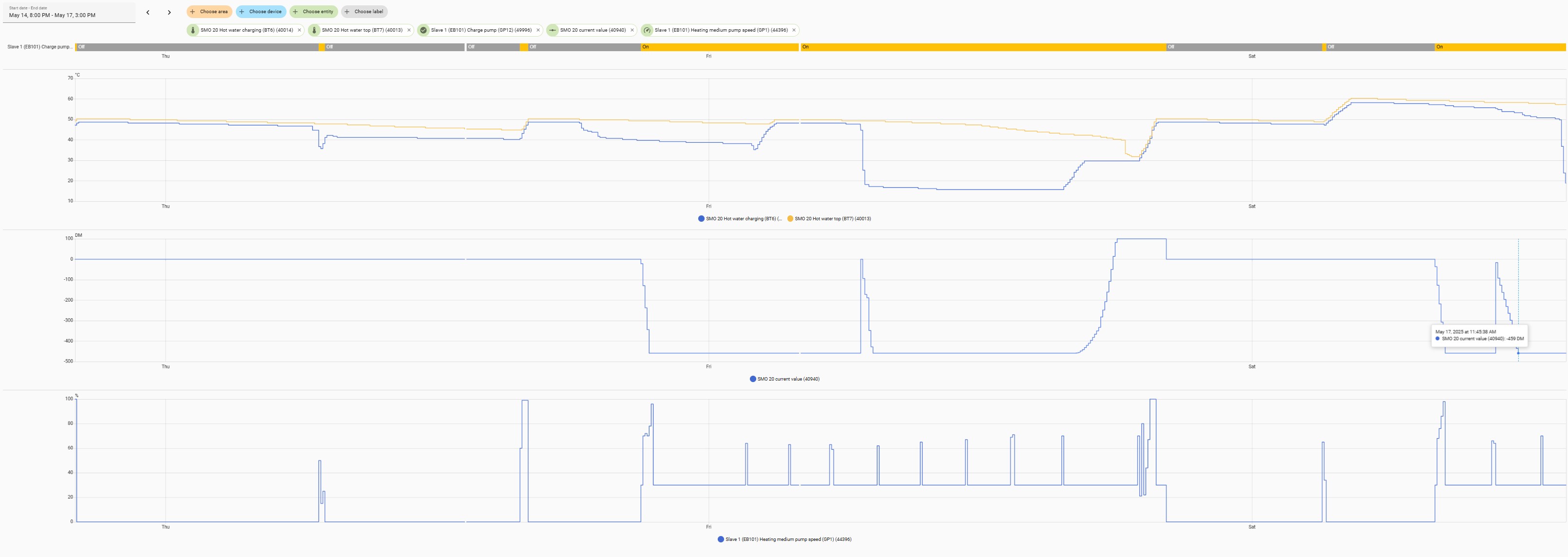

Adding a second screenshot which might be helpful. Shows pump speed / DM / hot water top and charging.
 ![Screenshot 2025-05-17 135427](https://community.openenergymonitor.org/uploads/default/original/3X/2/c/2caf83df2566a1750f21c47376c0f547f59ea6d8.jpeg)

The first thing I’ll highlight is that the DM (Degree Minutes) value is _purely_ related to Central Heating and is _completely separate_ from the DHW management. (If you’re not familiar with the principle of DMs, they’re a way for the controller to keep track of under- or over-shooting the calculated target flow temperature for space heating.) It’s a read-only parameter, so not something you can set directly - though you can adjust the DM threshold values for things like compressor start-up.
The second thing I’ll highlight is not to worry about the charge pump running most of the time. Mine runs 24x7 during the heating season, and only consumes about 10W. It needs to run at a low level to move water through the central heating system - especially on installations with a buffer tank / volumiser vessel - then it ramps up to 100% when it needs to.

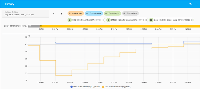

On the charge pump being on for long periods I confirmed it was running at 30% for most of the time (which I think is the minimum). I’ll try and work out how much electricity that used (I know our usage was much higher than usual yesterday and I’m not sure why). I don’t currently have a way to accurately measure the electricity usage of the heating system. I am thinking of getting a CT clamp to put around the live wire for the ASHP in my fusebox but I think that will only tell me how much electricity the heatpump in the back garden consumes (i.e. I’m not sure if it’ll include the charge pump).
 ![image](https://community.openenergymonitor.org/uploads/default/original/3X/8/0/8010741a2b1e33781ab476629d4e8a7f8c5ee30f.png)

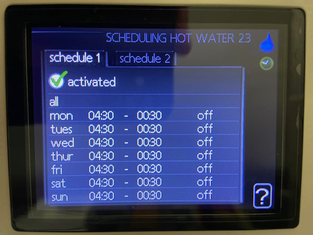

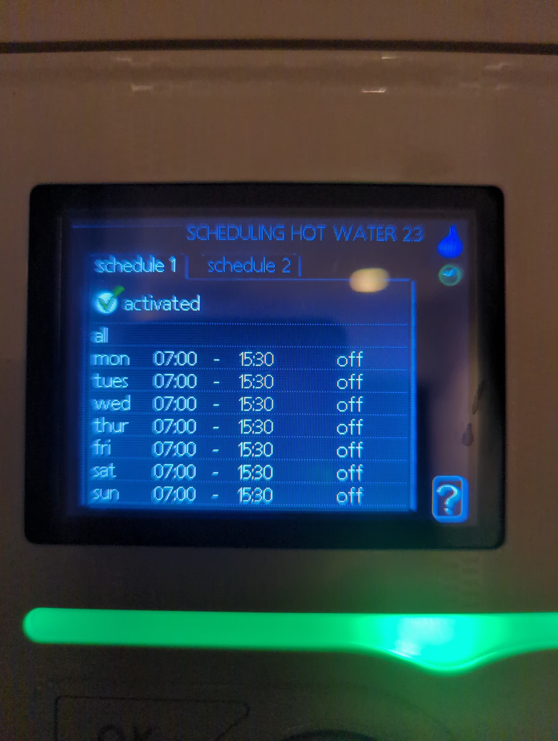

Like you, I want to force DHW to run in the off-peak tariff period, so my DHW schedule (Menu entry 2.3) looks like this:
 ![image](https://community.openenergymonitor.org/uploads/default/original/3X/d/8/d895853c6bb63f6ae09cbc6e4d9e2024d5b85ff1.jpeg)
Effectively that’s saying:
- It’s _not allowed_ to heat any DHW between 04:30 and 00:30 - no matter how cold the DHW tank gets
- At 00:30 it’s allowed to start heating DHW, for which it will use the _default_ “Comfort Mode” set at Menu Entry 2.2
- At 04:30 - even if the DHW tank hasn’t reached its target temperature - it will stop heating DHW
I suspect your current settings are simply over-riding the default Comfort Mode, rather than ‘blocking’ the heating of DHW.
That 30% is configurable. The puzzling thing is the charge pump running at that level means it was ‘expecting’ to do some space heating (which also aligns with negative DM value). So something odd is happening with your space heating configuration - but let’s get your DHW sorted first then look at space heating later.

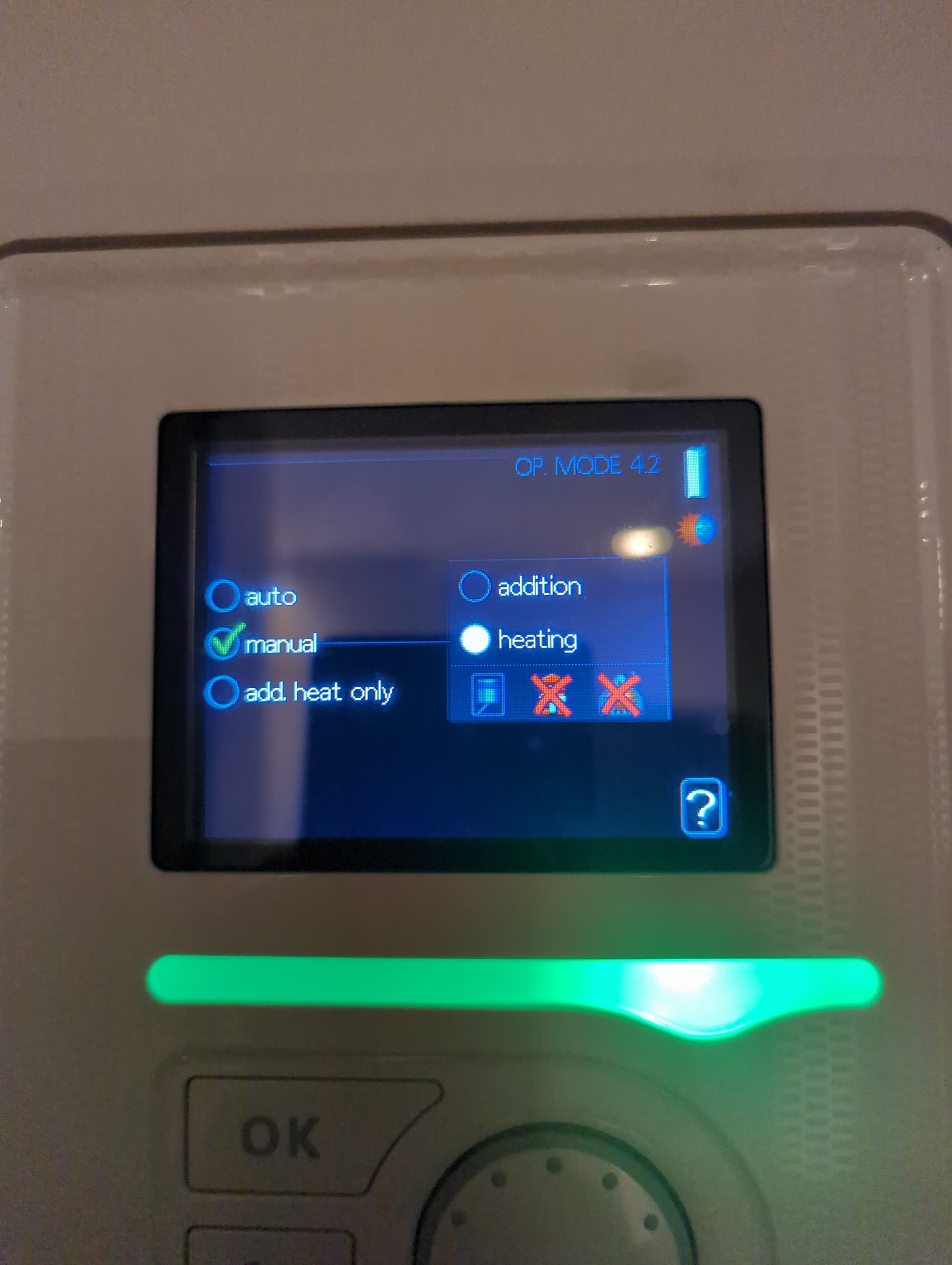

I’ve just made the switch to manual op mode. I assumed I should untick “addition” and “heating” which were both initially ticked when I entered manual mode.

As for the blocking schedule I made the suggested change to schedule “off” periods earlier this afternoon. I made the change just after my wife had been for a shower at around 1545 but strangely the data being shown via myUplink seems to indicate no drop in the water temperature at that time or thereafter. Usually I can see when showers have been taken as the hot water top value drops but today it’s a flat line after the tank was reheated following showers we had earlier in the day. I’m hoping that’s just a side effect of me making the scheduling change just after hot water had been used (i.e. perhaps the system isn’t even reading any sensors until it kicks back into gear at midnight?). I’m very much hoping that’s the case as my wife did have a longish shower and I think I’ll end up having a cold one before work in the morning unless the DHW comes on tonight! I’ll be fast asleep by midnight so will find out in the morning.
I have two scheduled periods designated for heating water, the first of which is shown below and seems to match your settings. Schedule 2 covers 1630 - 0000 (thus allowing the heat pump free reign between 1530-1630)

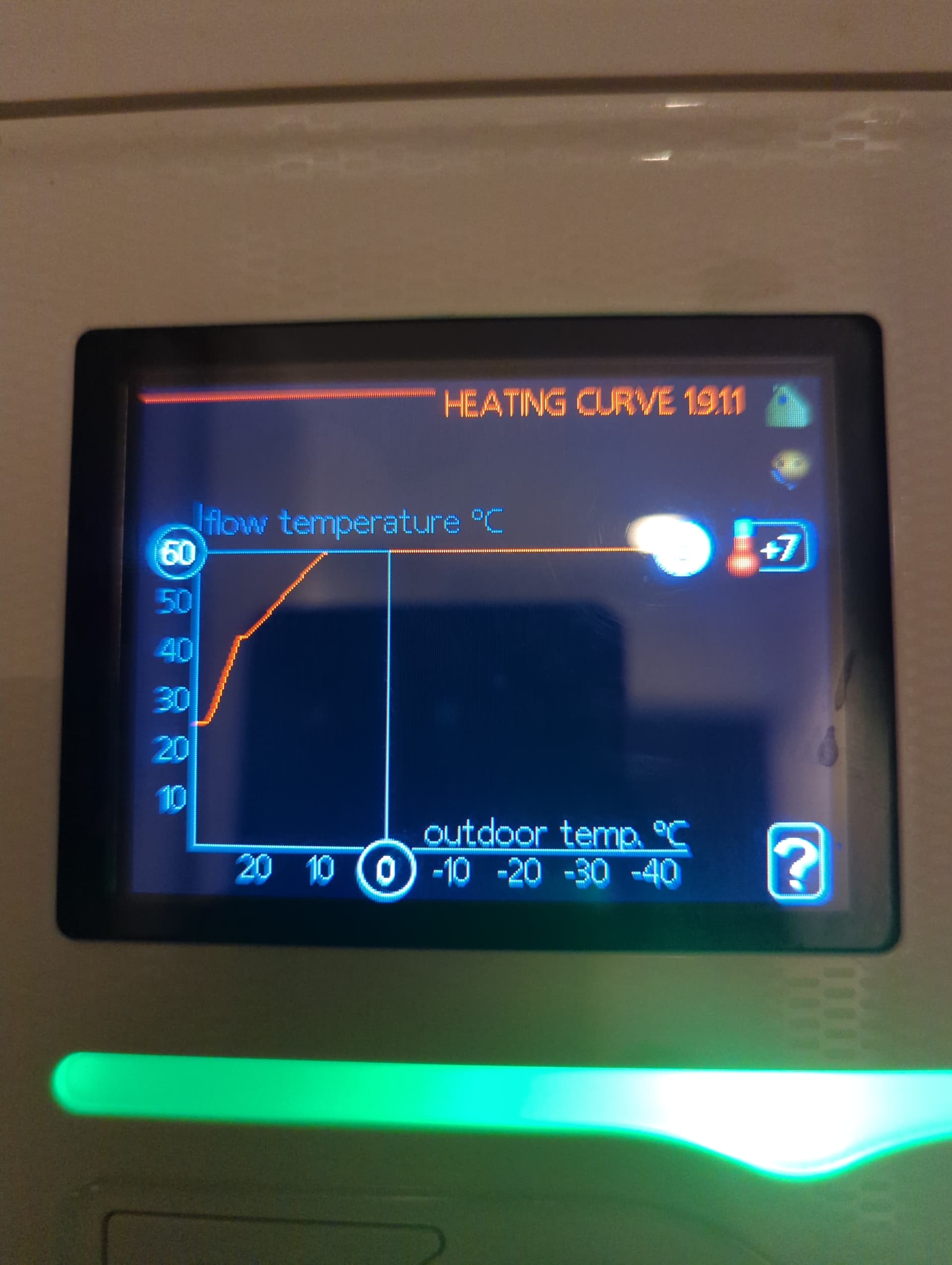

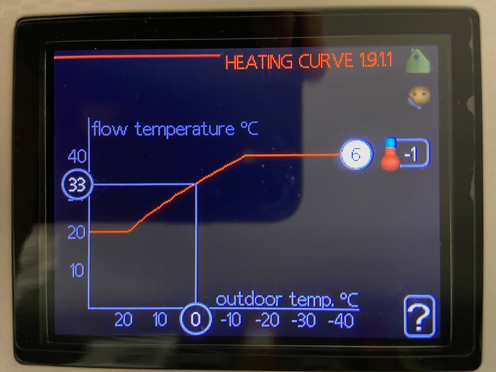

One thing I did notice as I was moving through the menus is the heating curve setting which looks like this (although there are also further settings labelled “own curve” which might be overriding this and are the temps at those 7 points I previously mentioned)
 ![17475996931529200204610417932655](https://community.openenergymonitor.org/uploads/default/original/3X/4/c/4cbb79974d96a341d32132b61606a2b6cda4c9d9.jpeg)

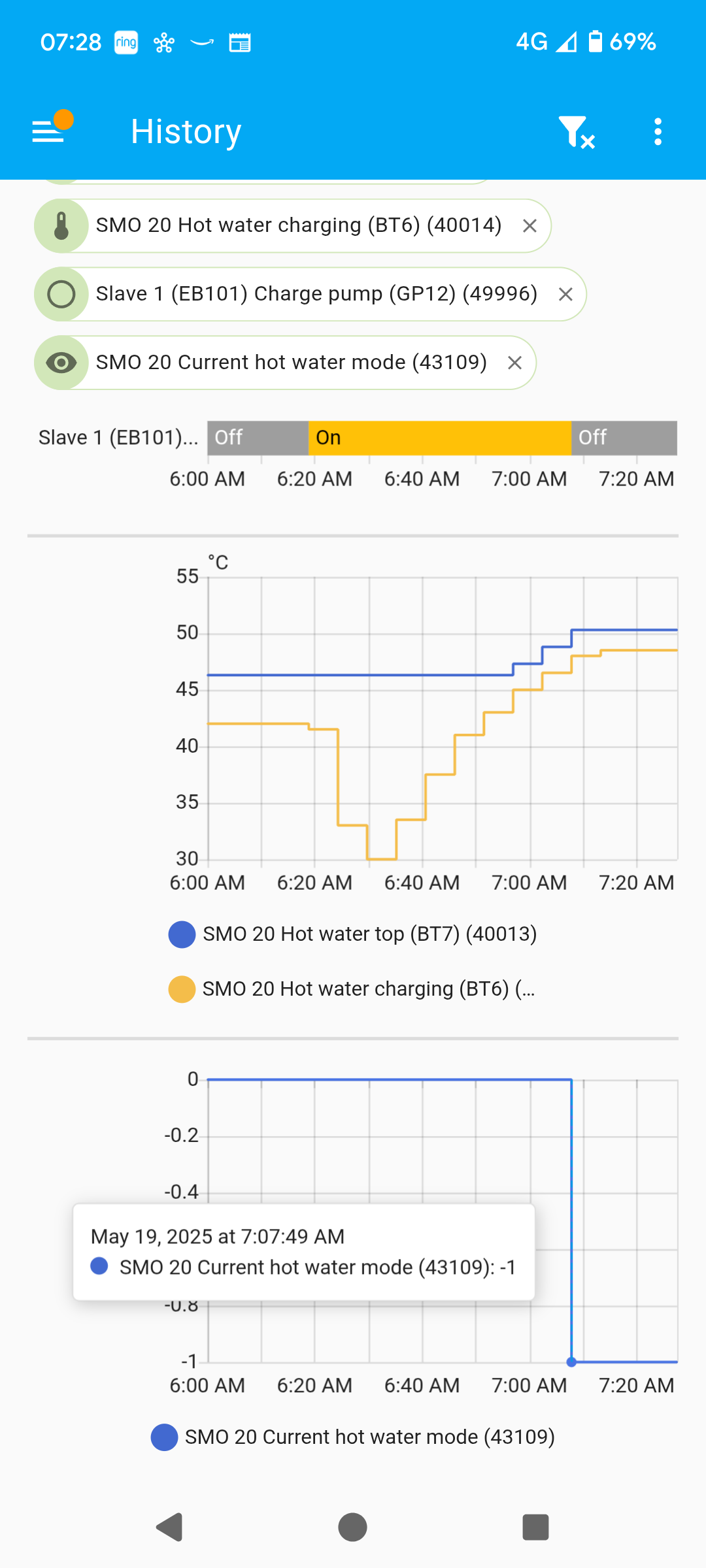

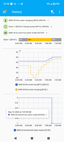

Happy to report I had a hot shower this morning at around 0615 and the DHW kicked in just after at 0618 and ran til 0707 (assuming that 7 minutes is just a lag in the reporting) after which it turned off. So this all sounds in line with what we had hoped. I can also see a “hot water mode” value which I deduced to have different values depending on what is being requested wrt DHW (-1 = blocked / 0 = economy / 1 = normal / 2 = luxury / 3 = immersion).
 ![Screenshot_20250519-072809](https://community.openenergymonitor.org/uploads/default/original/3X/d/c/dc60705ac3f79abfcc6c8d9d25c5db5c1728759d.png)
I’ll give it a day or two like this to iron out any issues and observe what happens during the 1530-1630 window, then decide if we need to think about any other changes wrt DHW. One thought is to switch it to “Luxury” to get the tank hotter (so after mixing we get a larger volume of ‘useful’ hot water) but I’d only want to do it during the off-peak window and not in the hour slot in the afternoon. I don’t think this is possible via the blocking schedule but perhaps could be achieved via a Home Assistant automation.
Correct. Your photo looks exactly like my configuration for “DHW only” mode.
I don’t need to use “schedule 2” so wouldn’t be certain what to set there, but my hunch would be exactly what you’ve done - with the 07:00 - 15:30 “off” period in “schedule 1” and the 16:30 - 00:00 “off” period in “schedule 2”.
Well, that Heating Curve is _miles_ out… and I’m pretty sure you’ve found the reason for the Central Heating preparing to run the other day (and hence running the charge pump).
For comparison, my 1.9.1.1 looks like this:
 ![image](https://community.openenergymonitor.org/uploads/default/original/3X/9/4/94751e81081021884b98658406ffc4d6afdd6a0e.jpeg)
While you won’t want to use the same settings as me (I’m fortunate to have a very highly insulated house, which is why I can get away with Curve #6) you’ll want a profile that looks a lot more like mine. I can’t quite make out what Curve number your photo is showing; the factory default is Curve #9.
You may have the original settings in your Home Assistant history but otherwise the [SMO 20 user manual](https://assetstore.nibe.se/hcms/v2.3/entity/document/877085/storage/ODc3MDg1LzAvbWFzdGVy) gives some guidance on making changes (and reminds me that “Own Curve” is only used when selected as Curve #0 in 1.9.1.1).
Bingo! Ok, so now the only thing I need to try and figure out is what it was originally set to and how it might have changed. Looking in HA history it seems to suggest it’s always been on “curve 15” but I’m not sure I should trust that. Is there somewhere in the SMO20 where I could see what it was historically? When I setup myUplink I think I took a backup of the settings but I’ll need to figure out what I actually did with that.

Hi Samir,
> [@samirrpatel](#):
> there seems to be two possibilities for the curve, either 12 or 9 and the offset seems to have been 0. Do either of those combinations seem plausible?
I’m not familiar with the format of that backup file either, but 9 is the factory-default Curve and 0 is the factory-default Offset - so those are by far the most likely original settings.
I know you said your installer isn’t being especially responsive or helpful, but they might have some records of which Curve they originally set - or might remember if they changed it from the factory-default setting.
Starting with Curve #9 (or #10) and an Offset of 0 would seem sensible to me.
David

Thank you. Yes, I’ve dropped the installer an email to see if it’s my lucky day and he responds, but failing that I’ll switch it to 9/0 and give that a go. Presumably there is potential for further optimisation thereafter as we see the data come in.
To be honest right now there is no need for heating anyway. Is it better to just leave things on manual with no heating enabled for a long period (i.e. the summer) or better to enable the heating again but configure it such that it doesn’t really do much during these warmer months?

**Post date:** [20 May 2025 07:18 UTC](https://community.openenergymonitor.org/t/help-understanding-why-my-nibe-charge-pump-is-suddenly-behaving-oddly/28619/12 "2025-05-20T07:18:24Z")
> [@samirrpatel](#):
My recommendation would be to re-enable the heating (once you’ve set the Curve and the Offset) - to check it’s behaving itself. There are some other settings that can be tweaked, to control whether the charge pump runs or not, based on the outdoor temperature. Once you’re happy the heating will work OK when you want it to, you can then swap it back to ‘manual’ for the summer - to save the heating coming on if we get the odd cool night.
> [@samirrpatel](#):
Absolutely. But you’ll need to see if the house gets too warm or too cool in different outdoor temperatures before finally choosing the Curve and the Offset, so there’s not much more you can do before Autumn.
Do you have the optional indoor temperature sensor (BT50)? If so, that makes the choice of Curve less important, since the control algorithm will make adjustments if the measured indoor temperature is above or below the set-point. Without that sensor, you’re entirely reliant on the choice of Curve and Offset to manage the indoor temperature.
David

**Post date:** [20 May 2025 09:26 UTC](https://community.openenergymonitor.org/t/help-understanding-why-my-nibe-charge-pump-is-suddenly-behaving-oddly/28619/13 "2025-05-20T09:26:07Z")
Hi Samir,
Here’s a basic summary of how the NIBE heating control algorithm works, for an SMO 20 or similar controller, to help you assess whether it is indeed ‘behaving itself’:
1. It knows what the (short-term average) outdoor temperature is from sensor BT1
2. It ‘looks that up’ against the selected weather compensation Curve and Offset to derive the Calculated Target Flow Temperature S1
3. Some houses get significant passive solar gain, or have other variable heat gains or losses due to e.g. cooking or draughts so the indoor temperature from optional sensor BT50 can be used to adjust the target flow temperature based on whether the indoor temperature is above or below its set-point
4. A variable-speed compressor motor can modulate its output to a certain extent, but can’t always exactly match the calculated target flow temperature S1, so the _actual_ flow temperature from sensor BT25 is used to ‘audit’ how well the system is performing against that target
Hopefully that explains where the DM values come from (and how suddenly getting the large, negative DM value you saw the other day is most likely a spurious data issue).
A few further points:
1. There needs to be a bit of flow past sensor BT25 in order for it to give an accurate reading, hence the variable-speed circulation pump (or 'charge pump’) runs at a low level even when the compressor is off - and then runs faster when the compressor is on, aiming to maintain the target delta-T between the Flow and Return temperatures
2. The Degree Minutes control mechanism dates back to before variable-speed inverter-drive compressors were a thing, when the compressor **had** to cycle on-and-off and the controller needed a robust mechanism to determine the on-versus-off durations while not doing too many compressor starts
3. There’s a configurable ‘compressor Curve’ which governs how ‘hard’ the compressor motor gets driven by its inverter, once the heating demand is above the compressor’s minimum output
4. If for some reason the actual flow temperature (BT25) fails to reach the calculated target (S1) - even with the compressor running at full speed - the DM value will go more and more negative so there’s another DM threshold setting which can bring in an auxiliary (pure resistive) heater to help out
I’ll stop now. That’s longer and less ‘basic’ than I’d intended - but hopefully it all makes sense.
David

1. can I use HA/myUplink integration to switch the hot water mode to Luxury during the off-peak period and back to economy for the peak so I minimise peak usage
2. could I create a manually triggered automation that could cancel the peak scheduled DHW window for the day. E.g. if I know we’re not planning to have showers after the scheduled peak heating window (1530-1630) on any given day then I trigger the automation and make the system wait for the overnight off-peak period before heating up the tank. It would have saved me ~35p today so not a big saving but I’d still like to reduce my bill and do my bit for the environment if I could.
> [@etchelsa](#):
> it would be useful to know your setup in terms of buffer tanks and any secondary circulation pumps
I knew it was only a matter of time before my ignorance of what I actually have would be exposed. I’m just going to come out and say it…I have no idea what a “buffer tank” does but I know a picture can tell a thousand words, so here is one! In the bottom right is one of three heating manifolds that control the UFH (we have one of these on each of three floors in our town house). As to whether I have a buffer tank or not, not to get too technical but I have one small white tank and one small red tank. Is one/both a buffer tank? 😉
 ![PXL_20250521_195320522](https://community.openenergymonitor.org/uploads/default/original/3X/1/0/10d788a6a50e04b19dfa269d4df11354ba0a986d.jpeg)
I updated the heating curve to #9 with 0°C offset yesterday evening and I don’t think the heating has turned on today and nor has the charge pump gone crazy as it was doing when I started this thread, so that is a good sign.
Thanks again for your offer to help!
Samir
**Author:** ![etchelsa](https://community.openenergymonitor.org/user_avatar/community.openenergymonitor.org/etchelsa/32/27299_2.png) [@etchelsa](https://community.openenergymonitor.org/u/etchelsa)\
**Post date:** [21 May 2025 21:53 UTC](https://community.openenergymonitor.org/t/help-understanding-why-my-nibe-charge-pump-is-suddenly-behaving-oddly/28619/19 "2025-05-21T21:53:59Z")
Yes that curve you originally had would definitely have caused you the problems you were seeing.
Your set up is pretty much the same as mine and you have a buffer tank. It’s the larger white one on the right.
Have you put your operating mode back to auto? If not no space heating will occur irrespective of the curve you chose.
There is quite a bit I learned when optimising this type of set up and happy to step through it. It depends what problems, if any, you have with space heating. A bit hard to tell with summer upon us.
How new is this installation? Have you ran it through a winter season and had ok comfort levels? Have you been happy with usage / bills?
And just out of interest what sized unit are you running for a 3 floor town house? Is it the f2040-12 (12 kw version)
Yes, it’s back in auto mode
