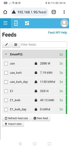

Hello please could someone advise me how to get the ‘use’ and ‘use_kwh’ feeds working? I have an Emonpi with one CT clip on the heatpump power and plugged into CT1 which seems to be the P1 feed. See photo…
Welcome, Helen, to the OEM forum.
The Feed is the place where your data is stored - it’s really a database. Your emonPi is really an “emon” energy measuring device attached to a Raspberry Pi. The ‘emon’ part sends data to a service running in the RPi called emonHub, this interprets the data and repackages it for emonCMS. It arrives on the Inputs page of emonCMS. (Look under Setup in the main emonCMS menu.)
It is on the Inputs page where you process the data. If you click on the spanner icon on the same line as P1 (Power - CT1), you’ll come to the “emonpi process list setup” page. It’s here that you can do all manner of things to the input - scale it, add or subtract constants or other data etc (too much to list here). Now I’m not sure how you come to have 3 Feeds already - normally you won’t have any and you’ll have to create each. What looks to be worse is you have an energy (20.54 kWh) as power P1, so somehow something has gone badly wrong here. Have you already tried to set something up and got into a mess?

Your ‘Use’ will probably be the power P1; usually and for people with PV, P1 will be the power in/out of the main supply, ‘use’ will be what the house consumes. ‘use_kWh’ is an energy, so you need to use the process step that does the accumulation over time to convert power in watts into energy in kWh – Power to kWh. You’ve also (possibly) got E1 which is the accumulated energy in watts straight from the ‘emon’ part of your emonPi. If you have it, it’s your choice whether to use it or not. The two energies should match (though they won’t start from the same place).
Come back whenever you need any more help, but by far the best way is to fiddle about, make mistakes and learn. You can always delete the feed and start again - best done sooner rather than later before you’ve acquired loads of valuable data. One particular warning - make sure the Feed interval is longer than the time between packets of data arriving. For your emonPi on its own, choose 10 s as the feed interval. You can’t change it later, you need to create new Feed.

I tried adding E1 as below. It all looks a bit weird though :thinking:. E1 has no units. I attempted to convert to kwh by multiplying by 0.0001. Both the kwhday numbers seem odd. Maybe I’ll delete it all and try again tomorrow. Where does the E1 data come from? I only have one CT clip and that’s intended to monitor what the heatpump is using. Octopus use data for the house included for reference.

Remember E1 (the units are Wh) started accumulating a few seconds after you first powered your emonPi - though it’s possible to reset it to zero via the Serial Config tool, emonCMS started only after you saved the process.
I think there are too many zeros there to convert Wh to kWh :face_with_hand_over_mouth:
Thank you! I have changed the process on E1, but I’m guessing that won’t correct the data already logged? The feed still doesn’t show any units for E1 though.

That should be in your emonhub.conf file (access it via emonCMS → Setup →Emonhub - Edit config ).
For Node 5 (the emonPi itself), I have this. Yours will be different because I don’t have the standard sketch running in the front end - you probably don’t have 2 pulse counts, you might not have the two energies even.
Those 4 lines specify the name of the quantity, how to decode it, how to scale it and finally the units, and they line up 1:1 (You can see I tweaked the calibration of my two powers :smile:)

If your “units = …” line doesn’t have the units for the energies, then you can add them, you should need to add E1, E2 to the ‘names =’, l, l (signed long × 2) to ‘datacodes =’ and 1, 1 to ‘scales =’ as well. If you’re in doubt, post this section of your emonhub.conf and a clip of the data coming in from Node 5 from the log. It should look like this (again, mine is non-standard, yours will be different)
