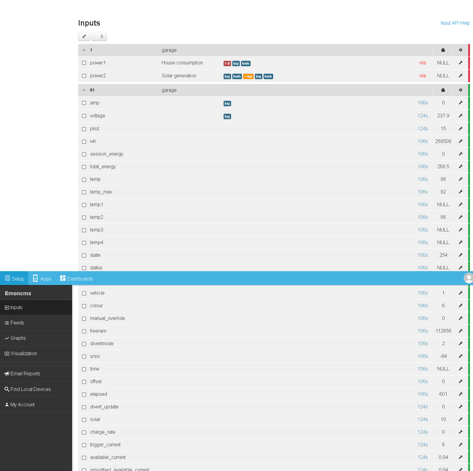

im getting very confused, i seem to have two data logging application running, none of which i have set up correctly.
1. emonpi.local-seems to have all the input but all are red and not logging any data?
2. emoncms.org- has green light and (i think) shows some data being logged, i think this is the infomation from the openevse.
3. i can only get "energy monitoring " in the openEVSE to connect with the [emoncms.org](http://emoncms.org) server should it work with the emonpi. local server too? does it make a difference?
![Screenshot 2022-12-05 at 23-16-49 OpenEVSE](https://community.openenergymonitor.org/uploads/default/original/3X/7/d/7d9a4ceadd988728f269bf70a8f31789bdc1f20f.png)
 ![Screenshot 2022-12-05 at 23-06-53 Emoncms - input view](https://community.openenergymonitor.org/uploads/default/original/3X/9/8/981904f9c4715166ce6daf3947610019371bed38.png)
 ![Screenshot 2022-12-05 at 23-13-12 Emoncms - input view](https://community.openenergymonitor.org/uploads/default/original/3X/3/5/354b21b366dbf219d3338318bc5ef3278c258317.png)
**Author:** ![greentangerine](https://community.openenergymonitor.org/user_avatar/community.openenergymonitor.org/greentangerine/32/12689_2.png) [@greentangerine](https://community.openenergymonitor.org/u/greentangerine)\
**Post date:** [6 December 2022 10:37 UTC](https://community.openenergymonitor.org/t/help-setting-up-data-logging/22060/2 "2022-12-06T10:37:31Z")
Enable mqtt on the same page and point it to your local emonpi/emonbase.
 ![2022-12-06](https://community.openenergymonitor.org/uploads/default/original/3X/1/a/1a30c91cf2b2eb50a72e80f187177a3ad8fbe031.png)
