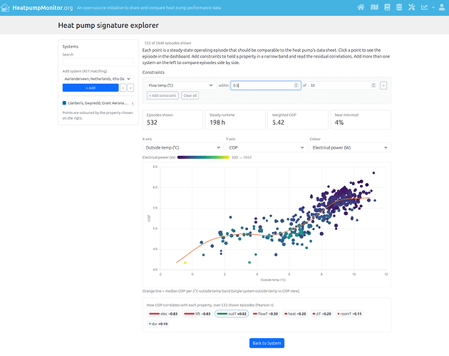

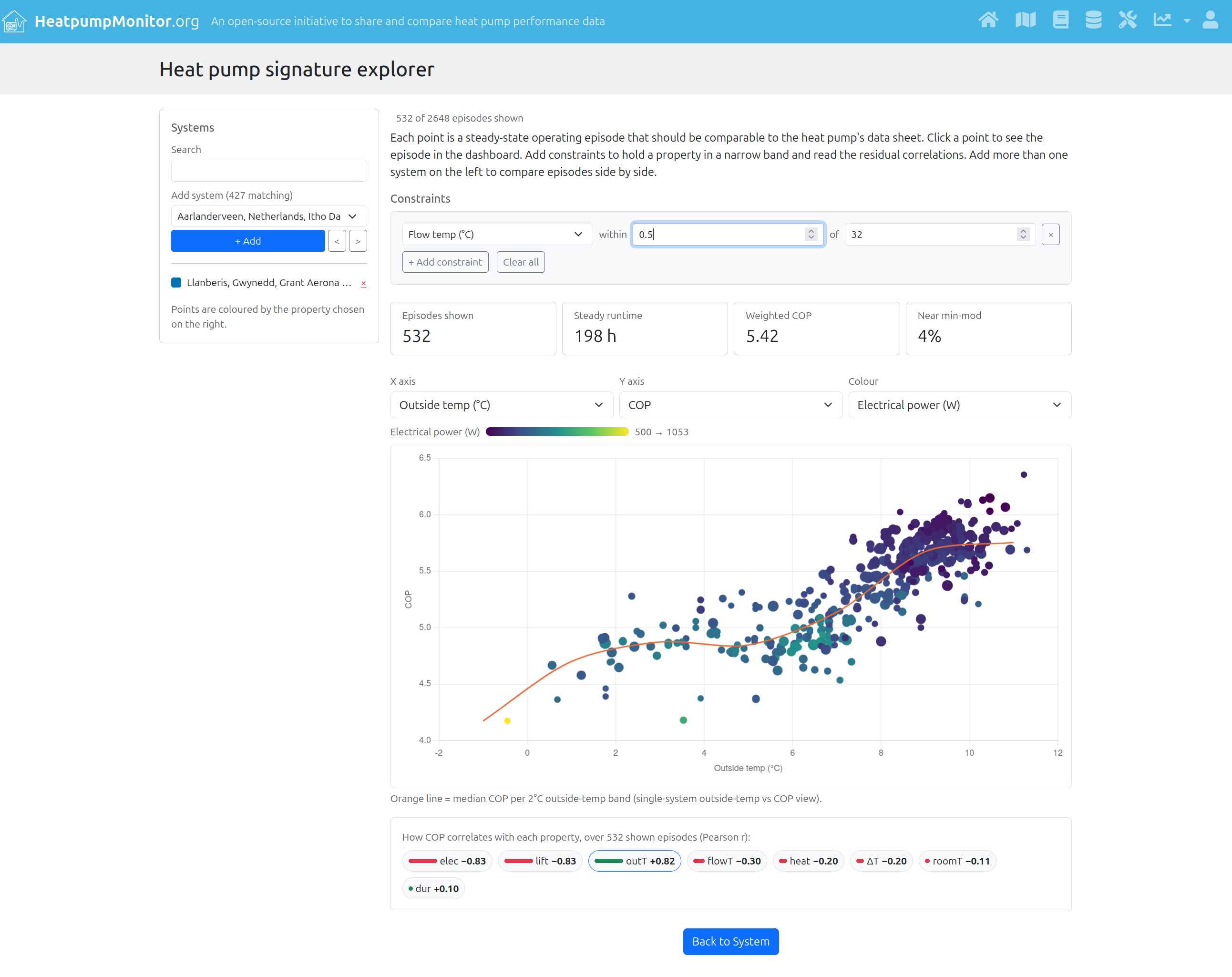

Just an early preview on these for now. The idea here is to pull out stable operating points from the detailed data on each system to ultimately build detailed performance tables for each heat pump with some form of distributional analysis..
All points example:
https://heatpumpmonitor.org/signature?ids=748&x=ot&y=cop&c=el
Filtered for flow temperature of 32C ±0.5K
https://heatpumpmonitor.org/signature?ids=748&x=ot&y=cop&c=el&f=ft%3A32%3A0.5

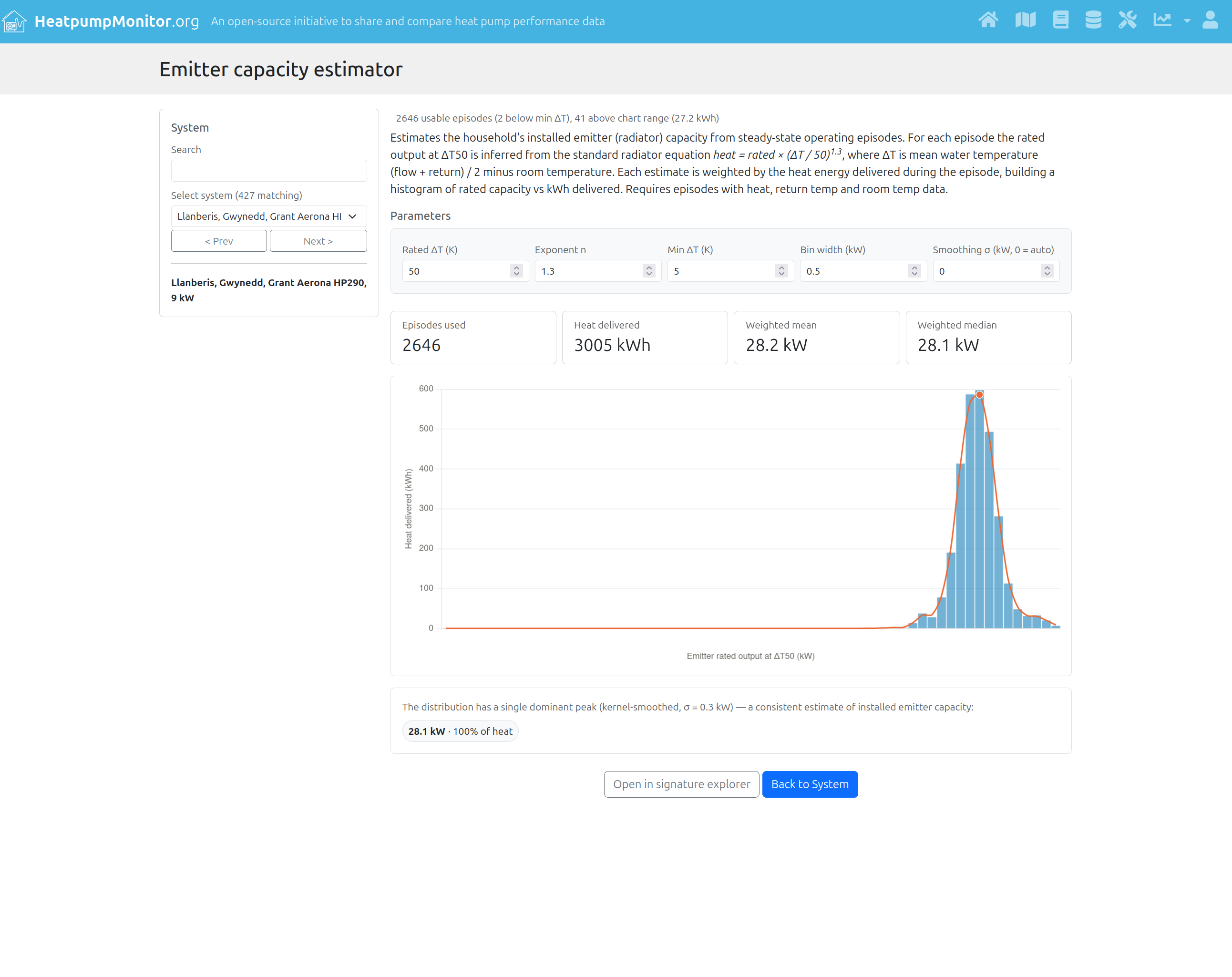

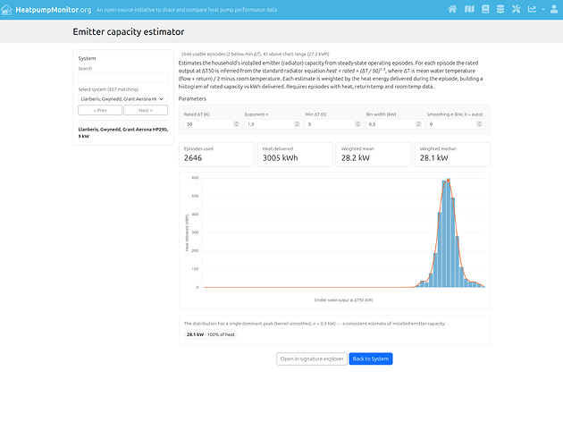

Then using the same data we can do emitter capacity detection - at least for radiators:
https://heatpumpmonitor.org/emitter?id=748
