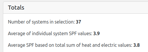

2
There are now 37 systems on the annual view with MID metering and SPF H4 boundary. These give a mean SPF H4 of 3.9!
