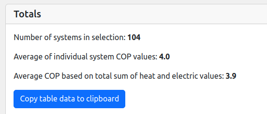

I’ve added a copy table data to clipboard feature to make it easier to pull out the data for further analysis in a spreadsheet:

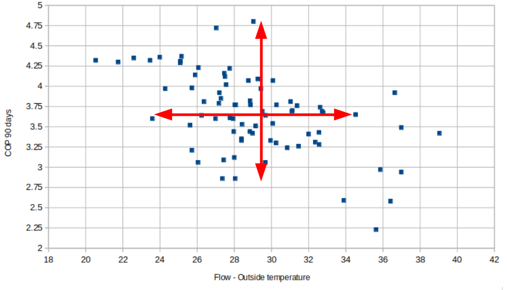

E.g I wanted to look at the COP over the last 90 days vs flow - outside temperature (when running):
 ![image](https://community.openenergymonitor.org/uploads/default/original/3X/e/5/e5fce705f050c9a595b1652c1246fe89e94de761.png)
while there is a general trend of higher performance from lower flow - outside temperatures, it’s interesting how much of a spread there is for some of the systems. E.g on the vertical arrow at a DT28 there’s a system getting 2.8 and another getting 4.8! Or on the horizontal a COP of 3.6 with DT24 through to DT34…

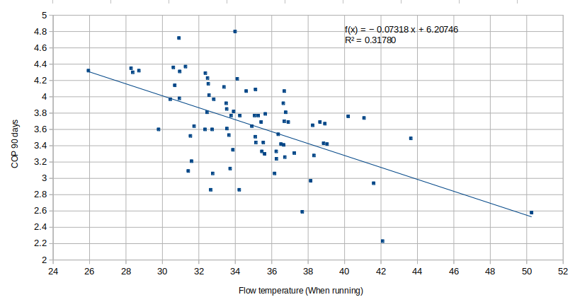

COP over the last 90 days vs flow temperature when running:
- The best system is a bit of an outlier at 4.8 at mean flow temp when running of 34C (that’s system 66 [HeatpumpMonitor.org](https://heatpumpmonitor.org/system/view?id=66) barry sharp ground source)
- Still quite a broad range of performance being achieved at similar flow temps and vice vera!

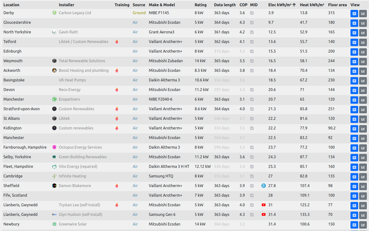

I’ve added kWh/m2 electric and heat stats, here’s systems in the 365 days of data view:
- We have 1 passivhaus achieving below the 15 kWh/m2.year target, nice!
- Glyn and I with our small solid stone terraced houses have very high per m2 consumption and near the bottom of the list 😀 kWh per person anyone? 😂

Is there a quick/easy way to filter out zeros?
Also, be a good idea to define what “floor area m2” is recommended, try to achieve some consistency. Main three are:
- GIA (gross internal area)
- NIA (net internal area)
- TFA (passive house specific version of NIA)
I’m not sure what most (MCS) heat-loss calcs use?

Can you share how exactly are those two measurements calculated? Is that just the total electric / heat energy over the last year divided by floor area?
**Post date:** [27 February 2024 16:54 UTC](https://community.openenergymonitor.org/t/heatpumpmonitor-february-update/25605/34 "2024-02-27T16:54:32Z")
> [@Andre\_K](#):
Yes that’s correct.

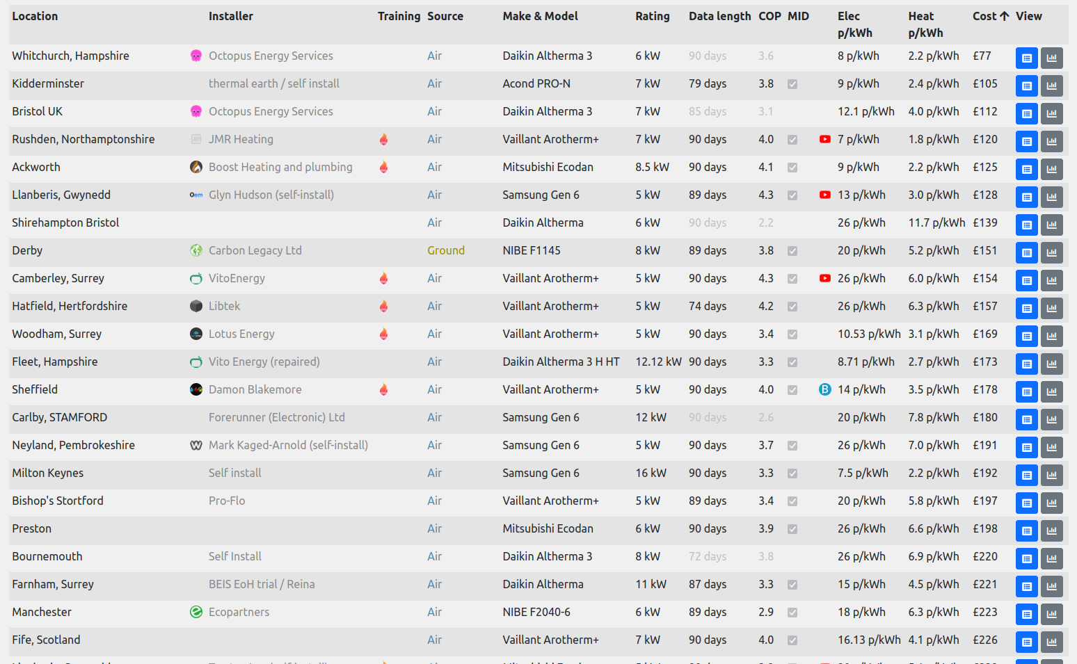

I’ve added in post processed total cost of electric and unit rate of heat options (available from the field selector for now):

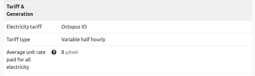

These are currently calculated based on the value entered in the average unit rate paid for all electricity field. I appreciate there are quite a few issues with this input, e.g it will quickly become out of date, it will likely not include cost of enabling technologies e.g battery storage. With that caveat in mind, it’s at least an initial implementation of what this could look like.
 ![image](https://community.openenergymonitor.org/uploads/default/original/3X/b/8/b8451ef45d65b1b68b39f47d73fe9d4bfb0d912c.png)
If no unit price is provided it will currently default to 26 p/kWh, this could be a selectable option in future…

> [@TrystanLea](#):
That would be mine… 😊
I’m not convinced the last 365 days have been properly representative of the design conditions (i.e. it’s been a warm winter) but it’s pleasing result - especially since my house runs at 21C rather than the 20C assumed for Passivhaus certification.
