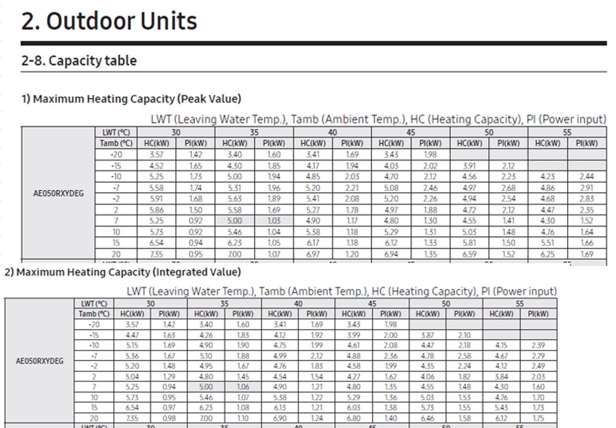

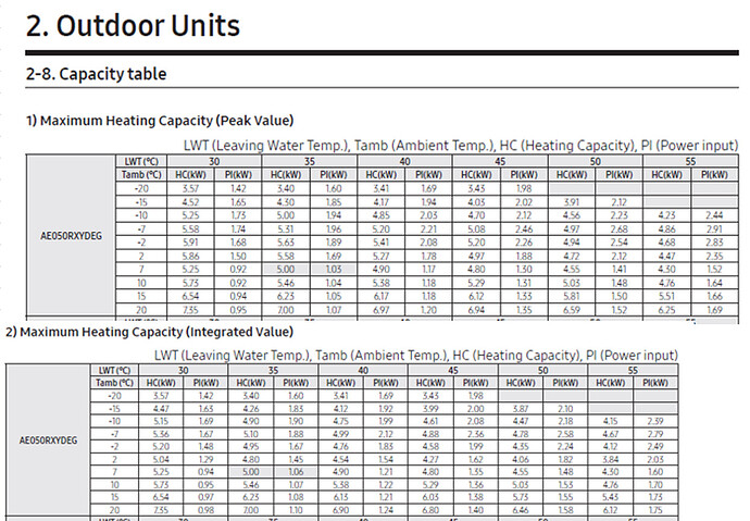

**Preparation: What information to look for about your heat pump**
For heat pumps tables similar to the one below are published with their technical information. It states for a number of combinations of ambient temperature and leaving water temperature the following data:
-Supplied heat at high load
-Consumed electricity at high load
If you divide supplied heat by consumed electricity you get the COP at that load point.
Supplied values by Samsung for example are both “peak” values and “integrated” values. Peak are values without defrost and integrated are values with defrost cycles included.
_Note on SCOP vs COP: SCOP is a value determined by combining a lot of the tests from the table below with specific weighing factors and not workable to benchmark in a real field installation. So if you want to benchmark anything verifyable you do so based on the tables below or similar info for the specific heat pump you have._
 ![image](https://community.openenergymonitor.org/uploads/default/original/3X/4/2/42cd596b1c1ea030e92f1de65e1a0fb04d8e53bb.jpeg)
_Power consumption and supplied heat of a Samsung AE050RXYDEG Heat Pump (Samsung EHS Technical Data Book)_

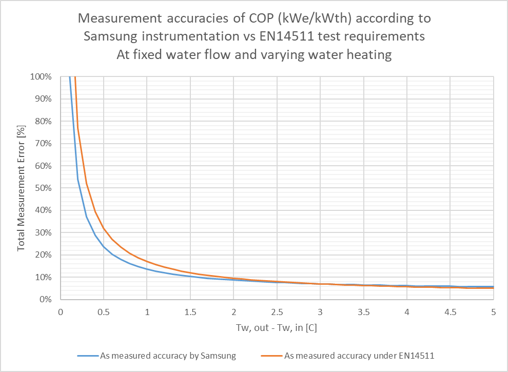

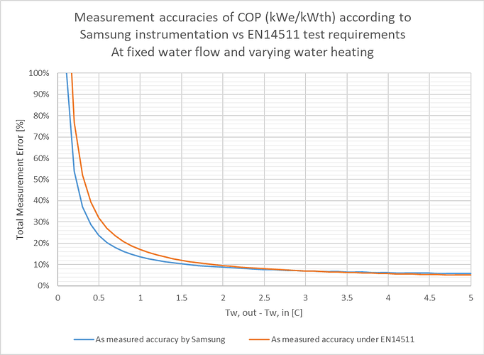

**Testing measurement accuracy**
EN14511 specifies a number of sensor accuracies which I am not going to cite all but the following are most important for air-water heat pumps:
-Air temperature: within a few tenths of a degree
-Water temperature: Within 0.15 C
-Water temperature increase: Within 0.15 C
-Consumed electric power: Within 1%
-Water flow rate: Within 1%
Below is my interpretation of the required accuracy during the EN14511 tests compared to my intepretation of the accuracy I have been able to find for the instrumentation on my Samsung heat pump. I presumed full water flow at all part loads (which is the case for my setup as my pump is not PWM controlled). Then plotted both accuracies as a function of temperature increase. These line of Samsung also includes inaccuracy due to rounding off the measured values to 0.1C.
In my view the measurement requirements during the EN14511 tests are not exotic compared to the instrumentation that came with the heat pump. Power consumption accuracy is also comparable to fairly standard 3phase modbus power meter on sale for about €100,-.

2. You refer to the Samsung EHS Technical Data Book. In the version for the Mono Quiet series, I see that Section 2-9 has 4 capacity tables (two labelled “Peak Value” and two labelled “Integrated Value”, but all four are identical. Even those headed “Integrated Value” bear the legend “…tested **without** defrost operation in accordance with EN14511” (my emphasis) 🤔.
3. It may be worth distinguishing between the results of the **type** tests that Samsung perform in the lab to EN14511 (presumably this requires a minimum number of sample units) and those you get on your installed heat pump (which will be subject to the usual manufacturing tolerances, so may vary +/- on performance). Some devices - like safety valves - require manufacturers to apply a derating factor to account for this, but (unless EN14511 says otherwise) I very much doubt whether heat pump vendors are required to.
4. Neither the Data Book, nor Samsung Tech Helpdesk, tell us what compressor speed was used for preparation of the capacity charts, or even if it was held constant in their preparation. (I wonder whether EN 14511 requires this?) Neither do they tell us how the capacity/power figures vary with compressor speed. I assume that they aren’t required to, so they don’t. Whatever, the cynic in me believes that they tweak their design for best efficiency at 7degC ambient, 35degC LWT - the universal comparison point - for marketing purposes.
5. The numbers in the table do not vary smoothly between columns and rows as one would expect, so can at best be used as a rough guide.

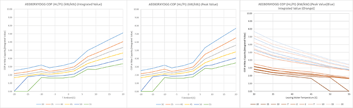

Find my Excel table with AE080RXYD\*G performance data below.
The first sketch was a snapshot of that data from the EHS technical handbook.
To me it shows up just fine…on my phone as well as the laptop I posted on so I don’t see what I can solve on this right now. Anyway find more below, I hope the pictures show up better.
That handbook is too big to upload here and this forum does not support uploading Excel files.
Below some more elaborated data: Left 2 graphs are COP per water outlet temperature as a function of ambient temperature. Somehow defrosts only played a significant role for the COP at high water outlet temperatures. Below -15 C no wet bulb ambient temperature is specified which you can also see below in the tables resulting in zero difference between figures for the lowest outdoor temperatures.

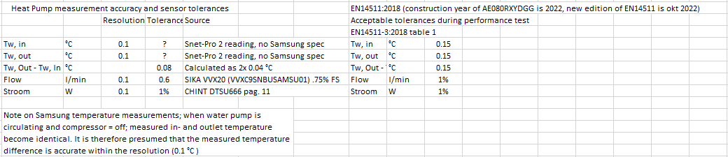

On your remark 6:
The table below shows my comparison between what my Samsung has actually installed and EN14511 requirements. In my opinion the accuracies are fairly similar.
Biggest point of discussion could be the water flow meter. But the water flow meter supplied is a VVXC9 meter by SIKA with quick-fasten connection (and therefore a decent straight in- and outflow length thanks to the straight pipe spools supplied with that sensor)

BTW many thanks for your responses. The only point I would add (to my comment 5.) is that in my EHS Technical Data Book, there are two places that refer to operating performance.
- The Specification (Table 2-1) gives what I would call the official (definitive) performance figures at the normal comparison point of 7/35 plus a small number of alternative reference points (7/40, 7/47, 2/35, -7/35). If I was wanting to make a warranty claim then I would probably make these my basis.
- The data in the Table 2-9 capacity tables I would regard as indicative only. They are claimed to be derived using Eurovent rating standard OM-3-2015 (not EN14511) and valid only over a limited range of water deltaT (i.e. LWT - RWT). But when I look at OM-3-2015 it has only limited relevance to A2W heat pumps - it’s really written around air conditioners and worries about things like primary-to-secondary air leakage and pressure drops (nothing at all about accuracy of test equipment as far as I can see). In other words, these data are at best useful for comparison with one’s own observations, but hardly fit for a warranty claim.

I had the original post sent to NEN to validate if what I was about to post here could be legally posted. Apparently copying the mail and pasting it back here did that to the images.
I took out the pictures, went back to Excel and pasted them back in straight from Excel. Are they visible now?

@glyn.hudson Are you referring to the supplied heat and consumed electricity as displayed on the wired remote control for your figures? I don’t really trust those either.
What I do is I take a log file generated using SNetPro2 taking the onboard readings for temperature in/out, ambient and water flow. I combine that with the consumed electricity measured with a CHINT DTSU666 electricity meter (connected via Modbus) to my PLC.
Then both logs are combined into 1 file where I can do my analyses. I usually make scatter plots of instantaneous heat delivered vs instantaneous heat supplied on top of taking some longer time averages. In my opinion that should have the accuracy I plotted in the bottom graph of my opening post.
Yes, that’s what lots of us do to calculate generated energy, but (I think I recall) the LWT and RWT sensors are only taped to the inlet/outlet pipework (don’t know whether HT cement is used) so may be +/-0.5degC at best , so if the actual deltaT is only 2degC that could introduce a **big** error as @glyn.hudson suggests.
I believe that the WRC gets its energy generated/consumed data from NASA 0x4427 and 0x8414 respectively (totals since installation) by recording their values at beginning and end of the month (for instance) and calculating the differences. The instantaneous values are available at 0x4426 and 0x8413, but SNET doesn’t display these (though NASAmonitor does - see [Samsung ASHPs: Review of NASAmonitor – an Alternative to SNET-Pro2](https://community.openenergymonitor.org/t/samsung-ashps-review-of-nasamonitor-an-alternative-to-snet-pro2/29495)). You _can_ get 0x8413 into the SNET display (see [Samsung ASHPs: Customising Your SNET-Pro2 Display](https://community.openenergymonitor.org/t/samsung-ashps-customising-your-snet-pro2-display/29280)) but not 0x4426. The NASA messages 0x4426/7 are based on pure water as the circulation fluid, but happily (if you have glycol up to about 30vol%) the density increase and sp ht decrease cancel one another almost exactly, giving a net error in reported energy generated of less that 0.5%. If you _do_ use the above “instantaneous” NASA messages, be aware that these data only arrive at F1/F2 every minute or two (fine for CoP calcs if averaged over a few refreshes as NASAmonitor does).

Yes, correct. The readings on the controller are using the same sensors inside the heat pump. The error will be present irrespective of how you’re logging the readings. I took my readings via Modbus, but the result will be the same.
To be accurate the temperature sensors need to be a calibrated pair in direct contact with the water flow inserted inside the pipe. This is what heat meters use to achieve class 2 MID accuracy.

Well so far I have not had any occasion where the in- and outlet temperature of the water did not converge to exactly the same value if only the circulation pump was running…
So the individual values may be off but I do expect the difference between the 2 to be accurate within the 0.1C ballpark.
On my heat pump that is…
