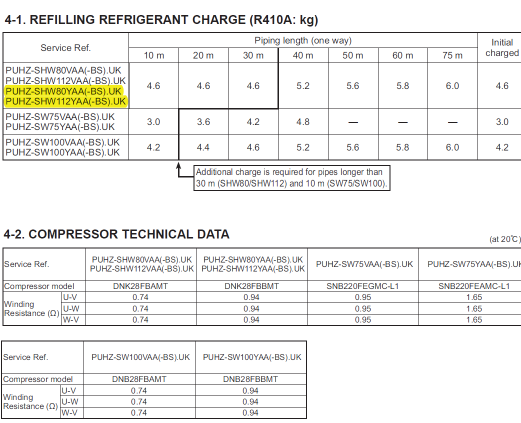

Hi I have [PUHZ-SHW80YAA.UK](http://PUHZ-SHW80YAA.UK) can it be modified to [PUHZ-SHW112YAA.UK](http://PUHZ-SHW112YAA.UK)
 ![Hvataj](https://community.openenergymonitor.org/uploads/default/original/3X/d/f/dff08e11093f2b3b0c3b4d8ffd102d3047c93be8.png)
 ![1Hvataj](https://community.openenergymonitor.org/uploads/default/original/3X/a/1/a1b5b06930fe10149a68d13e67b65a70cd0fedd5.png)
 ![2Hvataj](https://community.openenergymonitor.org/uploads/default/original/3X/0/d/0dea0fdccbf8077de79de06208f1f928fa7da431.png)
 ![3Hvataj](https://community.openenergymonitor.org/uploads/default/original/3X/3/2/32367cffe0c4b52d959d3a17f12b337400743ce1.png)

**Post date:** [7 January 2025 11:49 UTC](https://community.openenergymonitor.org/t/heat-pump-size-as-a-soft-setting/27609/10 "2025-01-07T11:49:04Z")
Sure looks like it (even refrigerant amount is the same), maybe @gregory75 source can confirm this model as well

**Post date:** [7 January 2025 13:16 UTC](https://community.openenergymonitor.org/t/heat-pump-size-as-a-soft-setting/27609/12 "2025-01-07T13:16:22Z")
It sure looks like it ticks all the boxes. Turn DS 5 to OFF and DS 6 to ON and you got yourself a 112YAA. They are identical. And I cannot call “the guy” whenever someone want to do a free upgrade. He has a life and a job.
So this is how it went: he told me to read the manual. He didn’t advice me to do it so he ends up in sh\*t if something goes wrong. He left the decision solely to me after i documented my self.
Then I asked myself: am I brave enough to try it? Sure as hell I am, i’m a curious guy, there’s no progress without trying.
Next question: Can I afford 5000 euros if something goes wrong? Meh. But the curiosity won.
So ask yourself these questions, the decision is YOURS and YOURS ONLY. Sure I can express my opinion (i think it’s the only thing that’s still free as of today). But don’t trust me, trust yourself!
Should you try this upgrade now during the cold season? I advice against it. If something goes wrong you gonna live with your parents again. I did it during the summer.
DO THIS ON YOUR OWN RISK!
