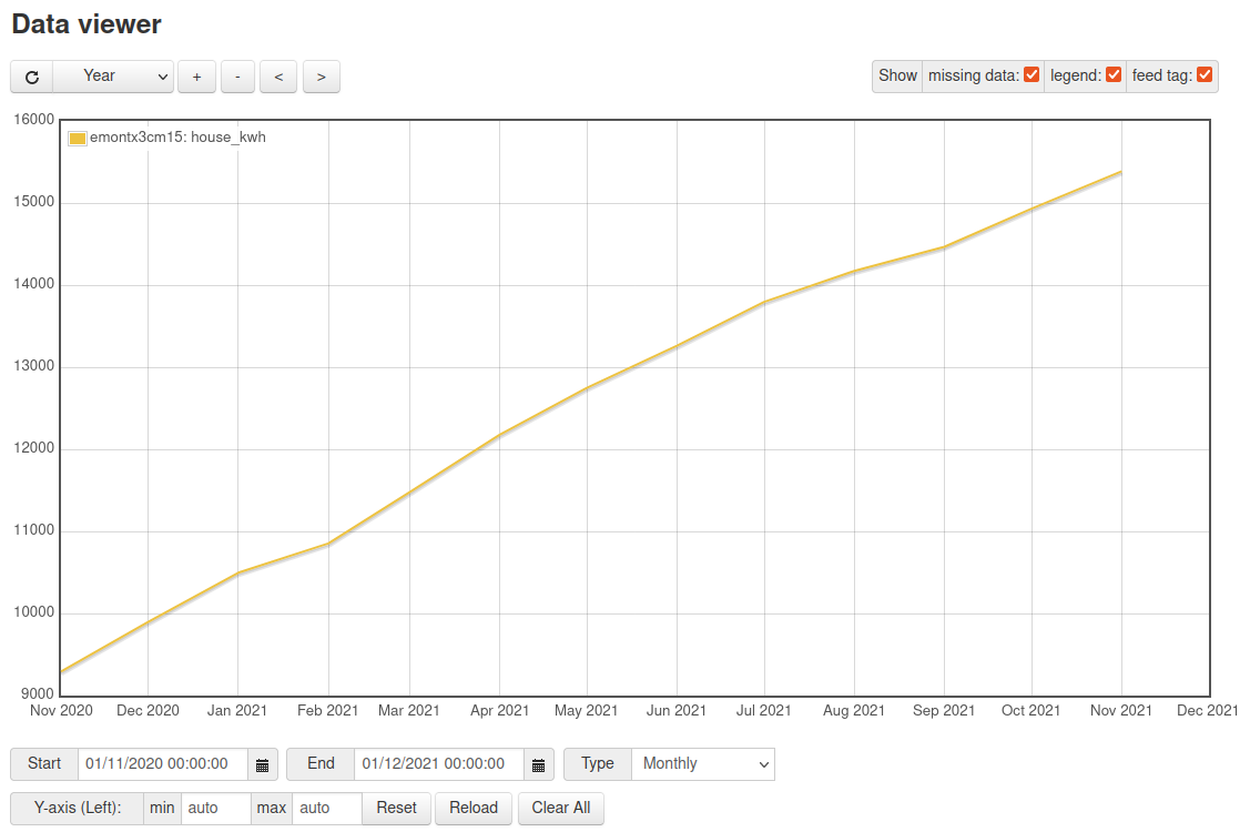

**Post date:** [21 November 2021 20:24 UTC](https://community.openenergymonitor.org/t/graph-display-question/18840/24 "2021-11-21T20:24:28Z")
Ok, it doesnt seem to be a difference between the branches, stable is working fine for me as well.
Here’s a screenshot:
 ![image](https://community.openenergymonitor.org/uploads/default/original/3X/f/b/fbb8a41417513a3793263dcaafe3f1d0650ff6aa.png)
**Post date:** [21 November 2021 20:26 UTC](https://community.openenergymonitor.org/t/graph-display-question/18840/25 "2021-11-21T20:26:51Z")
The current month November is missing and that is expected within the graph view (as it requires a different calculation). But you should see October.
What feed engine is your kWh data stored as? is it PHPFina?

**Post date:** [21 November 2021 20:44 UTC](https://community.openenergymonitor.org/t/graph-display-question/18840/26 "2021-11-21T20:44:52Z")
Hi Tristan I can say that the current month was visible on v9, some change along the time made it not display the current month.
Why would you not display it if you have the data available anyway?
