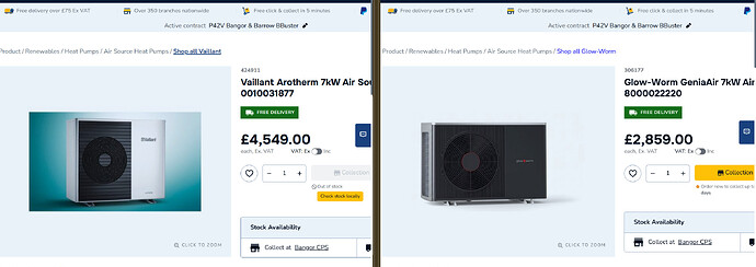

Anyone have any viewpoint on this unit? Installer was/is due to fit a vaillant, and has ordered one but due to backlogs at vaillant there is a chance it may not arrive in time. He’s trying to see if one of these could be available but obviously not guaranteed. Can’t find a huge amount on it as just launched in June apparently…
Looks like it’s a rebadged Vaillant Arotherm Pro, which would make sense, as Glowworm is a subsidiary of Vaillant.

Yes, I believe it’s identical to a Vaillant Arothem+, just rebadged
Vaillant only requires a resistor to enable cooling. Glow-worm will be the same since it’s the same unit. The glow-worm cooling resistor is listed in the brochure, part number: 001000974 https://www.glow-worm.co.uk/glow-worm/products-1/controls/glow-worm-independent-brochure-uk-final-010925-digital-hr-spreads-3061617.pdf
There’s a significant price difference! I guess it shows how much of a mark-up, Vaillant is making. Glow worm seems like a bargain

Does Vaillant give larger rewards to installers and trade discount than Glowworm?
