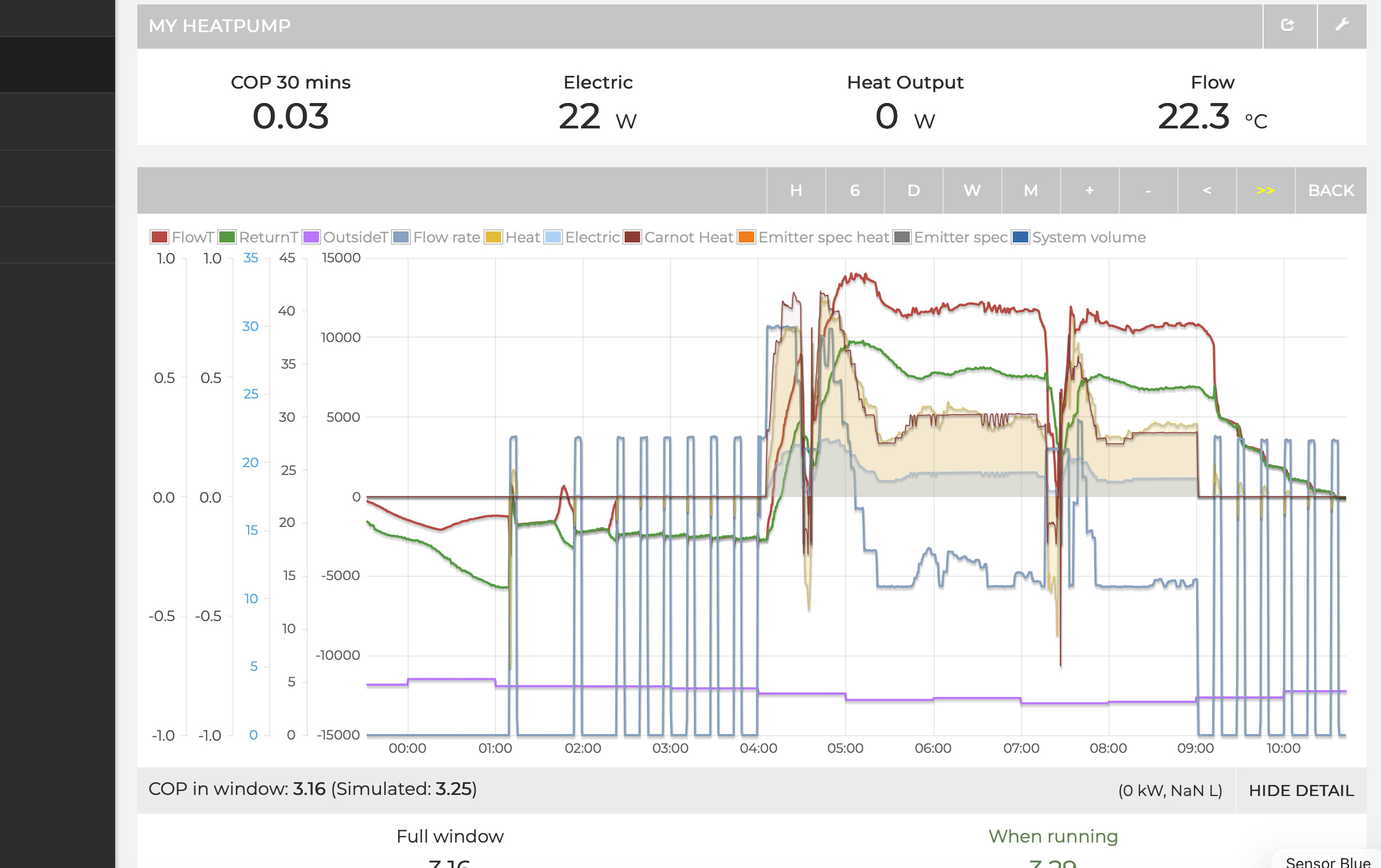

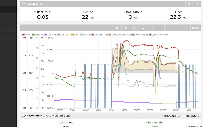

Looking at my data the flow rate appears to be all over the place. Looking at the first screenshot the flow rate is very low even when the HP is working. When HP not running the flow rate is up and down like a yo-yo. Checking Daikin data the flow rate should be 15 -21l/m with 21l/m recommended for radiators. Any thoughts what is happening and possible remedies to get a steady higher flow rate

The yo-yo look like you have the Pump operation mode set for Sample rather than request or the pump is running anti freezing cycles if temp is lower than 5 degrees
Thanks for that. I assume I find Pump operation in the installer’s menu?

looking at grath I suspect system is running anti free when HP is not on as it’s cold

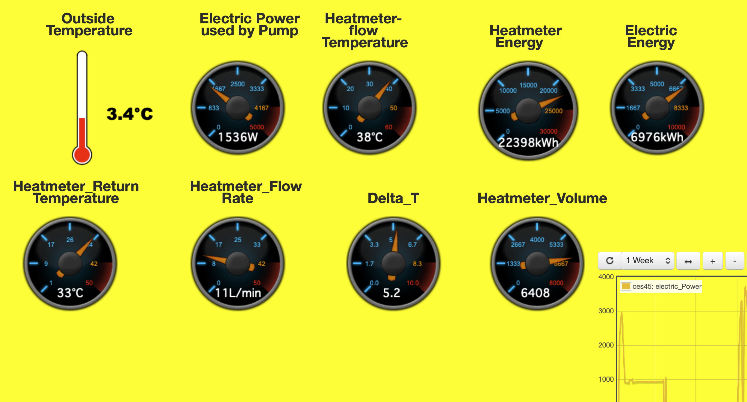

I have Emoncms heat pump monitor with flow meter to provide information.
Definitely seeing people with <9kW HP’s getting more stable results. You have the same number of radiators and living room temperature as myself, what electric power are you using? This cold weather I am over 1kW and unable to reduce.

Ok , must be cycling on anti freeze Protection then
