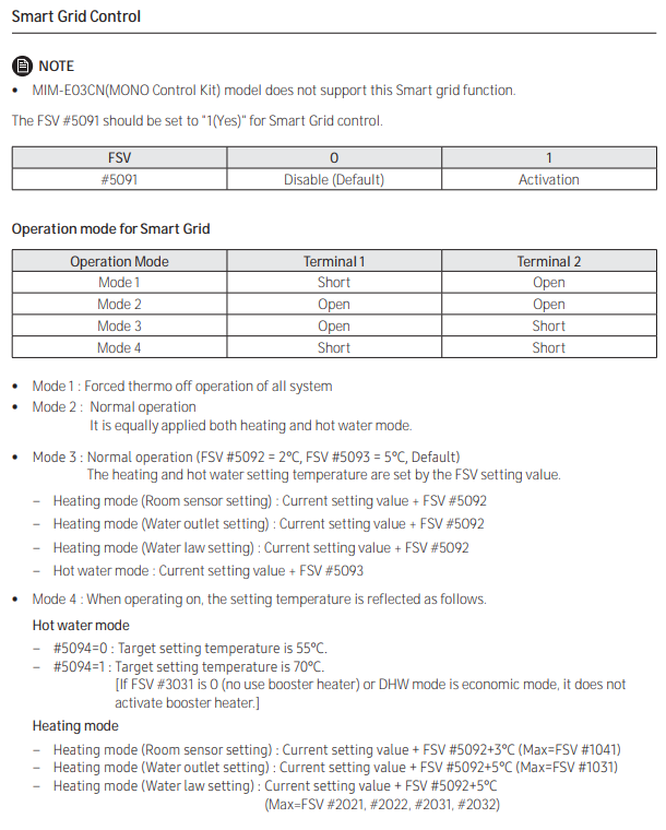

An alternative method is to use AUTO & Water Outlet temperature mode, instead of Indoor Temperature mode. Which uses pure weather compensation, and ignores the indoor thermostat completely.
This alone, doesn’t work well with TOU tariffs as you cannot schedule increases or decreases in the WC curve (though you can adjust it manually on the MIM), but you could make use of the Smart Grid feature, which raises the target outlet temperature in 2 steps (see image below of manual). This can be controlled externally with smart relays wired into the controller. For this, you need MIM-E03EN or MIM-E03FN, not MIM-E03CN)
