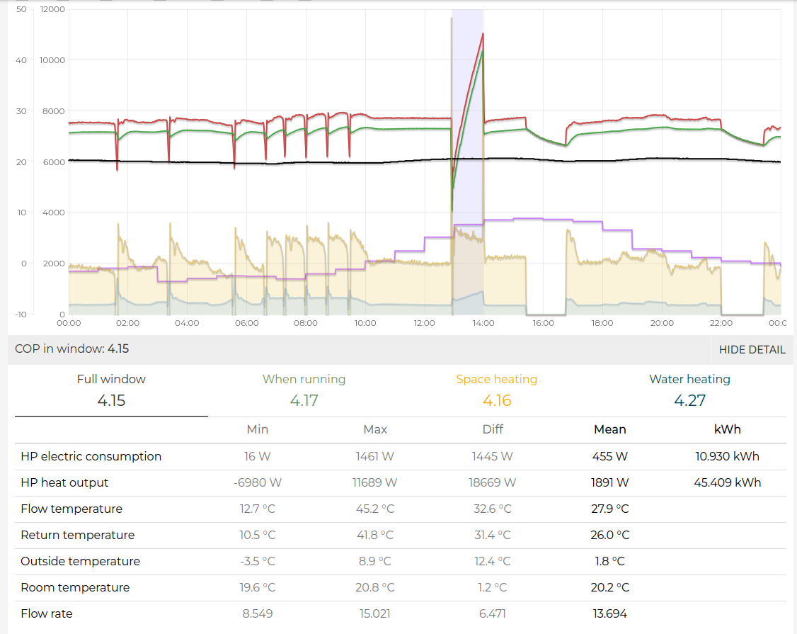

On the landing page of EmonCMS there is a filter for All / When Running / Space Heating / Water Heating. Can this filter be implemented on the detailed view so the averages are more meaningful? I’m interested in average flow temperature for space heating (to compare with the MCS performance estimate table) but can’t see a way of checking this as it’s not visible on the landing page but on the detailed view the maximum flow temperature is during DHW cycles and the average will include times when the heat pump is not running bringing the average down, and averages out all flow temperatures whether for space or water heating.
Hello Simon, if you see those options on the daily view they should also show on the detailed view as well, click on ‘Show detail’ to open the stats section:
Example: Emoncms - app view
When running:
Hot water only:
You may also be interested in the analysis here: Low flow temperature = High performance — OpenEnergyMonitor 0.0.1 documentation
Perfect! Sorry TrystanLea didn’t realise they were selectable. Thanks for the quick reply :blush:
