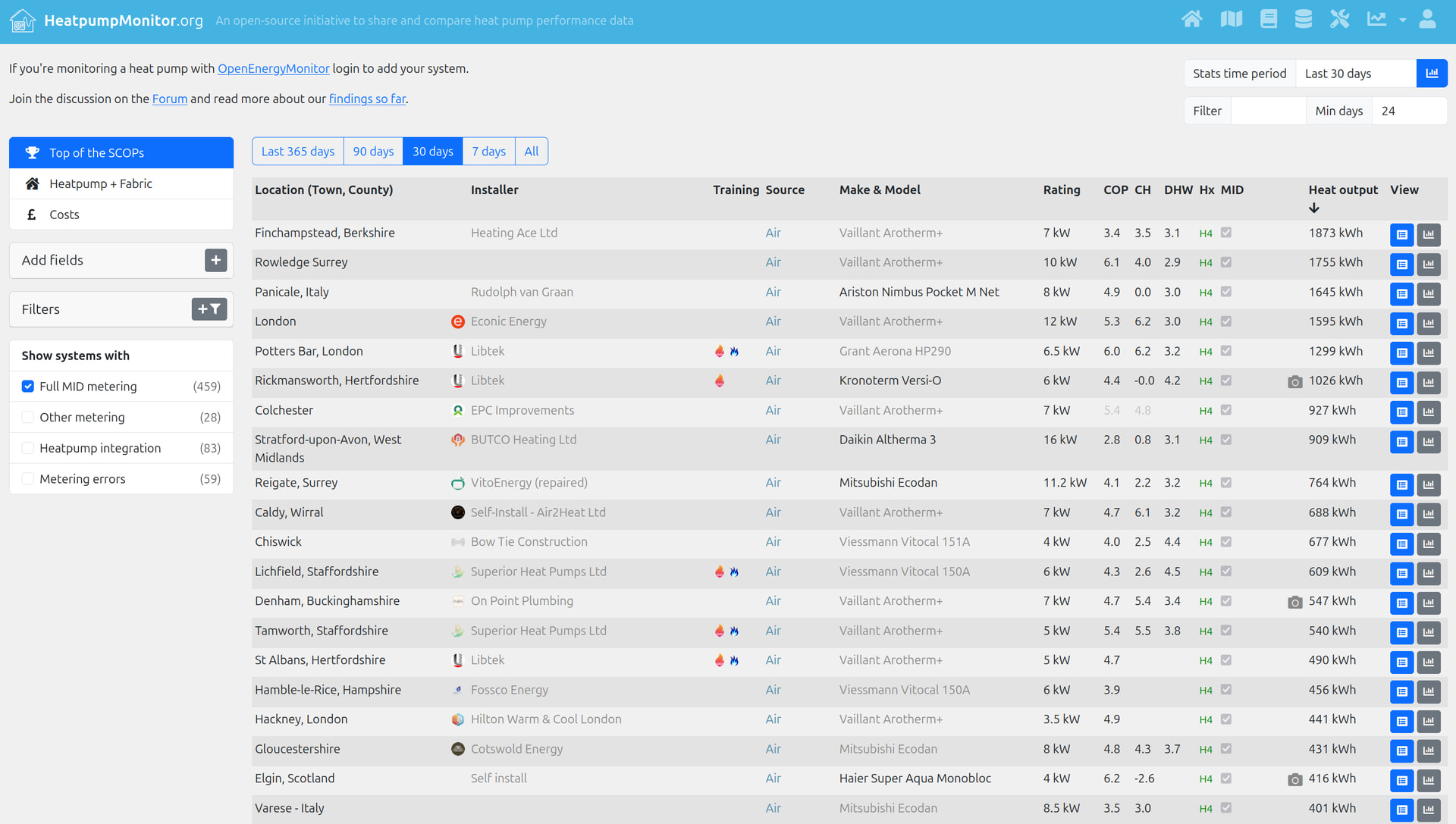

There are quite a few good examples of using air 2 water for cooling on [HeatpumpMonitor.org](http://HeatpumpMonitor.org) but little in the way of contextual information about how the cooling is being achieved e.g fan coils or floor slab cooling? and how condensation is being managed?
We would like to do some social media posts about this aspect of the monitoring, if you are cooling with your system on [HeatpumpMonitor.org](http://HeatpumpMonitor.org) and are happy to feature your system would you be able to add more information to the notes section about how you are achieving active cooling and managing condensation risk?
### List of systems engaged in active cooling with info on rads/ufh/fan coils: [https://heatpumpmonitor.org/?add=cooling\_heat\_kwh,cooling\_cop,new\_radiators,old\_radiators,fan\_coil\_radiators,UFH&minDays=10&period=last30&filter=query:cooling\_heat\_kwh:100:gt:t](https://heatpumpmonitor.org/?add=cooling_heat_kwh,cooling_cop,new_radiators,old_radiators,fan_coil_radiators,UFH&minDays=10&period=last30&filter=query:cooling_heat_kwh:100:gt:t)

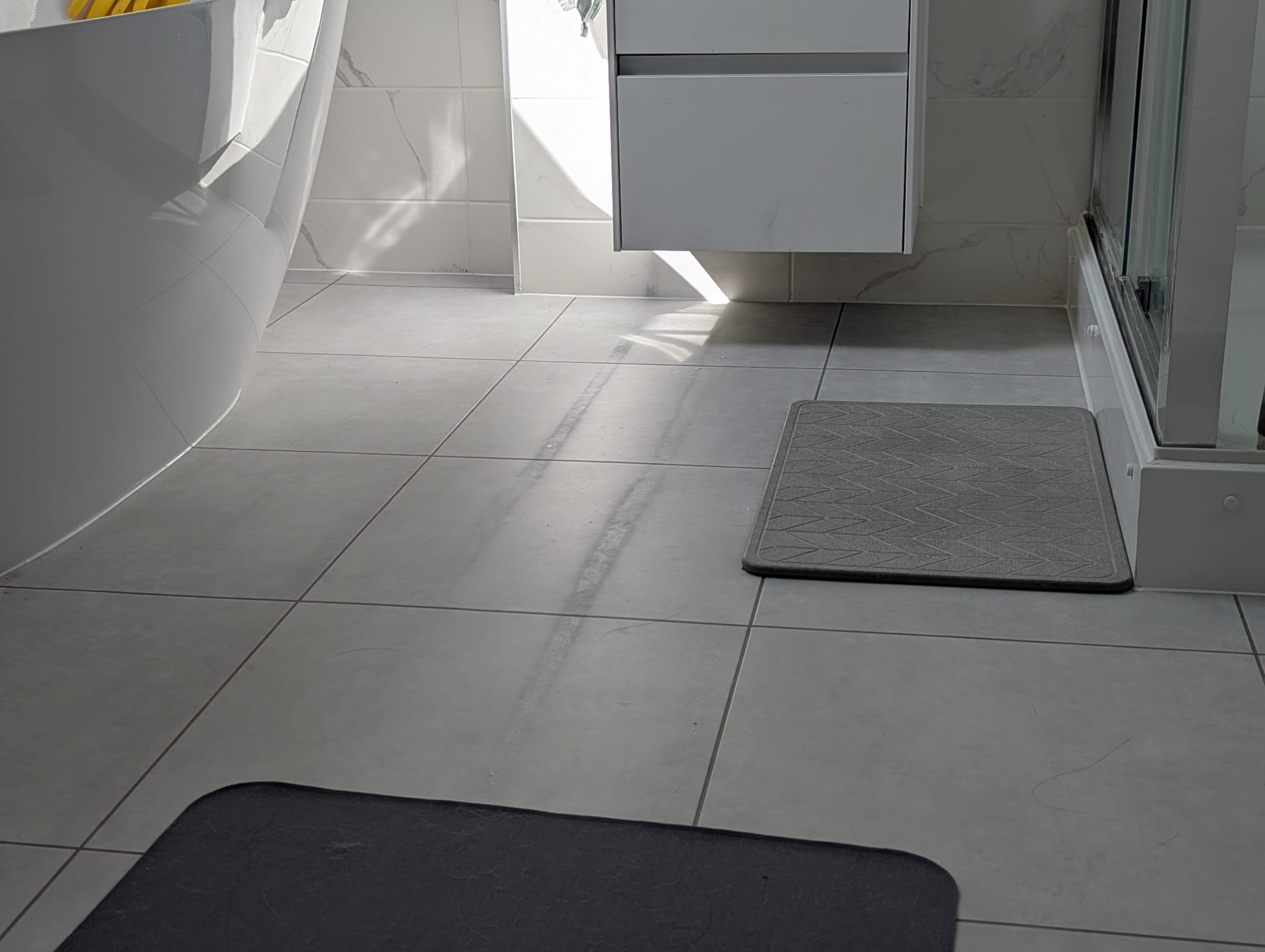

 ![WhatsApp Image 2026-06-24 at 16.17.53](https://community.openenergymonitor.org/uploads/default/original/3X/d/e/de37271cebd4a8ed44402842c99591e5eacdf51f.jpeg)

- No external shading
- Blackout curtains almost always closed, especially when the sun is on that side of the house (roughly east-west)
- Honeycomb blinds on ground floor west-facing french doors, kept 80% closed. You can absolutely feel the difference in the glass temp where the blinds are reflecting the heat back out.
- Top floor has 3 Veluxes
  - One is in the bathroom and has no blinds to avoid moisture buildup. This is the hottest part of the house after the loft. Tried opening this window and hoping for some convection up, but made no difference if I kept the doors shut (didn’t want to open the doors to spread the heat around).
  - Two are in master bedroom, blackout blinds
- New build 2025, so current NHBC insulation standards. Whole house is triple glazed (not 100% sure about the Veluxes). Windows all kept closed, some with night vent open. All trickle vents left open.
- Last heatwave, kept windows closed at night too as nighttime temp was still too warm. Current nighttime temps are much cooler, so will open at night and try to remember to close them again in the morning

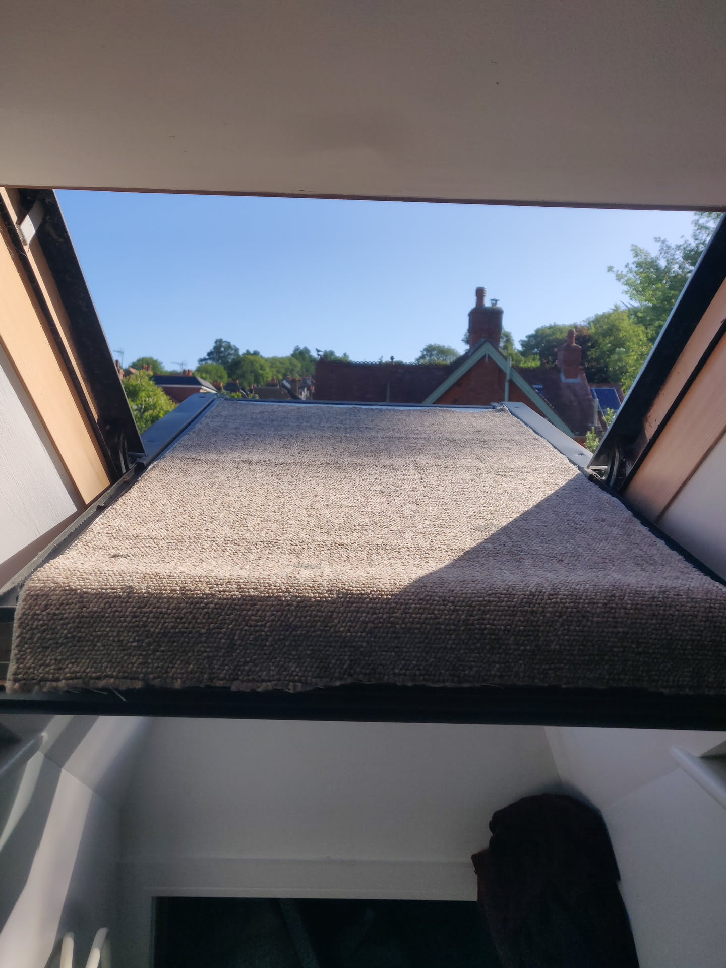

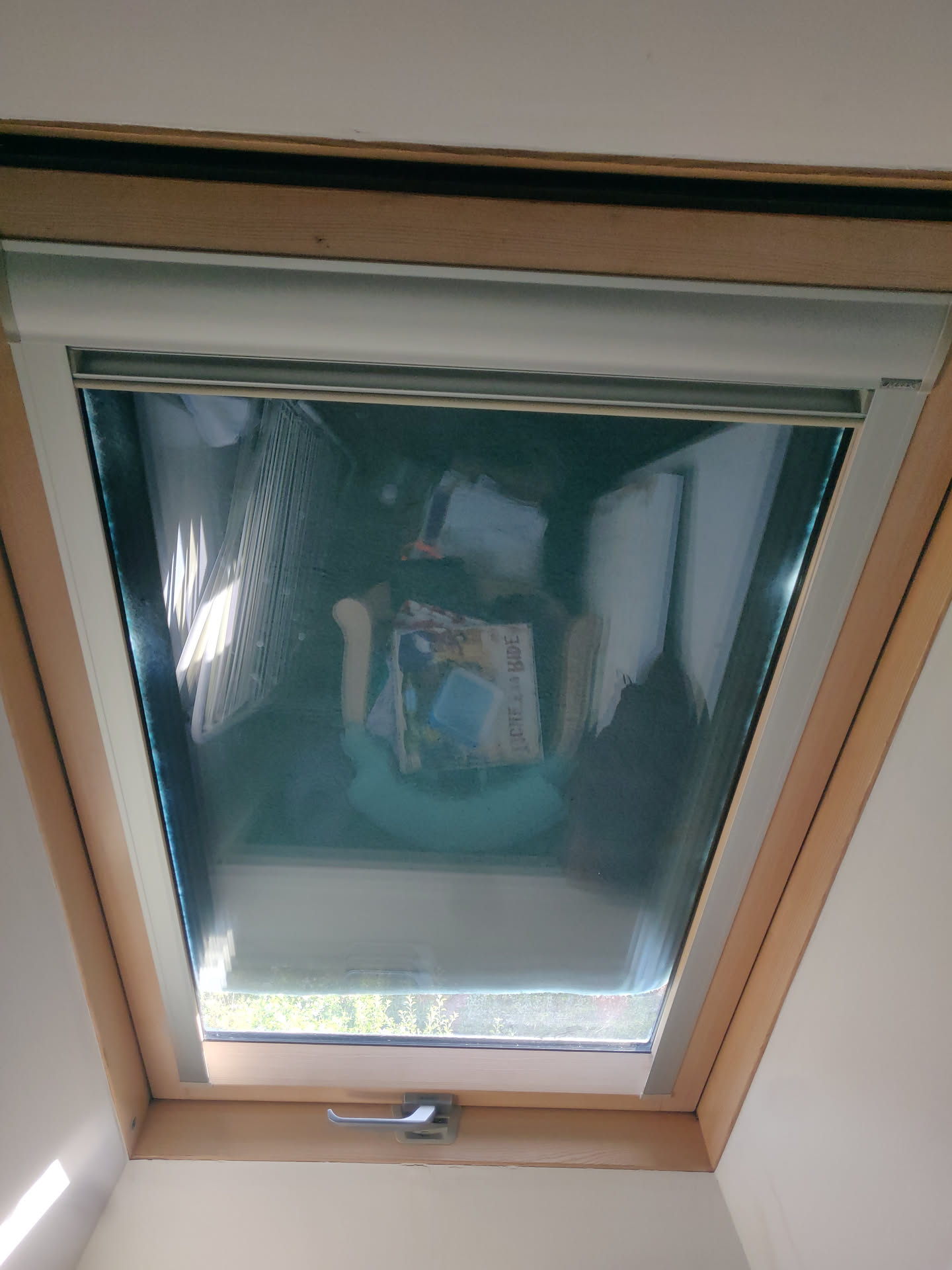

**Author:** ![tim](https://community.openenergymonitor.org/user_avatar/community.openenergymonitor.org/tim/32/3875_2.png) [@tim](https://community.openenergymonitor.org/u/tim)\
**Post date:** [9 July 2026 06:20 UTC](https://community.openenergymonitor.org/t/examples-of-air-to-water-cooling-on-heatpumpmonitor-org-help-needed/30141/10 "2026-07-09T06:20:12Z")
> [@horaceli](#):
This is my Velux hack (other roof window brands are available - mine are Fakro triple glazed). It’s a carpet scrap. This makes a huge difference (way better than just the internal blackout blind).
 ![2026-06-29-08-28-19-301_preview](https://community.openenergymonitor.org/uploads/default/original/3X/b/2/b2fd32dce44ec00b129cb8b55cfbbe6933a74e98.jpeg)
 ![2026-06-29-08-35-15-316_preview](https://community.openenergymonitor.org/uploads/default/original/3X/1/5/15e14fdff8a57fed11c1ba7791ffcca6e02ed0d8.jpeg)
The commercial alternatives to these are also pretty cheap (although with the latest Velux design you do lose a bit of winter thermal performance when they’re fitted - I’ve previously fitted this brand to some Velux: [Store extérieur anti-chaleur fenêtre VELUX | AvosDim.com](https://avosdim.com/store-pare-soleil-anti-chaleur-compatible-fenetre-velux.html) Unfortunately they no longer sell direct to Britain since Brexit, but might be good thing to pickup if you go to the mainland (other brands are of course available, including Velux and Fakro own-brands - they’re usually described as “external awning blinds” or similar).

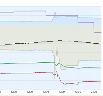

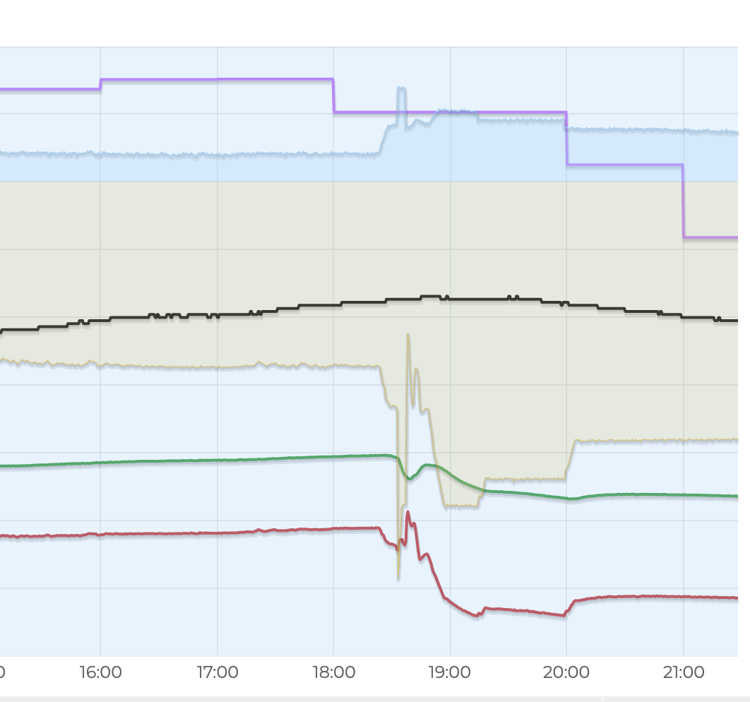

**Author:** ![horaceli](https://community.openenergymonitor.org/user_avatar/community.openenergymonitor.org/horaceli/32/37780_2.png) [@horaceli](https://community.openenergymonitor.org/u/horaceli)\
**Post date:** [9 July 2026 22:17 UTC](https://community.openenergymonitor.org/t/examples-of-air-to-water-cooling-on-heatpumpmonitor-org-help-needed/30141/19 "2026-07-09T22:17:29Z")
The downside of three floors is the big temp difference between ground and top floor, so even when the house is average 23C, top floor could be 25C+ and ground floor 21C. I want the top floor to be cool enough for sleeping in the evening, so that means forcing the entire house to be as cool as possible.
Yesterday early evening, I moved the target temp from 18C to 16C - dT went from 2.4K (19-16.6C) to 3.4K (17.8-14.4C) - cooling output went from 2.7kW to 3.8kW. Not great for COP (elec went 430W to 800W), but great for cooling.
 ![image](https://community.openenergymonitor.org/uploads/default/original/3X/e/3/e367cd194834e9ec9641cb8311a07c1e6abf6f62.png)
If it weren’t for my Amtico, I’d love to get close to a target temp of 14C like @Johnmo
