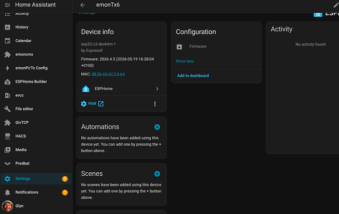

Interesting, I’ve still not able to restore the sensor entries for me emonTx6. I’ve tried everything I can think of. The ESPHome still looks like this:
 ![7a9ba503a51e8a451ffa0cc4777435b5ea354ce02690x436](https://community.openenergymonitor.org/uploads/default/original/3X/e/8/e87a9f969700be0d595eaec2bd09e9a2b45eeb32.png)
The emonTx6 WiFi module is working fine, I’m able to connect to it and see it posting data and reflash the ESP via OTA.

> [@borpin](#):
> `USE_SENSOR`
Is defined as soon as at least one sensor is defined in the yaml.
Anyway, I’ll make a double check..

**Post date:** [17 June 2026 12:39 UTC](https://community.openenergymonitor.org/t/esphome-emontx-component-sensors-missing/30061/29 "2026-06-17T12:39:50Z")
You don’t have any sensors defined?
> **[Example of Sensor Configuration - OpenEnergyMonitor EmonTx Sensors](https://esphome.io/components/sensor/emontx/#example-of-sensor-configuration)**
> Here is an example of how to configure the EmonTx sensors in your ESPHome YAML configuration: | Instructions for setting up OpenEnergyMonitor EmonTx energy monitors with ESPHome.

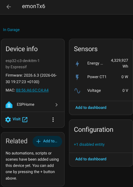

Your yaml does not define any `sensor`, that’s why you don’t see anything in HA and/or in the log.
**Post date:** [30 June 2026 18:34 UTC](https://community.openenergymonitor.org/t/esphome-emontx-component-sensors-missing/30061/31 "2026-06-30T18:34:07Z")
> [@FredM67](#):
Oh dear, I’ve no idea how the sensor section has disappeared. I’ve now added it back
```auto
sensor:
  - platform: emontx
    tag_name: "V1" # Use "V1"-"V3" for multi-phase; see Sensor Indexing for "Vrms" (single-phase)
  - platform: emontx
    tag_name: "P1"
  - platform: emontx
    tag_name: "E1"
 ![Screenshot From 2026-06-30 19-33-57](https://community.openenergymonitor.org/uploads/default/original/3X/2/a/2a7fa4e4ba273d79268603c4d558bd2eaa52a649.png)
It’s working again now! Very sorry for all this hassle 🫣
Thanks a lot for your help.
