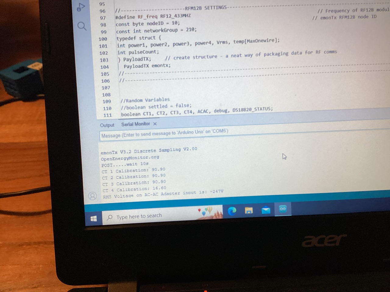

Well Robert, still want you to be an ex and a spurt, I have installed Arduino IDE downloaded the all the files and put into the libraries, uploaded a sketch tried to verify and compile but nothing starts to load but comes up with errors and tops with emonlib.h file not found, one wire file not found. I have renamed all files to take out any hyphens. I’m sure it’s easier to qualify as a heart surgeon that to get to grips with this. LOL
**Post date:** [26 October 2023 17:03 UTC](https://community.openenergymonitor.org/t/emontx3-and-wifi-esp8266/24546/22 "2023-10-26T17:03:13Z")
Did you shut down the Arduino IDE **completely** (all windows/instances) and it still shows “not found”?
Are all the libraries in a ‘libraries’ subdirectory of your sketchbook, as per the ‘Learn’ docs? , and have you told the Arduino IDE where your “shetchbook” directory is? Do the names of the library files now match the names in each `#include ...` in the sketch?

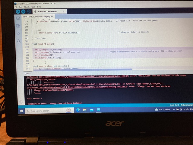

![IMG_0021](https://community.openenergymonitor.org/uploads/default/original/3X/0/4/04a4c33614960dd58cd2fc818d06ba0f0fe85a6e.jpeg)
Robert if you can read this attached picture, this is where I am at the moment. Realised the numbers are the line and place in the line where the error is but no idea what I need to edit too.
**Post date:** [26 October 2023 21:13 UTC](https://community.openenergymonitor.org/t/emontx3-and-wifi-esp8266/24546/24 "2023-10-26T21:13:33Z")
> [@Satwelsh](#):
Only with difficulty - a copy&paste of the whole list of errors into your post would have been the best.
The first worry is, can you confirm which hardware you have, it is an emonTx V3.4 or an emonTx V3.2?
And which RFM module is it, a RFM12B or an RFM69CW?
The first you can get by looking at the p.c.b; for the second you need to compare it with the photos here: [RFM12B & RFM69CW Wireless Transceiver Modules — OpenEnergyMonitor 0.0.1 documentation](https://docs.openenergymonitor.org/electricity-monitoring/networking/rfm12_69.html#)
The second worry is I couldn’t trace the sketch in Github (there’s no usable search for a filename) but fortunately, I found a private copy. So I know now what you’re looking at. The sketch is for an emonTx&nbsp;V3.2 using the RFµ328 processor module which in turn carries a RFM12B radio.
Is the screenshot the first error message? The error in line 385 suggests you probably don’t have the RFu\_jeelib library, or you don’t have it in the right place.
You should also set the board to Arduino Uno in the Arduino IDE.

It is tx3.2.1 with rfu328 with rfm12b 433mhz, so just trying to get back to a starting point so I know it’s a clean install then I can use the esp8266 to talk my emoncms.

Have you checked the location of the libraries?
[https://docs.openenergymonitor.org/electricity-monitoring/arduino-ide/index.html#using-the-arduino-ide](https://docs.openenergymonitor.org/electricity-monitoring/arduino-ide/index.html#using-the-arduino-ide)

I installed Arduino IDE which created a folder in “C” drive and I created a sketchbook folder within Arduino that contains a libraries folder with all the folders eg onewire, emonlib,rfu\_jeelib.
When I load a sketch and verify and compile that’s when I’m getting the errors and it terminates. It sees emonlib because it tells me the path it’s using but doesn’t list them like your example, unless I’m using the wrong sketch.
**Post date:** [26 October 2023 22:50 UTC](https://community.openenergymonitor.org/t/emontx3-and-wifi-esp8266/24546/28 "2023-10-26T22:50:04Z")
I don’t know Windows that well these days, but my thoughts turn to a permissions problem.
I’ve got Win 10 running inside a virtual machine, my Arduino executable is actually on a shared drive (E:\arduino-1.8.13-windows\arduino-1.8.13\arduino.exe as seen by Windows, from Ubuntu it’s /home/r/VirtualBox VMs/Win10-Shared/arduino-1.8.13-windows/arduino-1.8.13/arduino.exe)
and my sketchbook is at C:\Users\R\Documents\Arduino

If that folder is at the root of your C: drive, then I’d definitely be suspecting a permissions problem.
[Edit]
The Good (bad?) news is I’ve copied your sketch along with its directory (of course) into the ‘sketchbook’ in the VM and compiled it there with absolutely no changes.
N.B. The Arduino Shortcut “Start in” is set to the shared directory where the executable is. I have all permissions except Special

```plaintext
In file included from c:\Arduino IDE\Sketchbook\libraries\jeelib/JeeLib.h:18:0,

![IMG_0025](https://community.openenergymonitor.org/uploads/default/original/3X/6/4/643d58ee26a18e5223225dff5518e1ebba04ae08.jpeg)
This is what I get through serial connection but can’t enter config and don’t know if I can on this version.
**Post date:** [29 October 2023 22:48 UTC](https://community.openenergymonitor.org/t/emontx3-and-wifi-esp8266/24546/39 "2023-10-29T22:48:47Z")
No, there’s no on-line config on that sketch - it predates its introduction by a few years.
The radio message is sent in line 378. There’s no “switch” to turn it off (predates again), so comment out the line.
`send_rf_data();`

Robert Can you look at this sketch please and see where I have gone wrong, It compiles and uploads with no errors but not sure if i am still missing something. Emonesp still not connecting to tx3, I have 3 ct clamps connected but emoncms on inputs shows ct1 ct2 T0 freeram, srssi, psent, psuccess,
